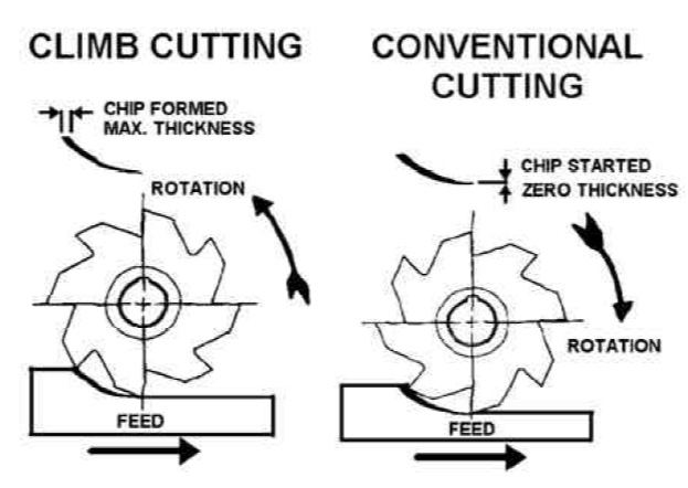

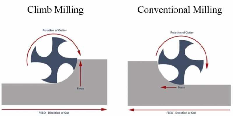

I have posted before about having an issue when I have a choice of two things. In this case direction.
Strangely if the choice is from 4 things I have less problem remembering.
Anyway I struggle like hell to remembering which way climb milling goes.
Does anyone have a good way to remember it (apart from a decent brain)
As an add in I am assuming that the first time I cut a slot I can not get away from.climb milling. (One of the sides) irrespective of which direction I travel.
