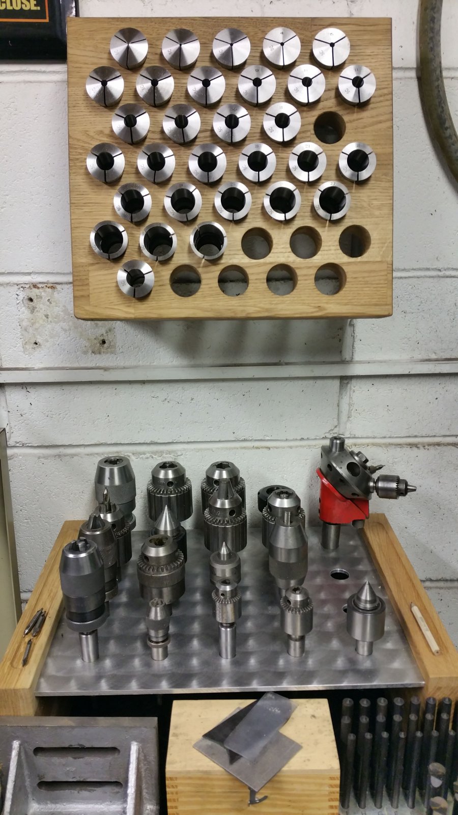

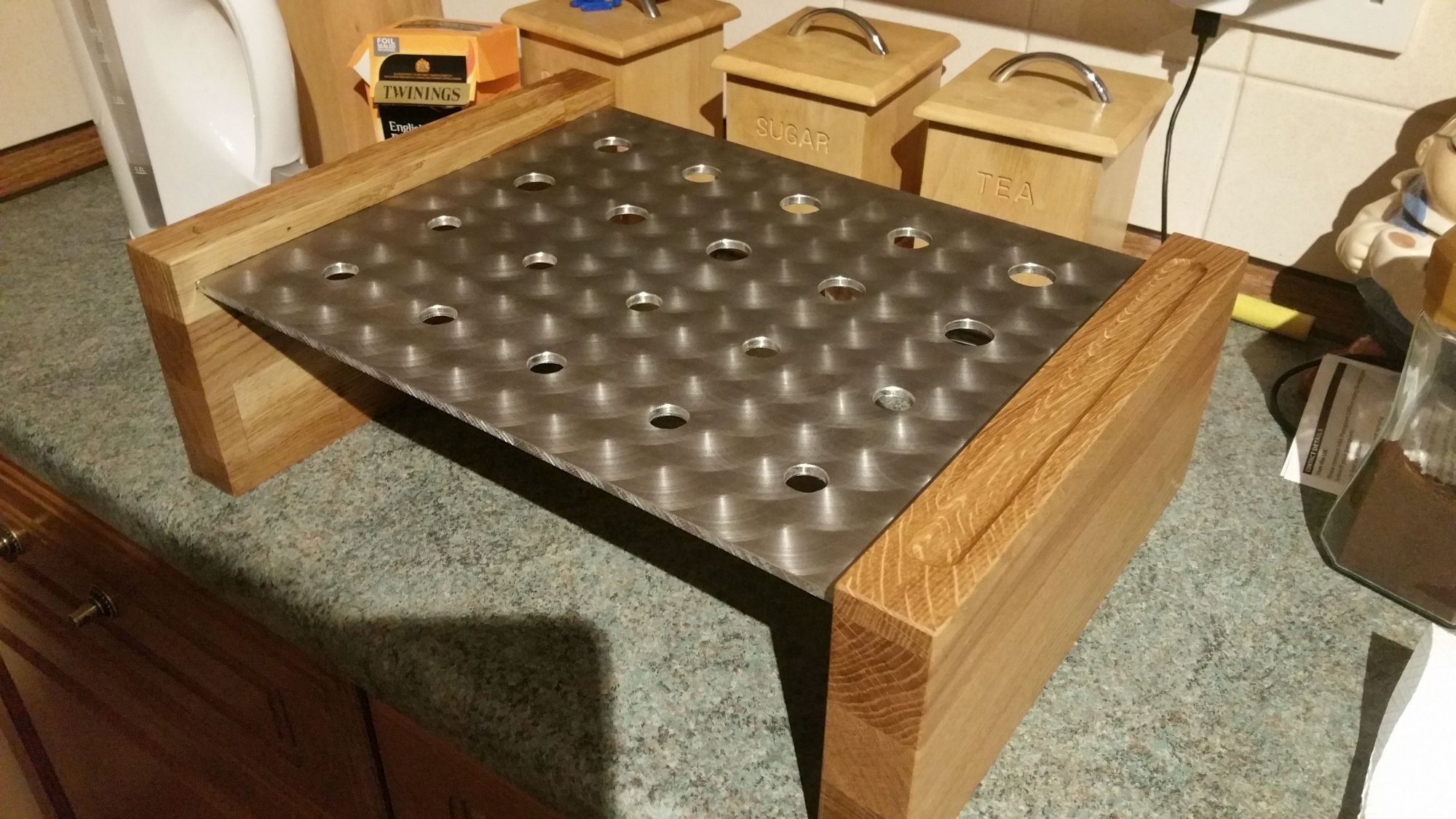

first time i've ever tried doing that. I don't know what they call it (burnished could be wrong) i did it with a sanding pad with some scotchbrite pad stuck on it overlapping each time i just fancied trying it and it came out quite well for my first atempt
i used the three inch off mini sander just stick scotchbrite to it and cut around it i only used two pieces. just be careful at the edges or it rips it off that's why i drilled the holes last

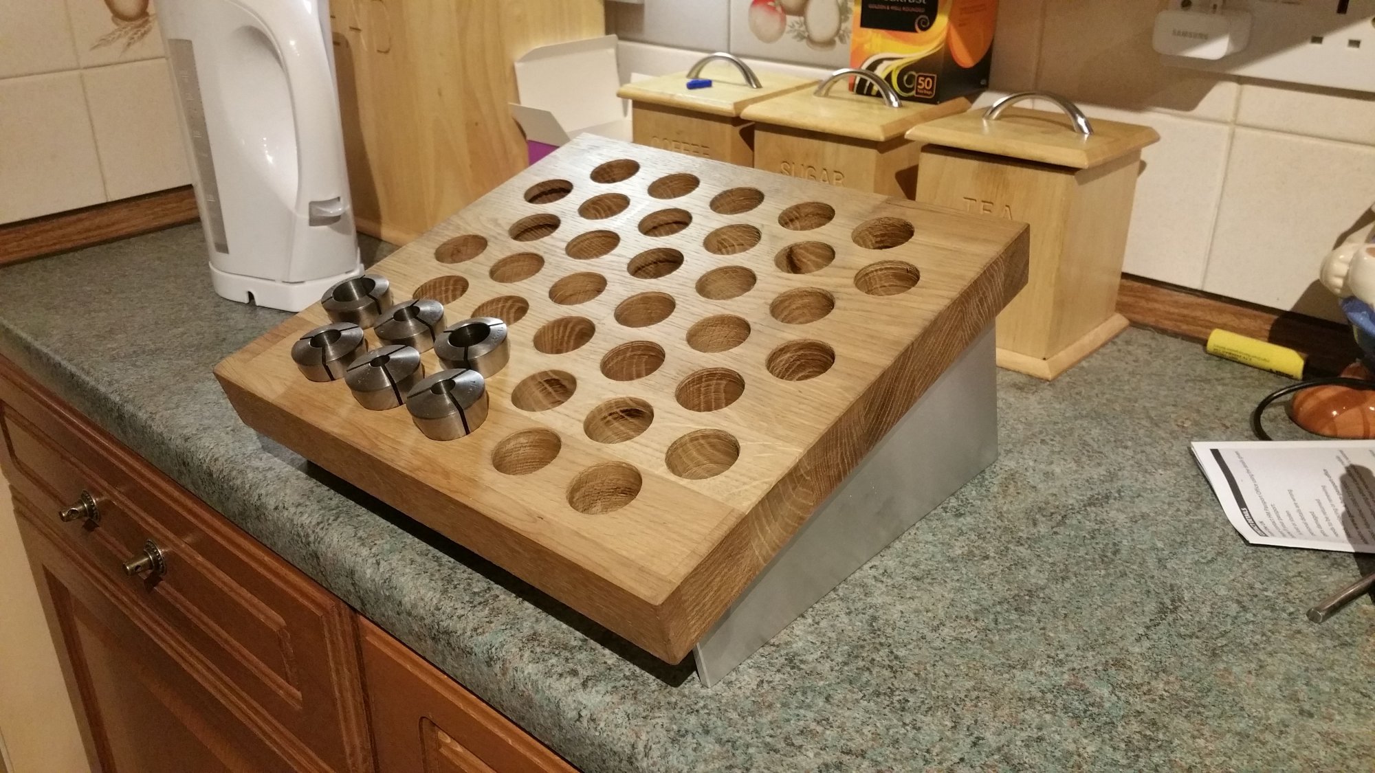

Is it easy to pick up the worktop offcuts?
Some bit's of that worktop would do to do with making a box for my ER32 collets.
