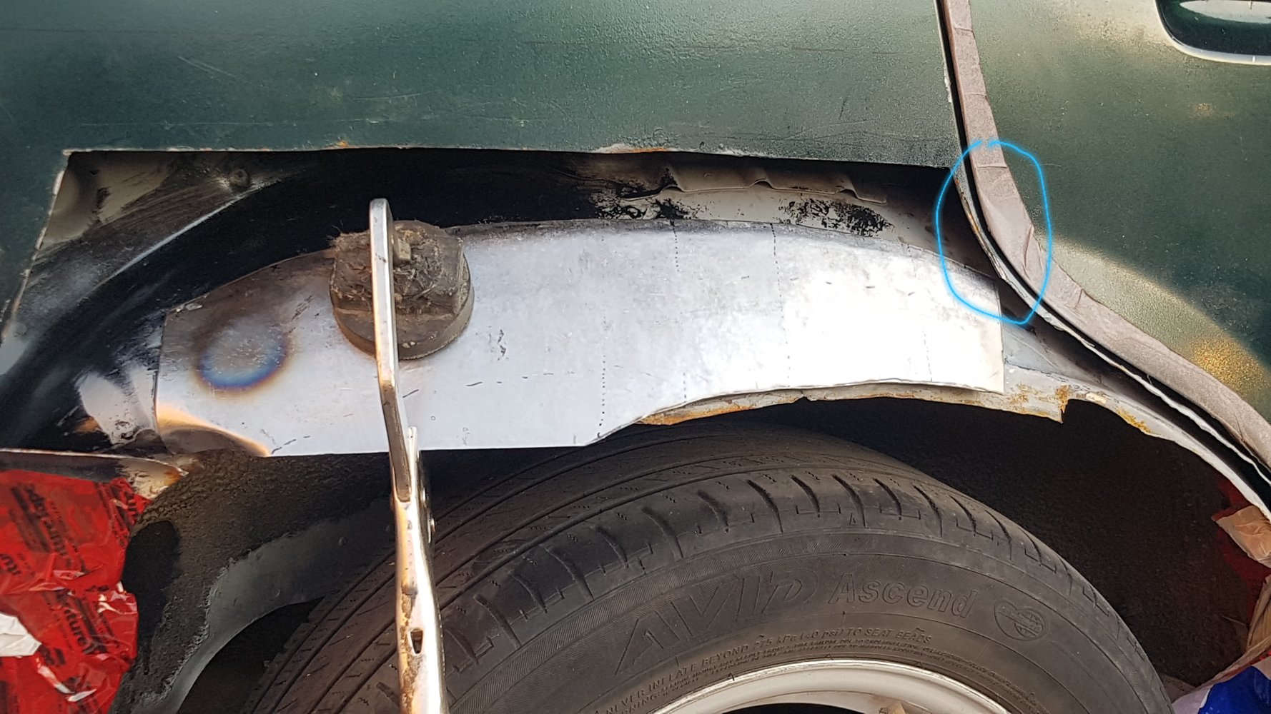

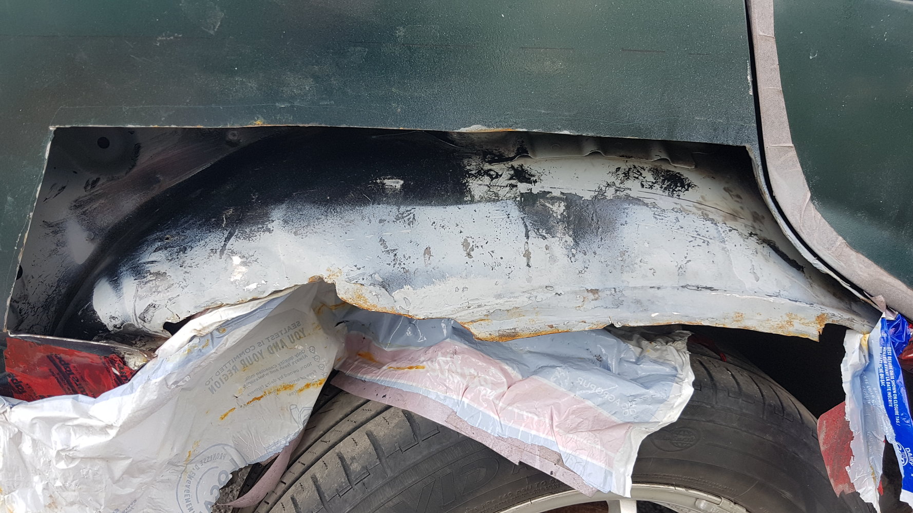

I am attempting to make a patch for the inner fender.
I managed to get the upper piece to fit relatively snug, as can be seen in the picture:

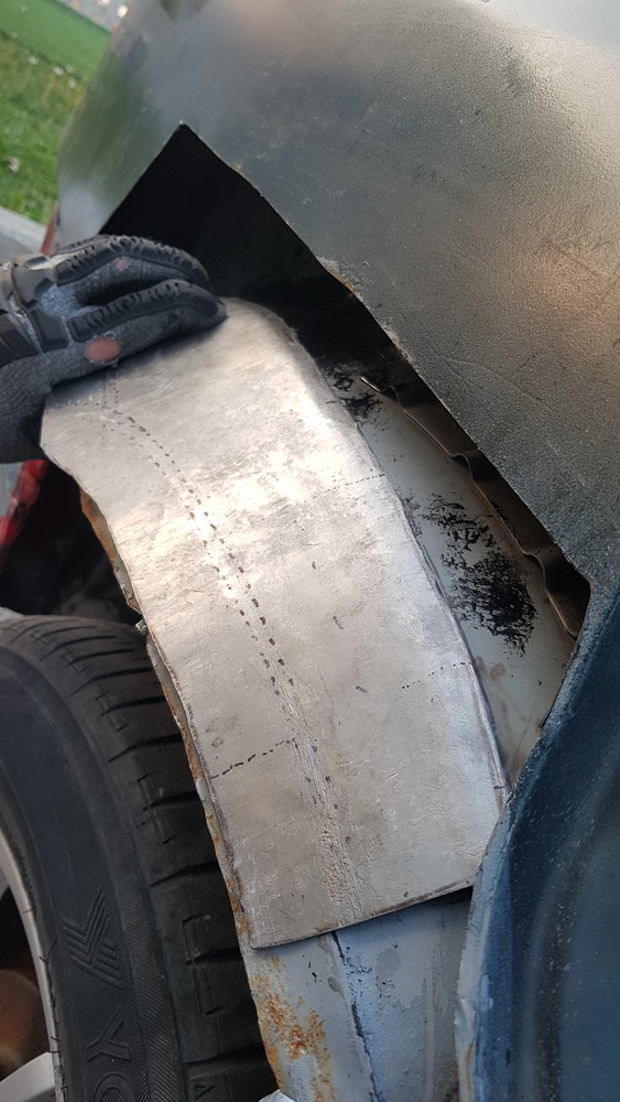

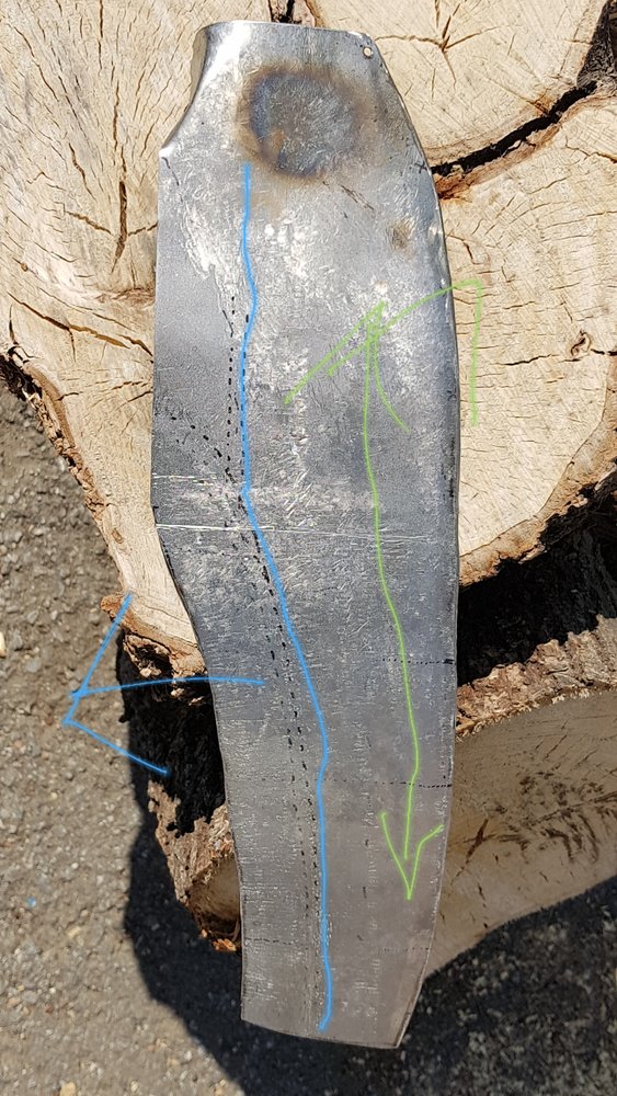

Here is a picture of the actual patch:
So how do I tip the blue curved area without distorting the already flush fitting bottom area ?
Should I overshrink the upper piece (Horizontal shown in green) a bit over first? and then it should come down after I tip the bottom area down?
What affect on the metal will tipping the curved area have on the upper area in in green?
BONUS points if you can tell me a decent discord for Autobody
I only have hand tools.
