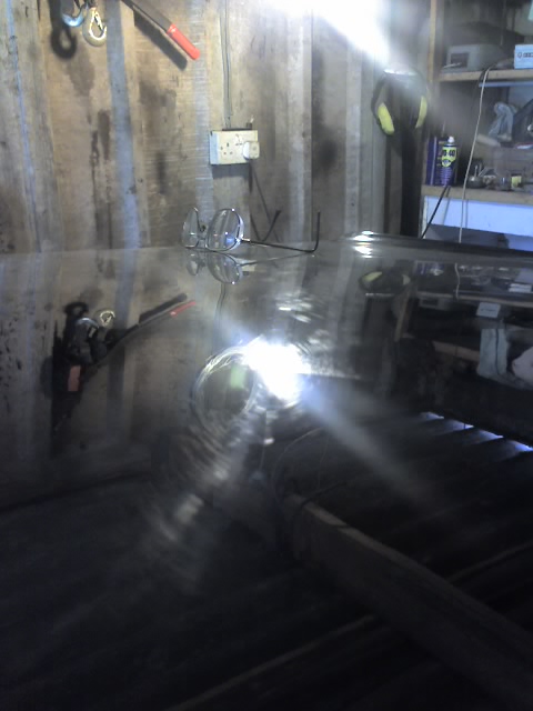

I'm trying to deal with an area of overspray on the car's roof.
Initially I rubbed it down with 1200 paper (wet) and polished it with Halford's Rubbing Compound. It came up not too badly, but there were a few scratches left so I thought I'd go over again with 1500 wet to improve it. Bad idea. There are now more scratches and it won't polish up at all.
I've tried the compound, T-cut, and even chrome polish! I'm hoping that the problem is that I'm now working on the original 5-year-old lacquer which must be harder that the overspray was.
Will G3 paste be more effective? Or a polishing machine?
All ideas welcome! Thanks Alex.
