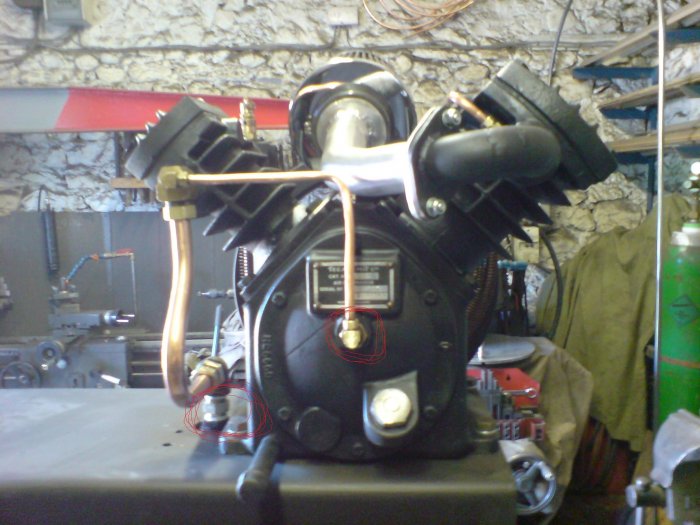

Hi guys,
The ever lasting battle between my Ingersoll Rand 242 upright compressor and I continues.
Having replaced most of the pipe work and a couple of fittings making everything fit where I need it to, and removing the welded together fittings the previous owner had installed, I'm still having a few issues.
The guage was broken and read around 3bar when completely empty, so ordered a new one from my compressor guy, and installed it. Ran the compressor for a couple of minutes to see if this would work, and hurrah the pressure read 0 and rose when turned on.
A few little air leaks on 1 or 2 joints mean't switching back off to sort these out as I'd not put enough PTFE on them. I then realised that there was an air leak coming from the drain valve on the bottom of the tank, so removed all this to check it out or replace it, and decided on replacing it, so its currently without one until my orders turn up.
Now, onto the minor issue I may have. When I turned the compressor off, there was no hiss as you would expect from an Unloader Valve, and when turned back on the motor span, but the piston pully didn't, so I now assume that the valve is at fault here?
Would this be a correct assumption at all? I have an order arriving tomorrow morning, and if I ring my compressor man before 8am, I can get one chucked on the van to save another trip or waiting.
All help appreciated, maybe I'll get to use the compressor for more than 15 minutes soon, but for now, I'll continue with the blasting cabinet buid I've got going on.
CHeers,
Steve
