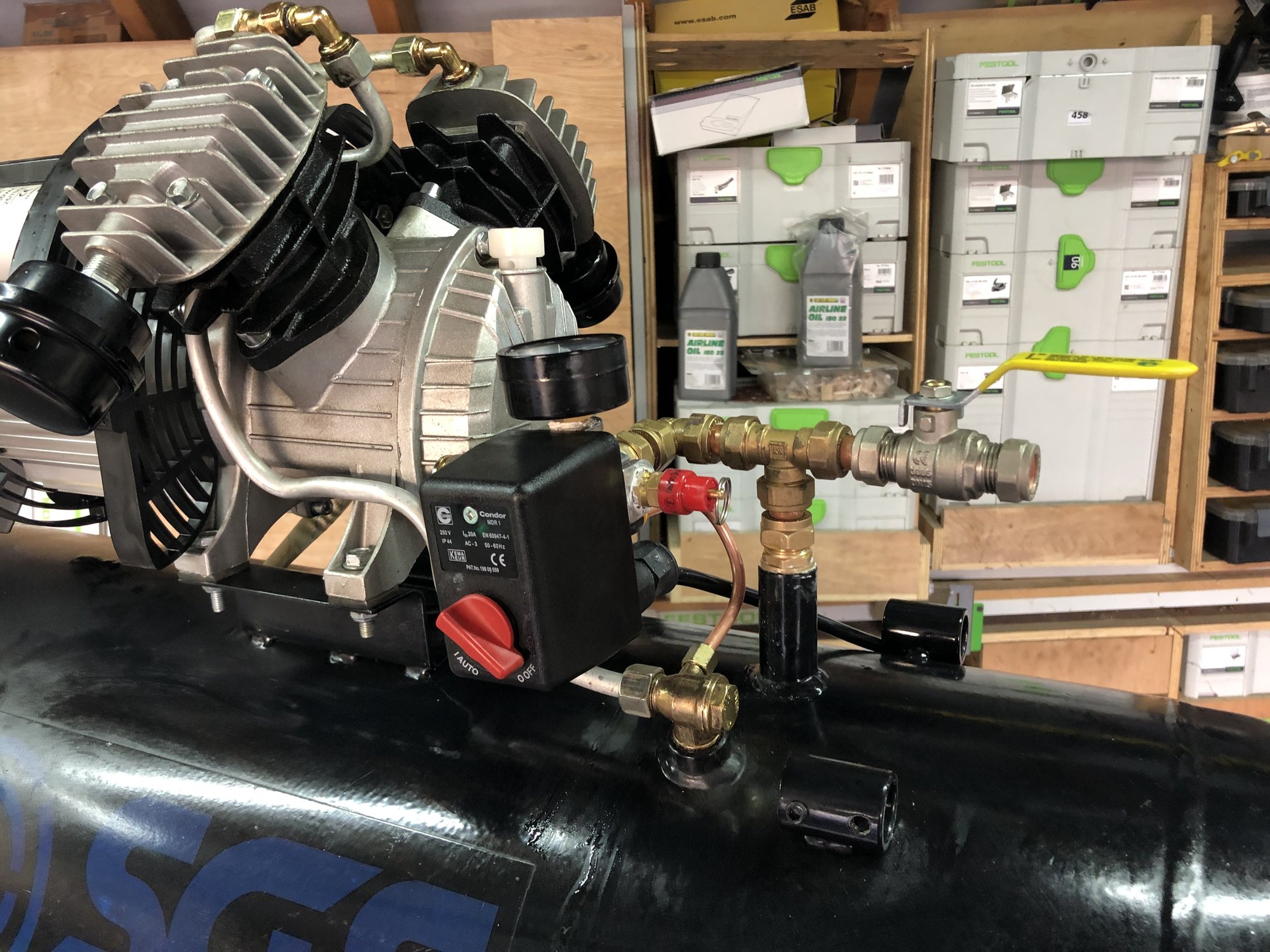

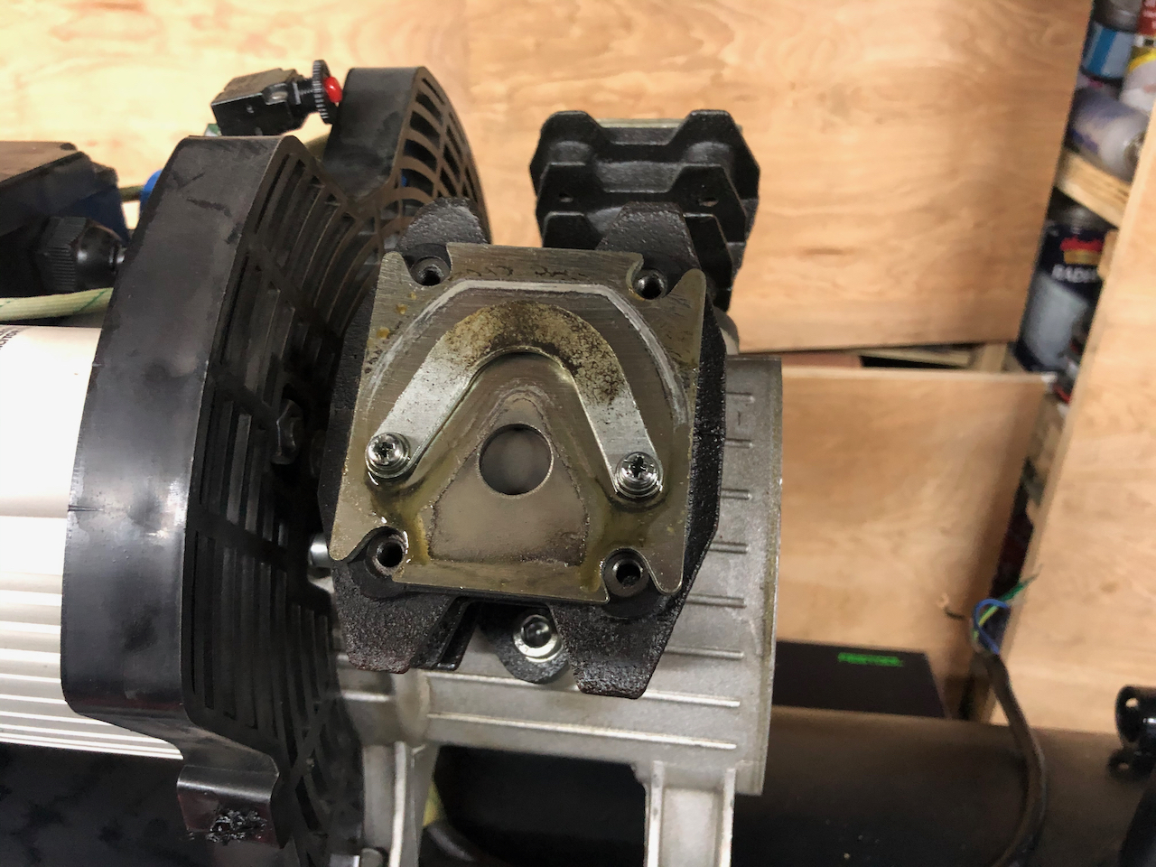

Sorting the place out before starting to strip my bandsaw down for restoration I decided to check the compressor as i noticed it was sounding slightly different. I have it up in the loft out the way, its a 4 year old SGS 14cmf unit with not much use.

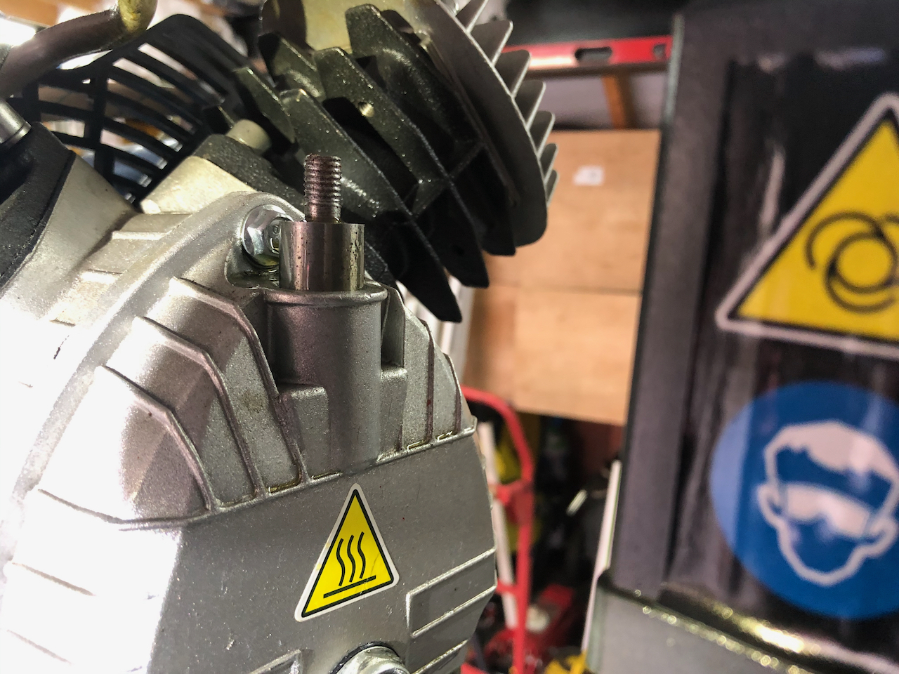

When i went up it was covered in oil as was all the roof above it and most of the surround stuff. Now, i think i know what's caused this - me I lost the plastic oil bung so just wedged a bit of aluminium in that happened to fit, this is still firmly wedged in place the oil seems to be coming from under the air intakes somewhere.
I know the oil bung is supposed to have a vent to relieve pressure and I'm thinking this pressure has caused the issue.
here's my sticking plaster that i think has caused this !

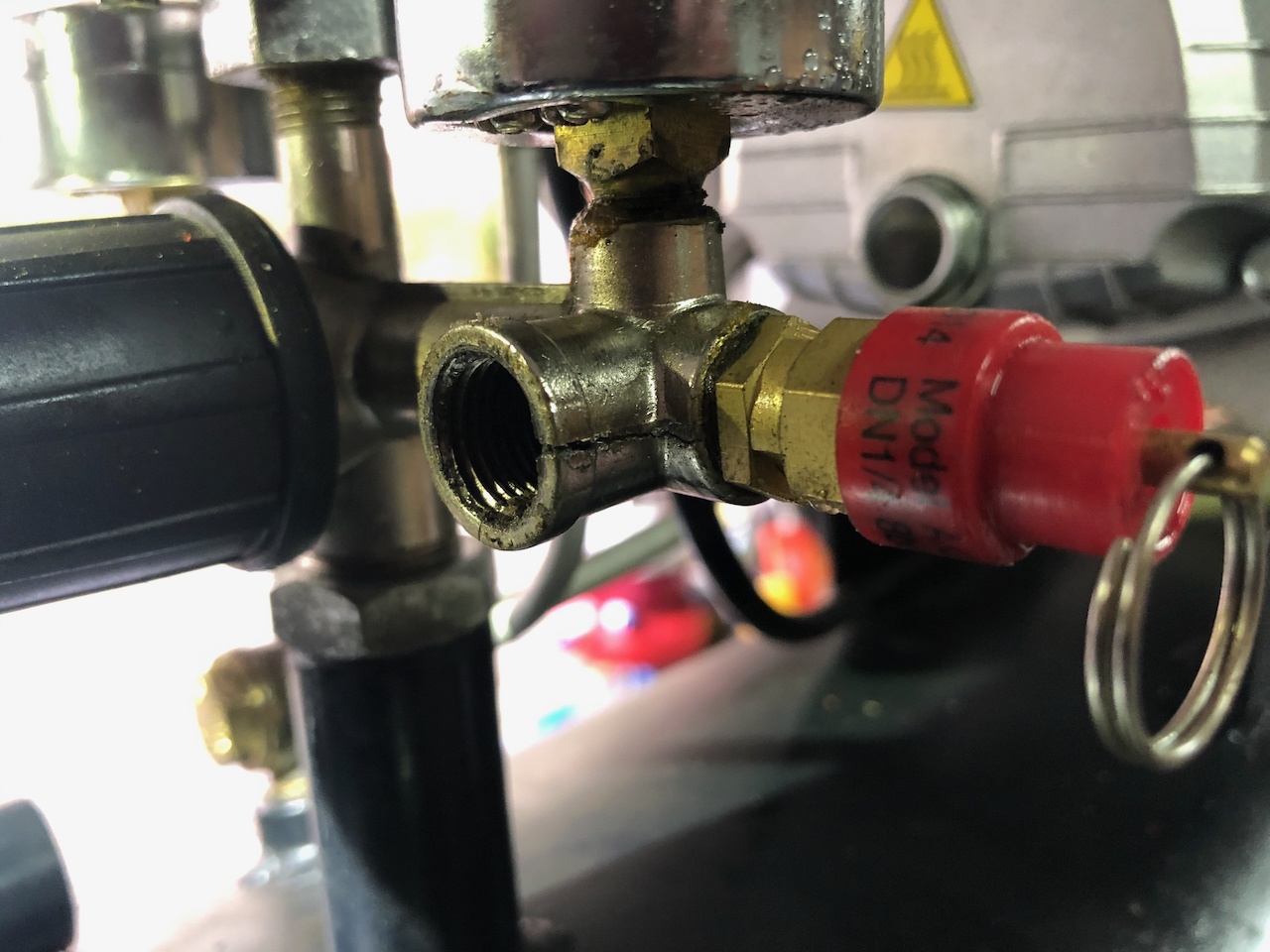

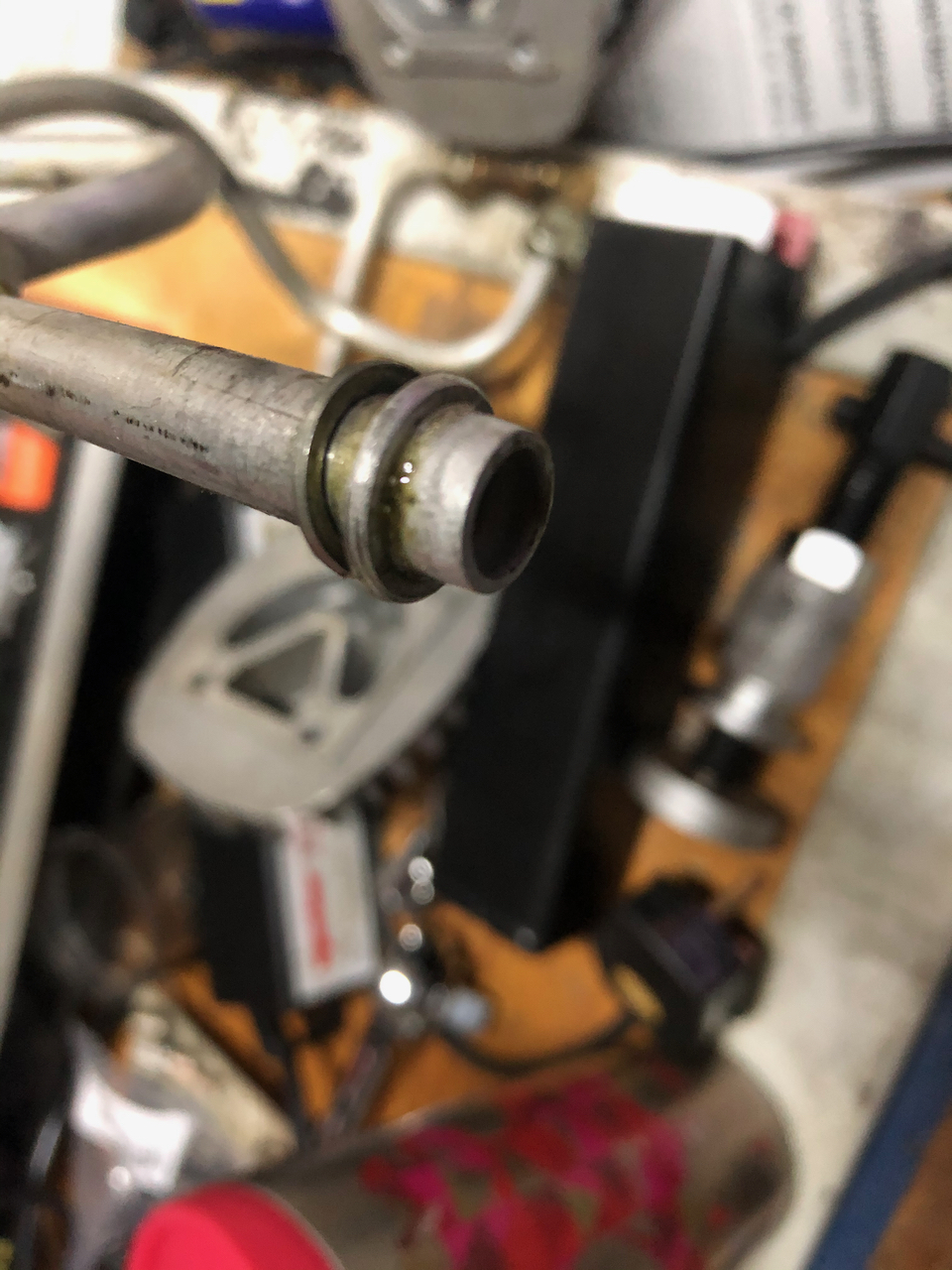

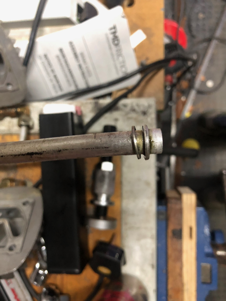

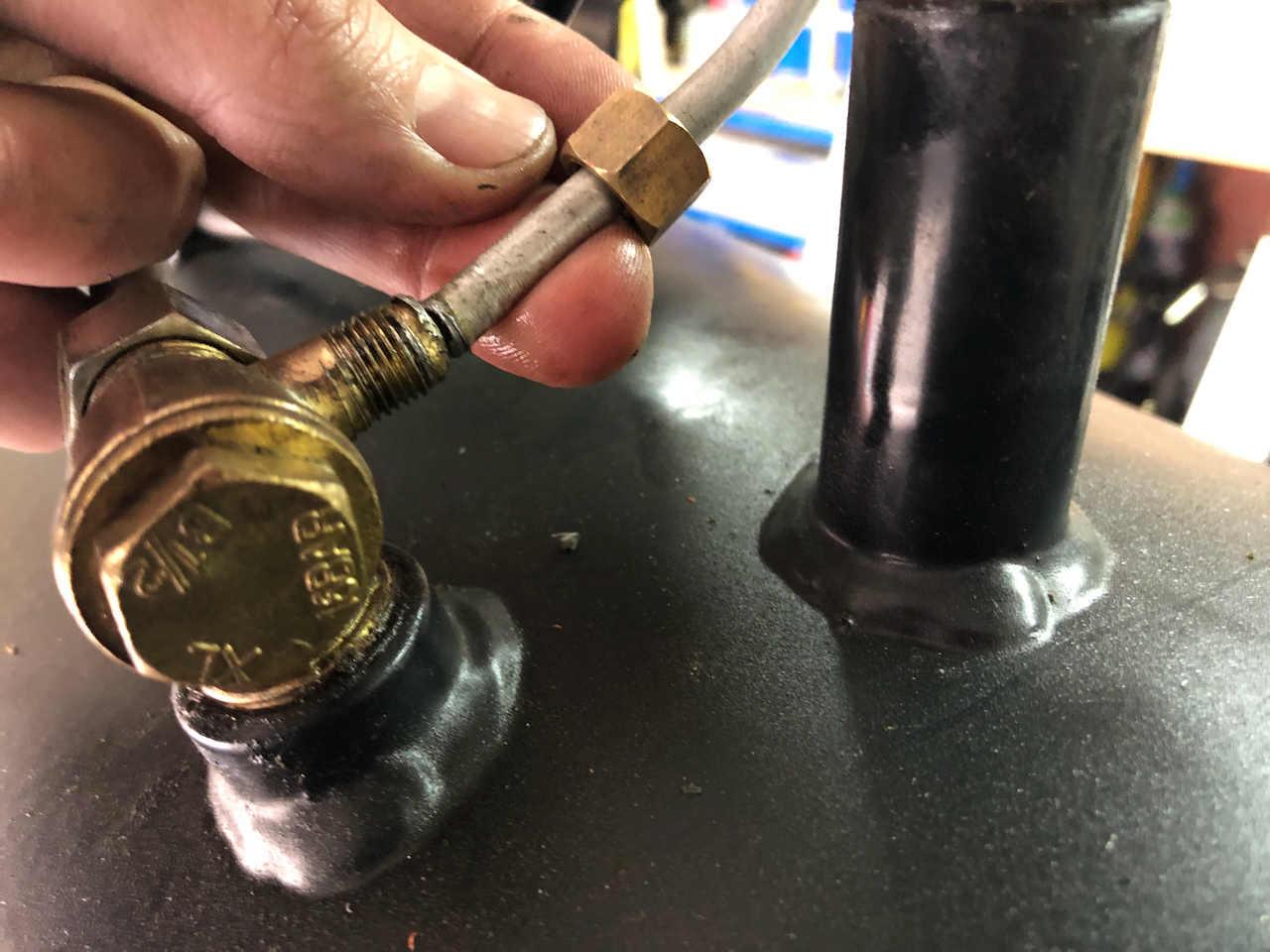

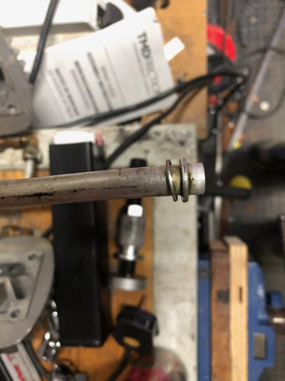

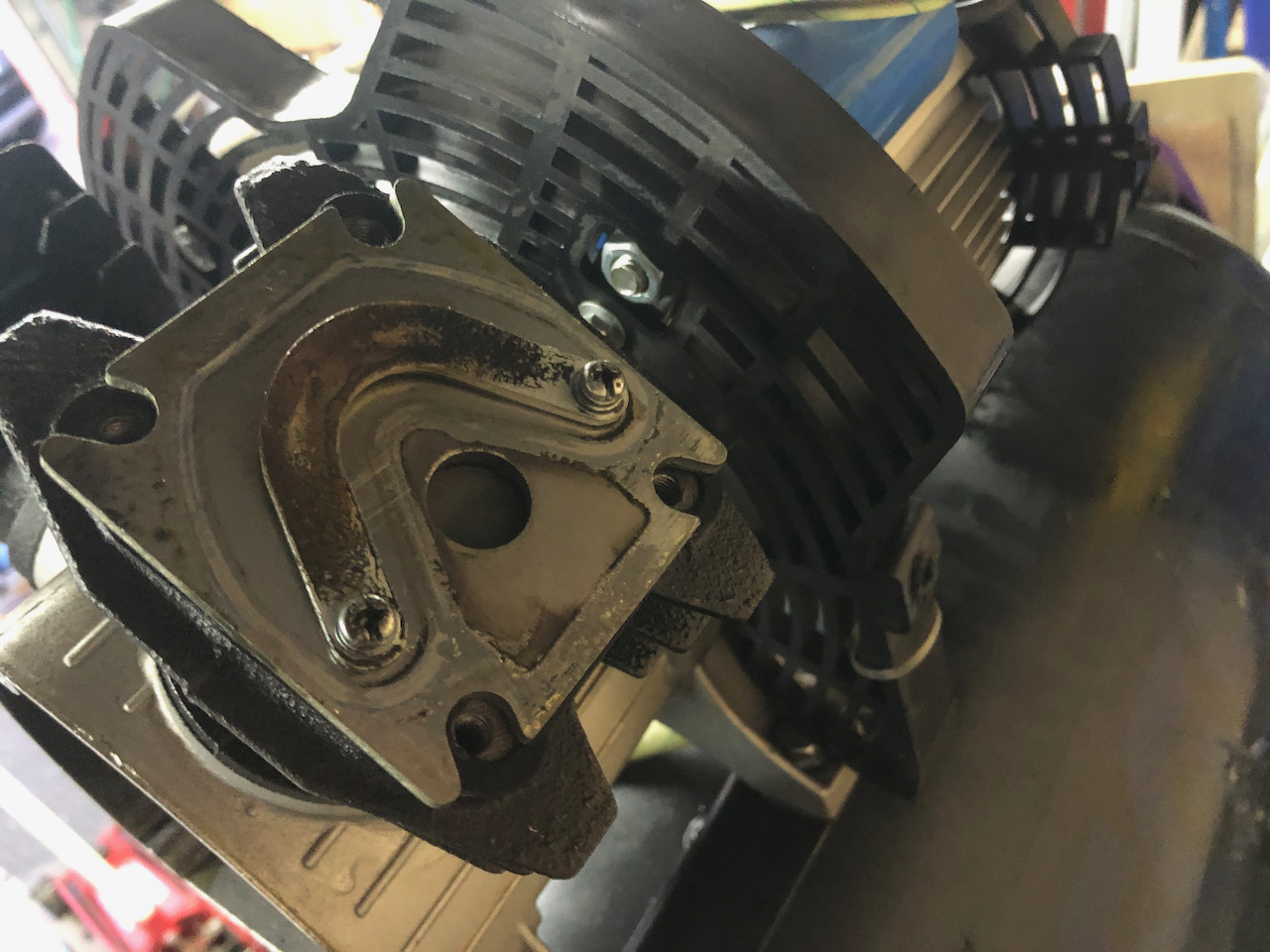

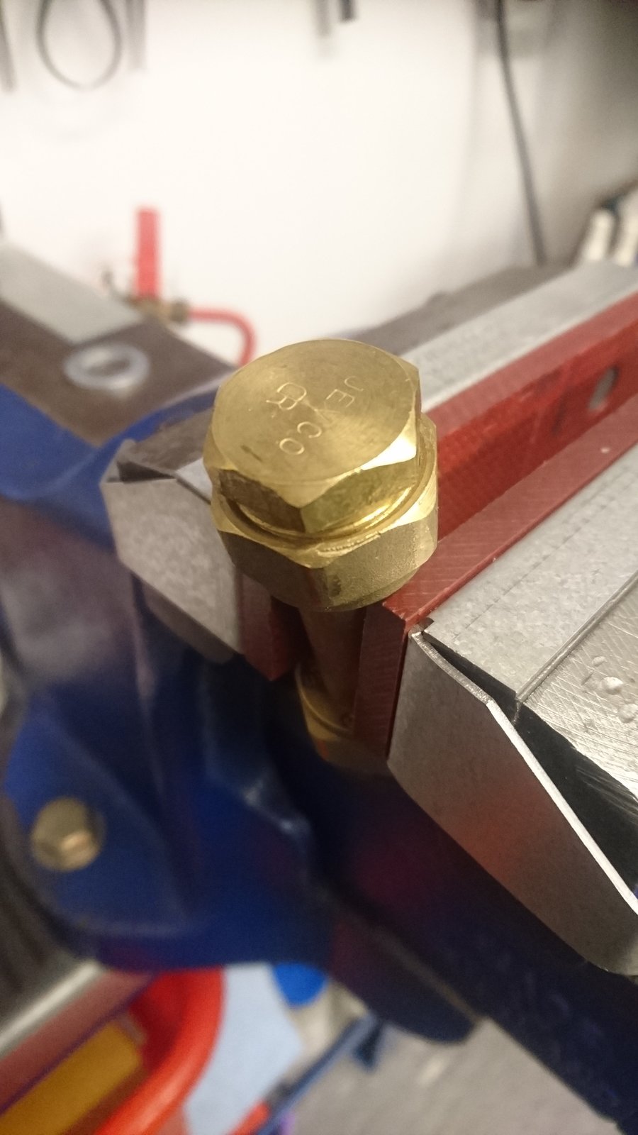

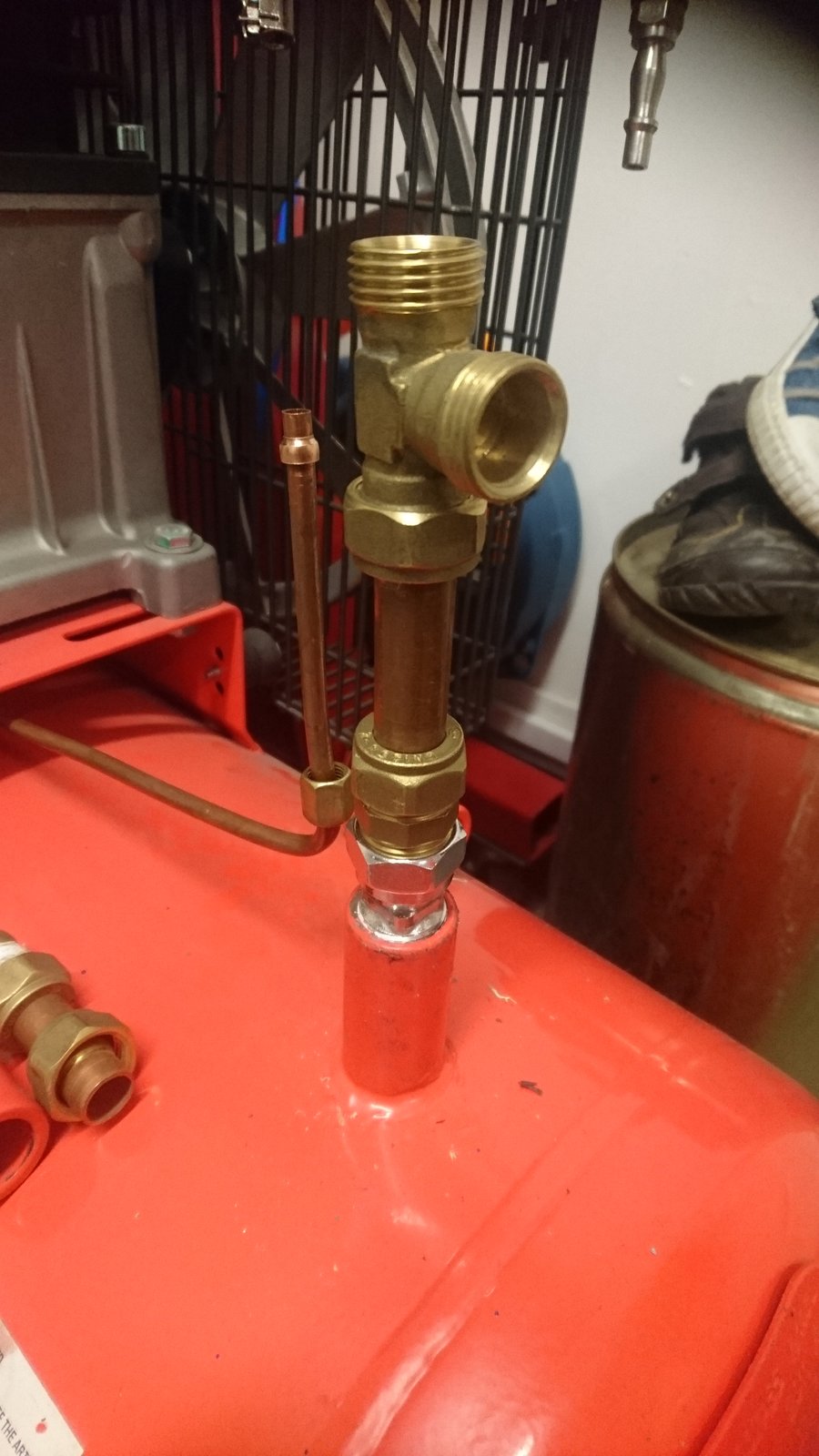

Also noticed another few problems (really not impressed with the quality of this machine) the regulators made of cheese it seems
and connecting pipe flanges are in bits
So before i start replacing the regulator any ideas or thoughts on what damage i have caused internally?
