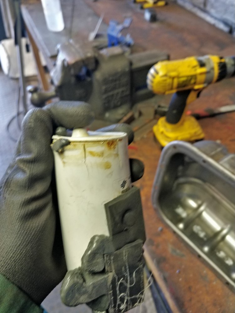

Something weird going on with my 4HP compressor. The motor acts like it's struggling against heavy resistance, tries moving, makes very slow start, voltage drops (I can tell as the backup compressor slows down) and then the built in breaker kicks in. However I can turn the pulley wheel by hand showing that there's no resistance in the pump or the motor itself. I checked that there's no pressure in the system by disconnecting the thing depressurising tube that goes to the switch. Any ideas?
