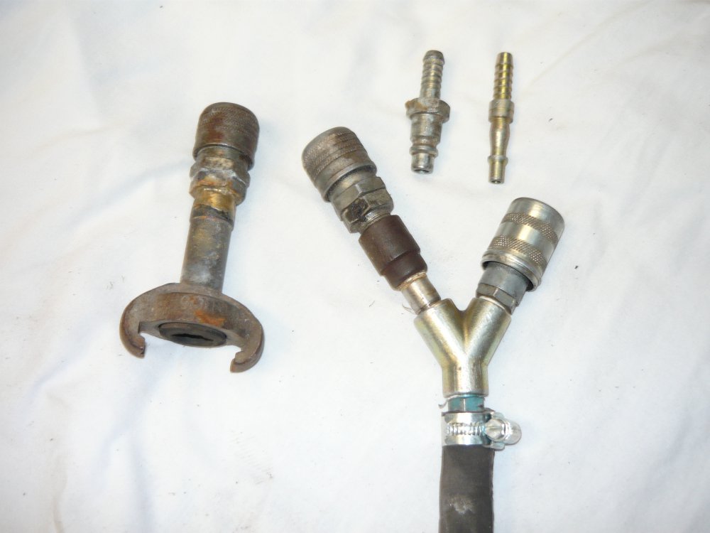

I will be running 1/2" piping an 1/2" BSP fittings at the compressors and at the regulator and hose reel. What sort of quick disconnects would be suitable at the end of the hose reel to attach to the tool? I don't want these creating a restriction. Seeing as the standard PCL ones have a bore of 4.8mm, but they are very short, therefore the pressure drop caused by these will be negligible?
