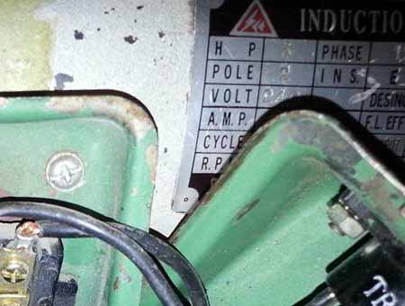

Hi,
I bought this compressor about a week ago for £70. It was listed as spares or repairs as the run capacitor had gone, however it came with a new one.
I replaced the run capacitor and tried to fire it up, but it just kept blowing 13 amp fuses. The guy I bought it off said he happily ran it on 13 amps and only stopped using it when the capacitor went.
It was wired like this:
The pressure switch was a bit tired, so I decided that I'd replace that, wire it to a 16 amp plug and take the output direct from the tank rather than via the 1/4 switch outlet. I also sorted a few other little wiring defects.
I fired it up this afternoon and it runs quite happily for about 10 seconds before tripping the thermal overload switch. I don't think I've wired it incorrectly, but it is possible.
Any ideas on what might be the problem? I also need a run capacitor that is a physically smaller size as this one doesn't fit in the cover on the motor. Any suggestions where I can get a really small 40uf run capacitor?
Finally, any idea what make this compressor is? It's about 1990 and has a ***** Cheng Electric Industry Motor, 3hp 3000rpm motor. That's about all the info I can find on it.
