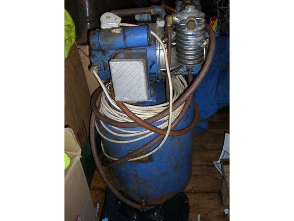

They only have a modest output, the motor is just 1/2 HP. Good for tyre inflation and low consumption air tools, intermittent use. Very well made, as long as there are no faults, the oil is changed regularly and kept upto level, they will go on for a long time.
They are fairly quiet in operation so if it has any knocks or odd sounds walk away.
