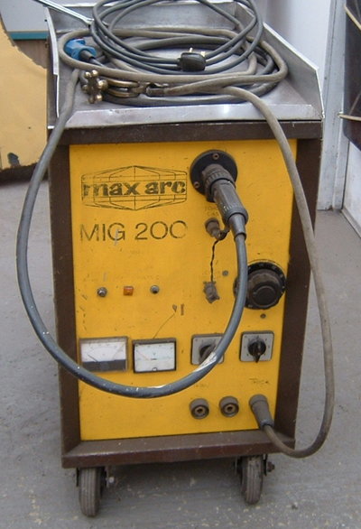

Welder just started playing up , I bought this some time ago , with a problem . Initially it would feed the wire when the trigger was pulled but wouldn't arc . After a lot of help from this forum , i managed to reconfigure to single phase and took apart the contactor and cleaned it - this fixed the problem and it's been a very good welder and done quite a bit of work .

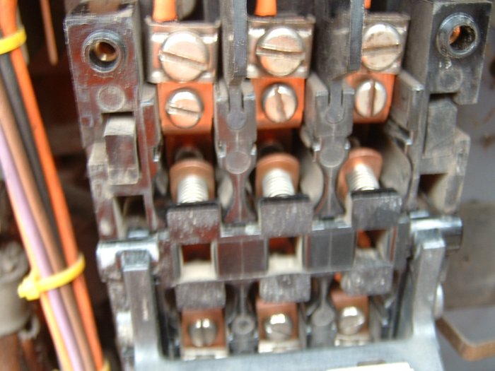

but now it's started to develope the same problem , sometimes it arcs straight away , others it feeds the wire and doesn't arc , so you get a messy start to any weld with bits of wire sticking out . I have tried to clean the contacts again , but they look worn and there's a crack in the housing .

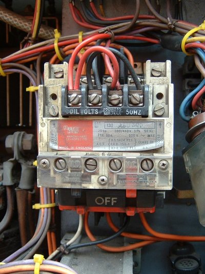

I'm trying to locate a replacement contactor ( or contactor and coil ? )
The original contactor is an Arrow Hart 130 series , 3 wires in the top and at the bottom , with 4 connections along the front ( in front of coil ? ) The machine is an old Max-Arc 200 ( probably '70s or '80s )
can anyone suggest who to try for a replacement ? any help gratefully received . Regards Al.
