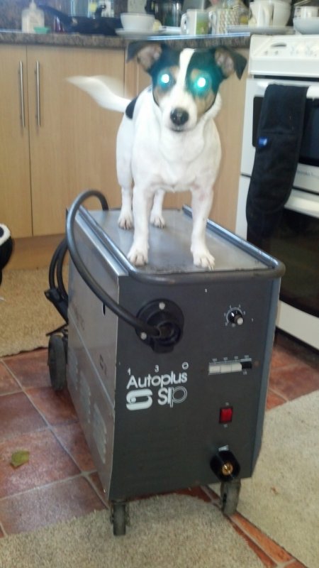

I recently aquired a SIP Autoplus 130 from @TheDevilsReject (http://www.mig-welding.co.uk/forum/threads/sip-autoplus-130-mig-welder-spares-or-repair.50381/) and was testing it last night. I've nailed it's erratic feed down to a combination of old liner and an electrical fault on the trigger wiring.
I can get a direct replacement for ~£55 but I can also convert to a Euro torch for a tenner more so that's what I want to do.

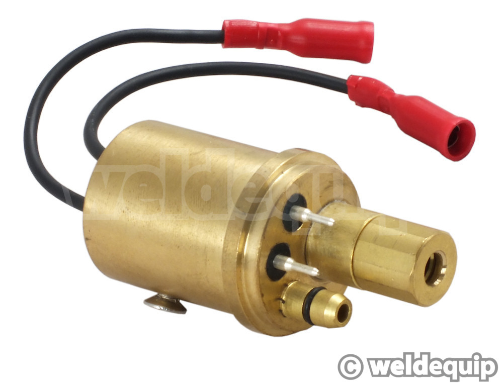

I'd like to support @weldequip as he's kind enough to help with this forum so I'm looking at the following two items to convert the SIP:
Does anyone have any experience with the Parweld torch mentioned? Is it a decent item and does it come with a metal liner?
The two plugs on the end of the Euro connector (http://www.weldequip.com/products/eurotorch-plug-body-large.jpg - the red ones), do they close the circuit between them or is one spare like in the SIP? Ie the circuit is returned via the power feed.
I've already converted the earth to a dinse 35/50 socket and it looks just the job I know it's a heavy socket for such a small MIG but my TIG set uses that size and I'm cheap so didn't want to have to buy another earth lead
- http://www.weldequip.com/eurotorch-sb150.htm (3m option)
- http://www.weldequip.com/eurotorch-plug-body.htm
