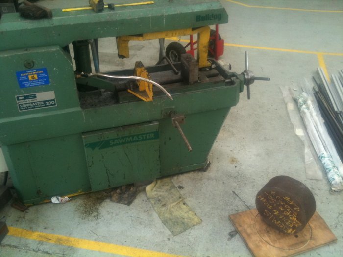

My guess is that the vice may be adjustable and should have been moved more to the end of the saw to put the work in the middle of the blade travel. Looks like it might have cut for a bit until it got to the wider part of the material.
hmm, Firstly, are those jaws tall enough to grip the widest diameter of the billet securely? secondly, was the billet too tall to allow full travel of the blade?
the short slab was only clamped half in the vice to cut about an inch of the end . it came loose and the saw frame hit it and broke there is a word for it ar ,,.,.eholes theres one born every minute in other words the cob of metal was 2 short to cut in length and secure
Well. The curious thing is it was the oldest and most experienced machinist doing this. I wandered out of my booth just before lunch as I could hear the saw going clunk clunk clunk as the outboard upright of the saw holder hit the outer edge of that round billet, the issue being that the billet was bigger than the saw could take. I know better than to tell people their jobs, although I may have raised an eyebrow or two.
The cut was almost finished when the strain of clattering the outboard upright snapped the inboard.
Foreman phoned manufacturers to see if there was a spare saw frame available. The bloke on the other end of the phone said he gets phone calls every week asking for spare parts which he can't supply, as they binned them all when the current manufacturers took over from the previous folk. Doh!
I took one look at that and thought 'I know the vice jaws can't move sideways on those, oh wait look the billet is far too big!'
I wanted a spare frame for one of these (well actually one that's around 30 years older). Same story - I bought a new saw!! I did weld the old one, saw never got reasembled as the replacement was newer. Might sell it now, probably needs properly welding though. I broke the lug off the bit that is completely missing on yours, it's where the reciprocating arm attaches.
