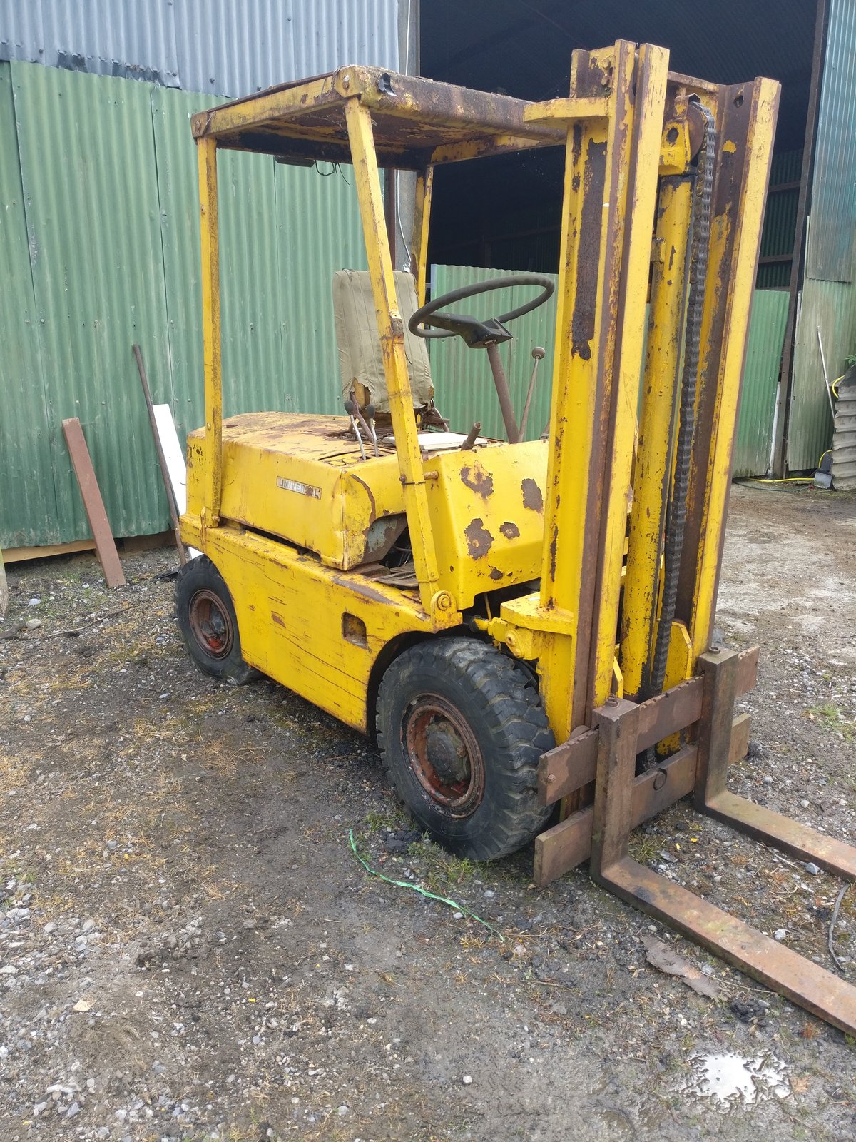

I have the above forklift and the steering box is gone, the wheel turns a three quarters turn before it grips. The steering box has to be rebuilt. Where would I get a kit or what parts do I need? I haven't opened it up yet.

Manual steering boxes were Burman, and had recirculating ball worm wheels, which had a habit of bending the tube they were supposed to "re-circulate" through leading to escaped balls. That looks like it is a big diesel, 70DA or bigger, they had a power steering box, ZF I think, we used to buy a new one if they went wrong, which wasn't often.
Hope your all sorted now, don't wory about identification plate, lots are lost on old fork lifts & it is not illegal to have lost the plate, on my forklift it is a manual box with power stearing asist ram fitted, worked very well, I lost most of steering lock on one side & steering wheel moved up & down an inch or two, the ball bearings in the top bearing wore out, I have just orderd 30 of 3/8 hardened ball bearings of the internet about 30p each including postage & am hoping this will fix it, the bearing seat on the worm is badly worn but am hoping it will go on a few more years with new ball bearings, if not I will fit a thrust bearing then a ordinary ball bearing above it.Hi
