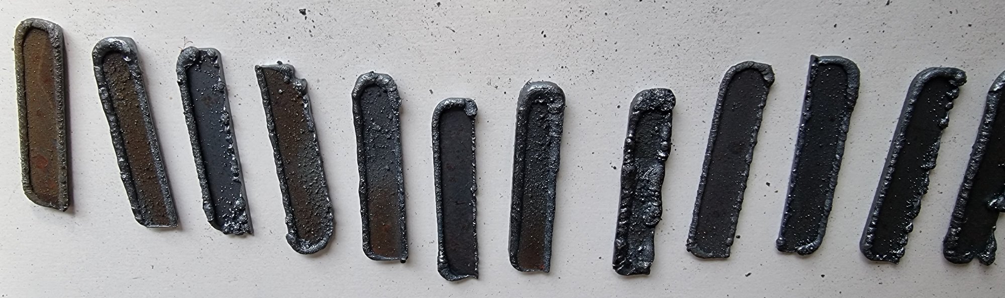

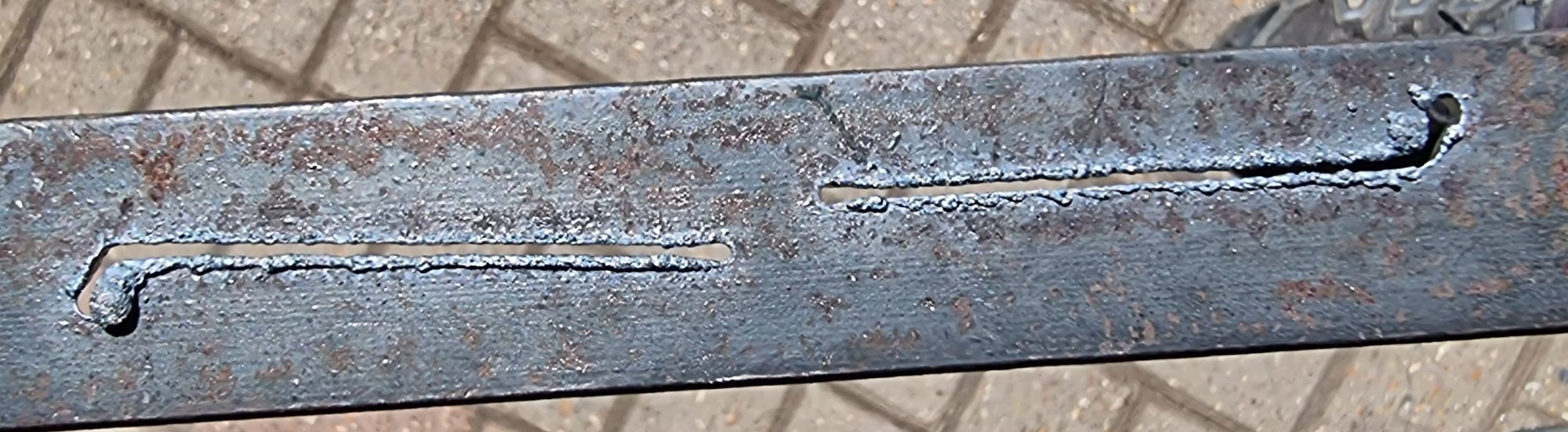

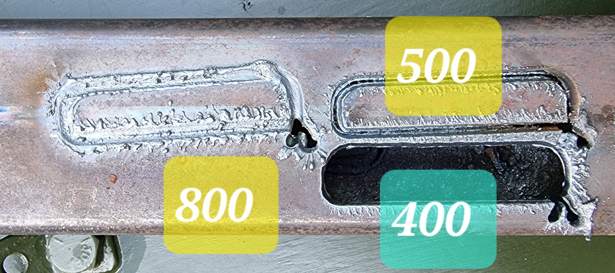

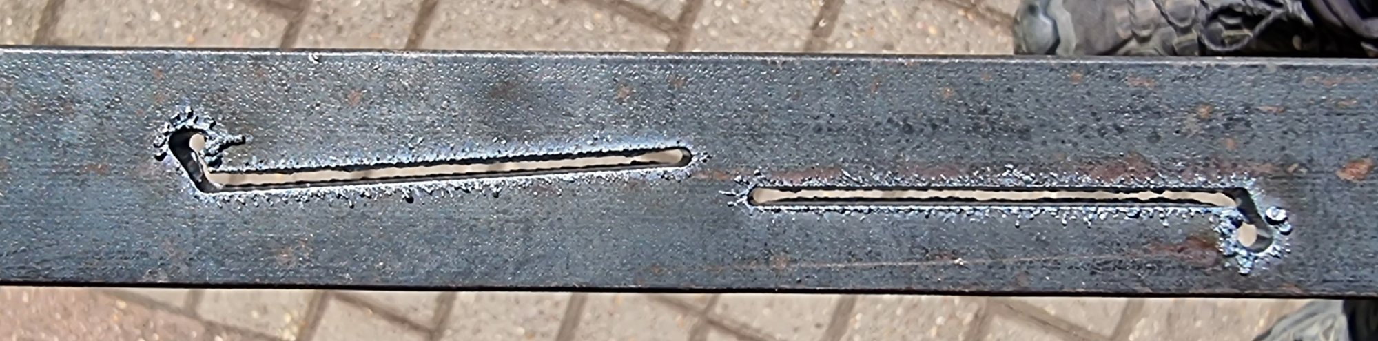

I've got a cheapo Cut50 with pilot arc which I've to date mostly used for dismantling stuff, at which it's great!
Fitting it to a CNC table, really struggling to find any settings that'll give a clean cut. The controller has floating head and does a probe and so sets cut height accurately, I don't think that's the issue.
No matter what amperage, speed or air pressure, there's always around 1mm of back-end dross when cutting 3mm steel (bit less on 1.5mm sheet). Pictures below are underside of cut.
The top and sides are beautiful, clean cut through the metal but spoiled by the scabby mess on the back face.
I've gone from 20A right up to 50A and air from 25 to 65psi. Air pressure seems to make little difference and I've changed consumables and even tried two different torches.
Cut speeds from 800mm/min (won't penetrate) down to 300mm/min (penetrates well but over 30A just gets too hot). Best results seem to be slower and less amperage.
Where I'm stuck is knowing what makes it better or worse and so I feel like I'm going round in circles. Any ideas?
