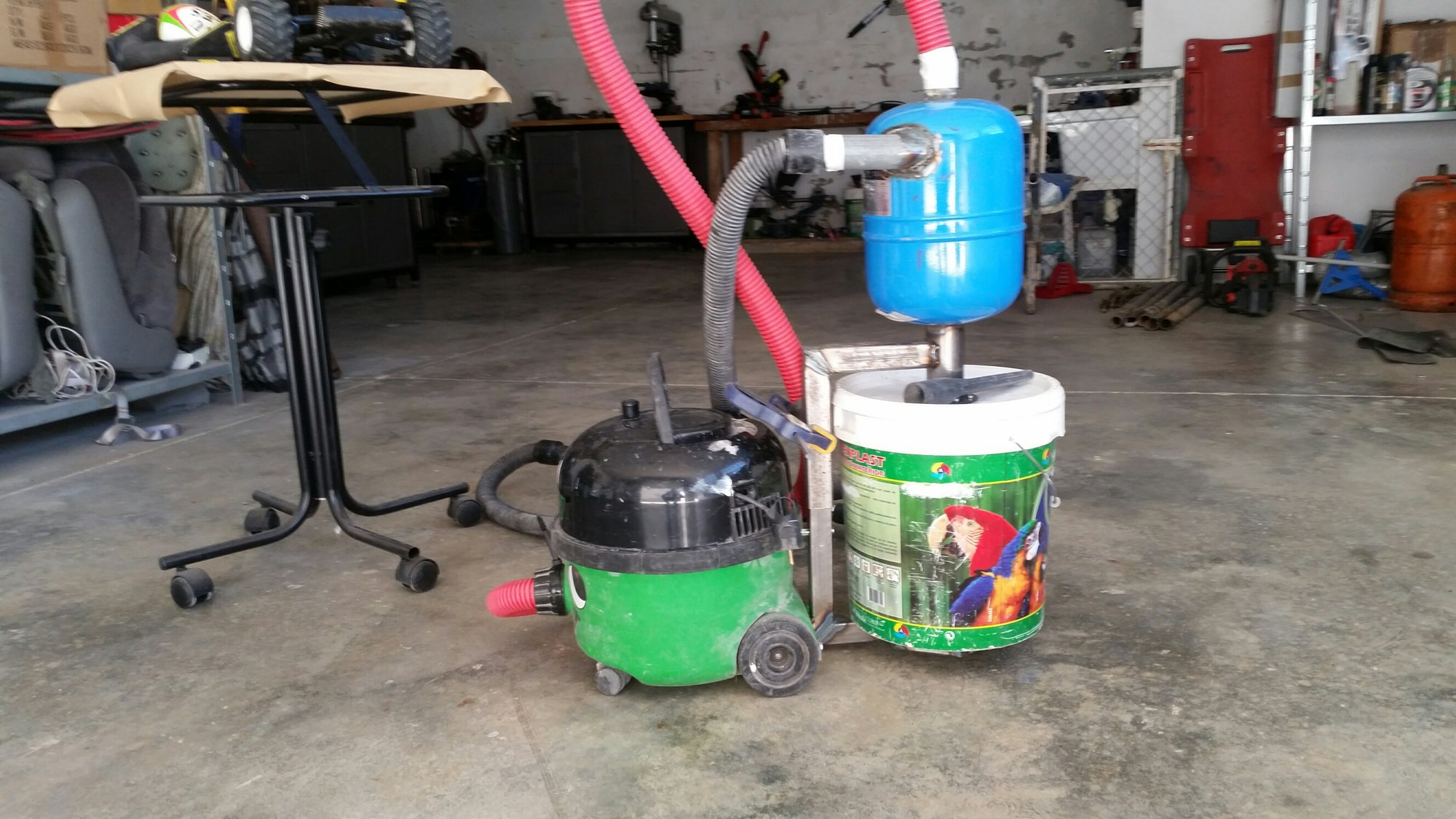

Should the top pipe go down below the level of the side pipe?
Actually it works OK with the suck just at the top. I use a converted plastic dustbin with 50mm PVC fixed to the lid.Yes or you won't get a cyclone action - it'll just draw stuff direct from the side pipe up the outlet.
