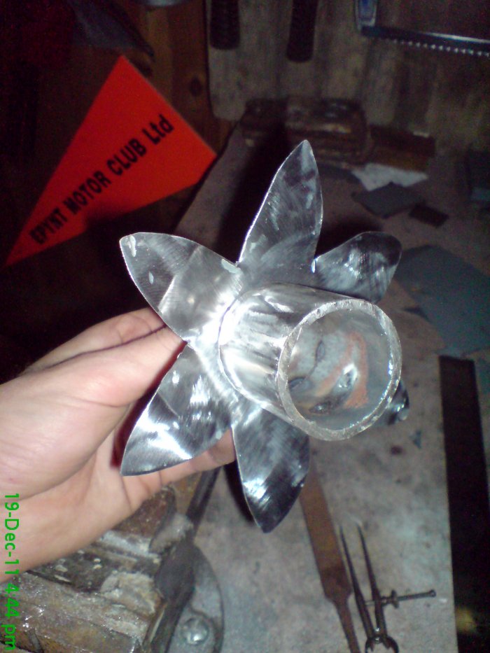

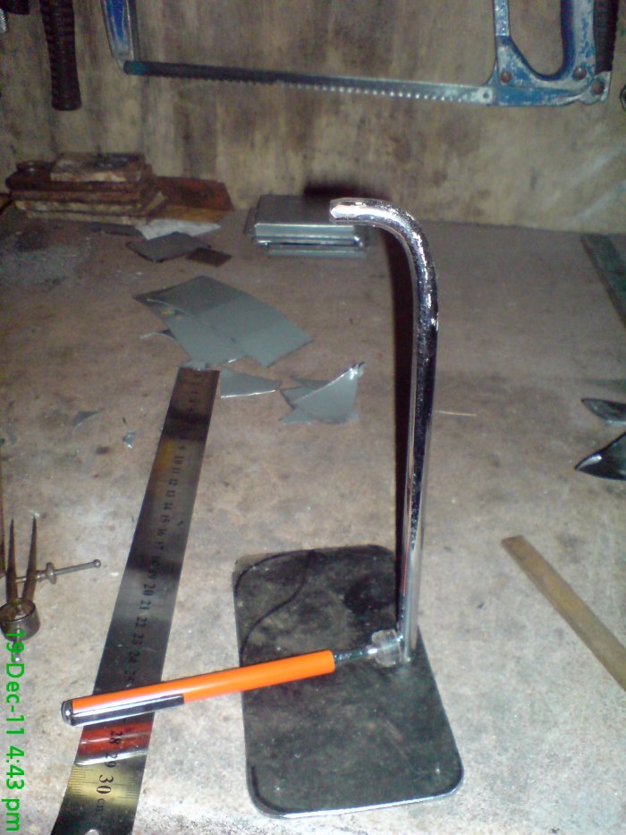

started making a daffodil today for a christmas presant. Got to the stage now of polishing the steel, now for spraying with laquer tomorow, will upload some pics in a minute (:

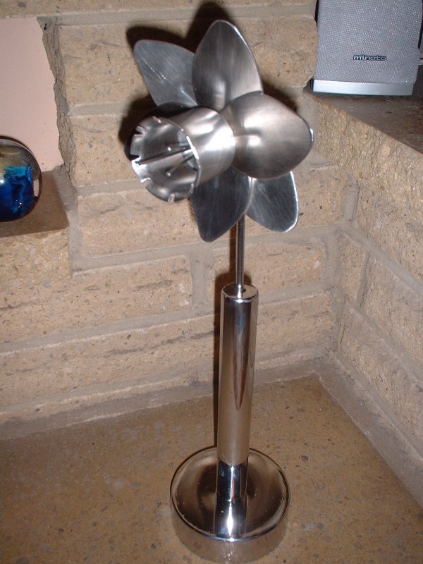

Here's mine made from stainless, it might give you an idea or two, I would put a bit of shape into the petals, curve them gently forward, you could press a ridge in them using a blunt cold chisel or similar, and as snooper says cut and flare out the bell, you might want to thin the edge of the bell with a sander to make it look a bit lighter.

Otherwise a good start, as said above I would do a little bit to make the edges a bit less harsh.

these types of daffodils are ideal for you then :L yeah i had tried to cut into the end and bend, but it made a bit of a mess as it was cut off's of a roll cage so it was quite thick. Im Thinking about the next one to make now, any suggestions?
Hi, nice first attempt, I am going to have a go at some flowers / arty type stuff myself in the new year. From what I have researched so far thinner guage metal which is a bit more malleable seems to be the way to go unless you have access to a torch to heat it up.
