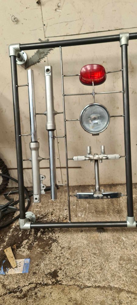

First batch has been despatched with typical emergency deadline, Off to The Arndale Centre to a refurbished store
Time to start batch 2.

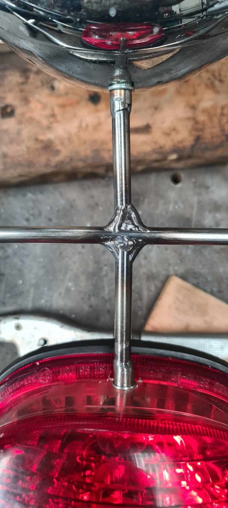

Weirdness first

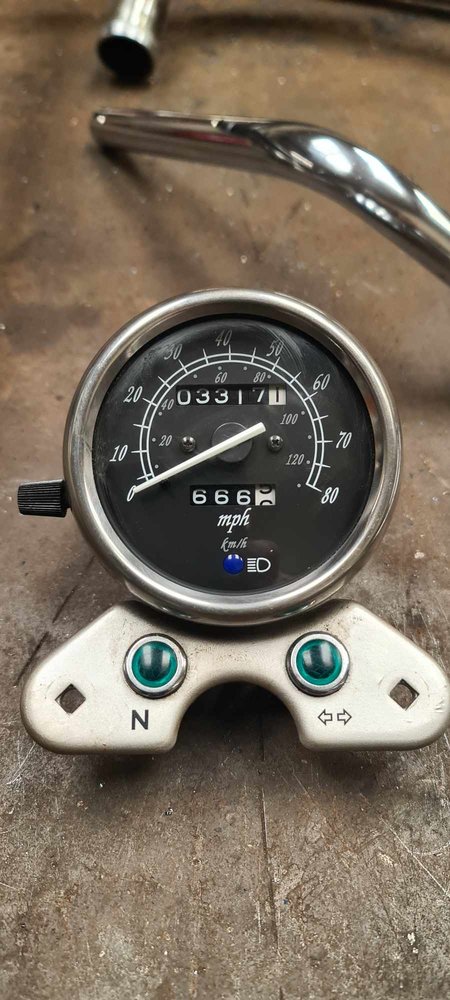

the clock
I must find a way of jamming the reset button

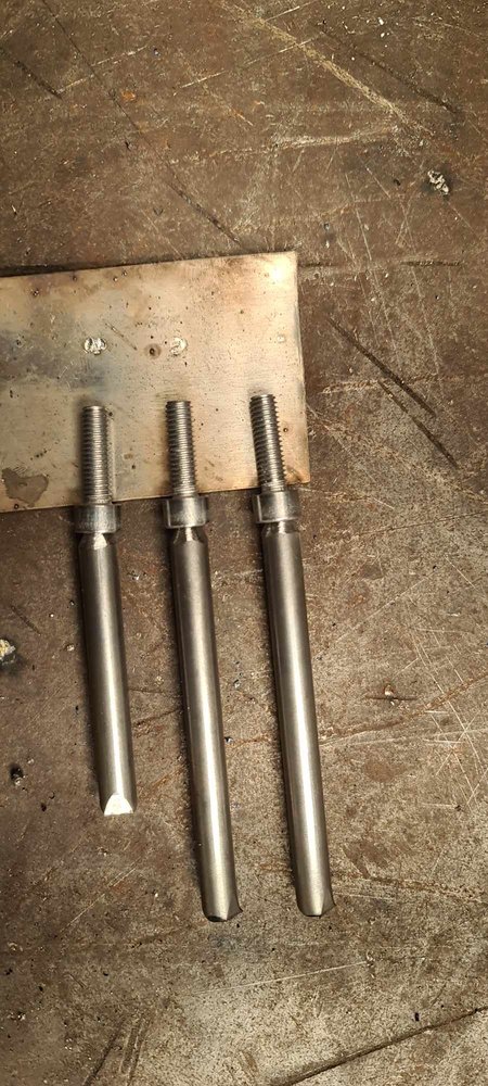

Fixings can you buy anything like this? fixing ally or plastic to the steel frame
Im using 20 x6mm cap screws welded onto 8mm bar set into rivnuts. A bit of a faff but works a treat
