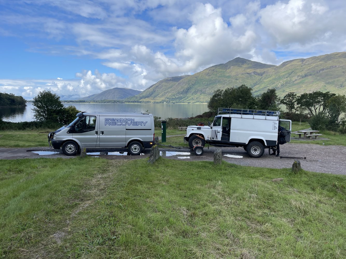

Hello all though I’d pick the brains of the collective wisdom here. Called out to a defender td5 this morning. Couldn’t get it going had to put a jumper wire from starter solenoid to the battery, and a had to put a jumper across the fuel pump relay to get it to run. Scan tool would not have it at all wouldn’t communicate with the ECU. Thinking the ecu is toast there was some signs of oil on the red wiring loom plug a known common fault. Think I’m right in that the ECU is nackered. Had the fuel pump running and spinning on the starter and it still wouldn’t fire.
