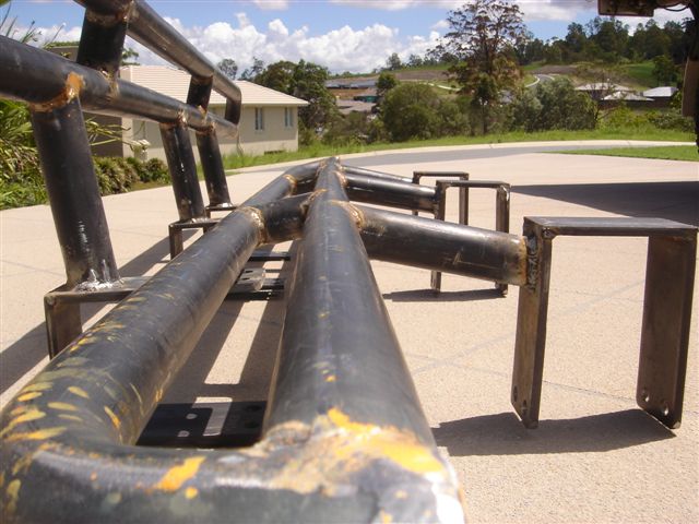

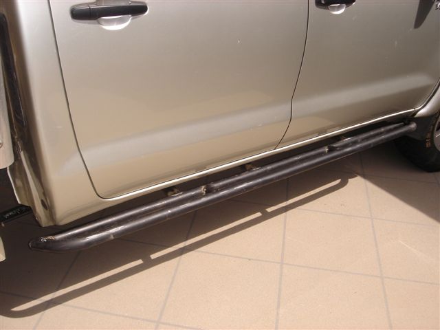

Embarked on a project to build some side steps/rock sliders for my 4wd.

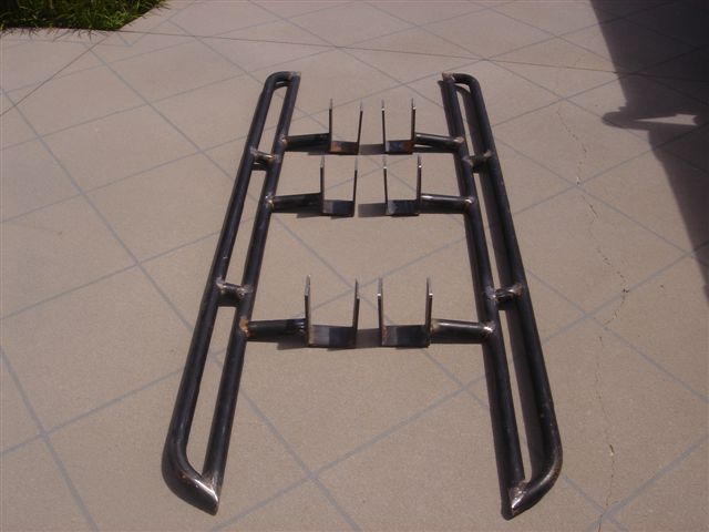

It was a fairly involved job but I was glad to finally finish the fabrication side of it yesterday only to find that the welding had distorted the 43mm x 3.2mm pipe on the inside rail(bowed about 4mm away from u bracket)enough to make fitting them quite a bit harder than when they were just tacked. Looking at the pics is this because the short pipes at right angle to the main rail were not directly opposed to eachother creating uneven heat? If I am able to get these close to opposite eachother should I weld half of one then half the other side to counteract the bending?Any comments would be greatly appreciated.
Thanks
Dan
