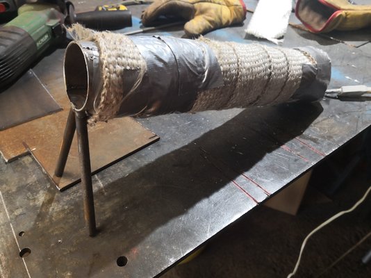

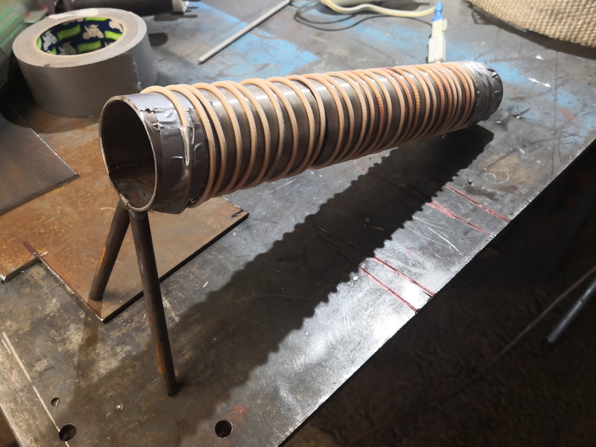

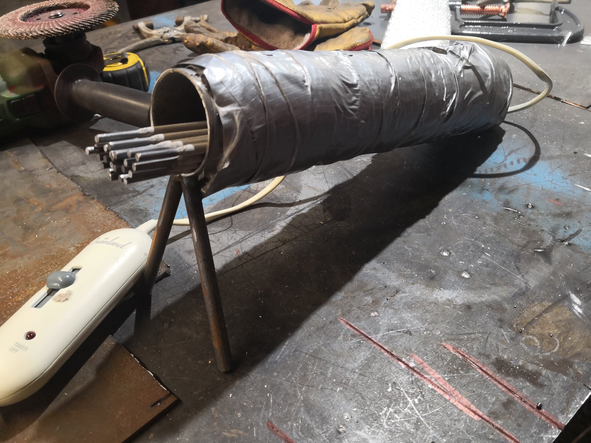

Just a little thing we made at work today and we were amazed how well it works so thought some of you might find it interesting.
Basically we wanted something to warm the welding rods up and we come across an old electric blanket.
Took it apart and got the heating cable out of it. Wrapped that around a length of metal tube that was just shorter that the rods. Wrapped it with some old exhaust banding and just wrapped gaffer tape over it to hold together.
