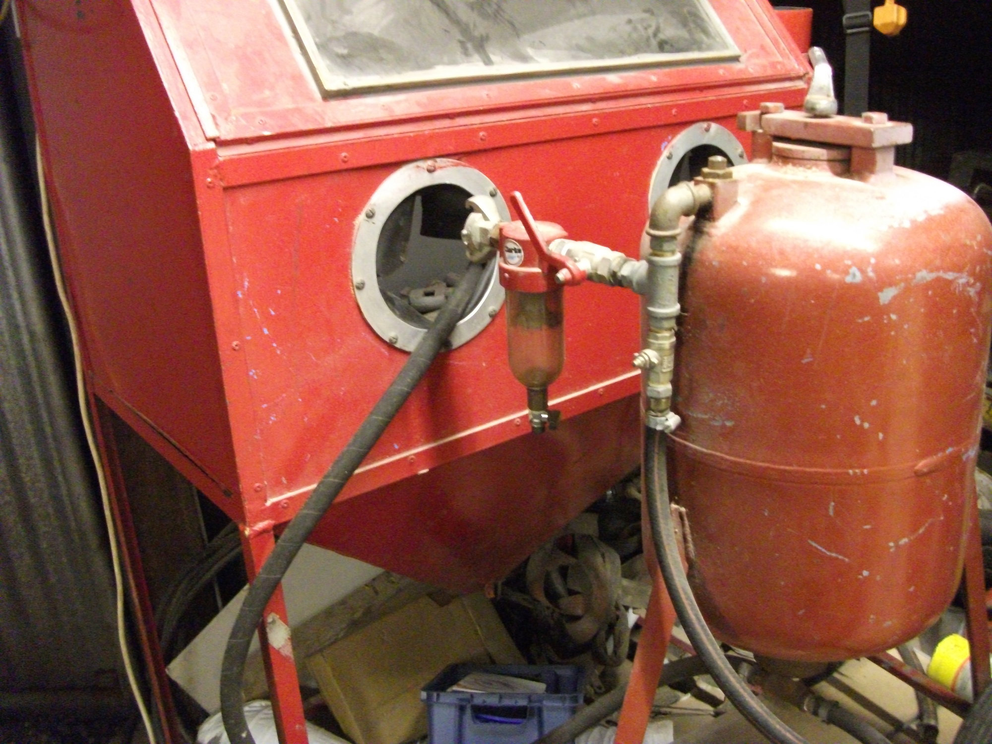

I have posted elsewhere on this forum regarding trying to use my small Sealey Blast Cabinet for Soda and so far have failed miserably. I have a Clarke 32L Blast Pot and have been advised to build a bigger cabinet and use it with the blast pot.
I picked up a Tumble Dryer and stripped it out and today I finally got started.
First I decided on the orientation (Top, Bottom, Left and Right) and then worked out where the lid and side door would be. Then I flattened some of the protruding metal ribs:
Using some spare 10mm plywood I cut out the lid:
And then went down the local hardware shop and picked up some steel hinges:
I had already spotted some blast cabinet gloves on eBay that come with all the necessary fittings, so using them I was able to mark and cut out the glove holes, after spending an hour searching for my metal cutting jigsaw blades.
After some adjustment they both fit.
And that was that for the afternoon.
Tomorrow I'll cut out and fix the side door
