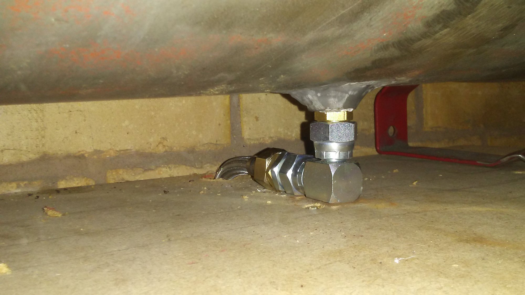

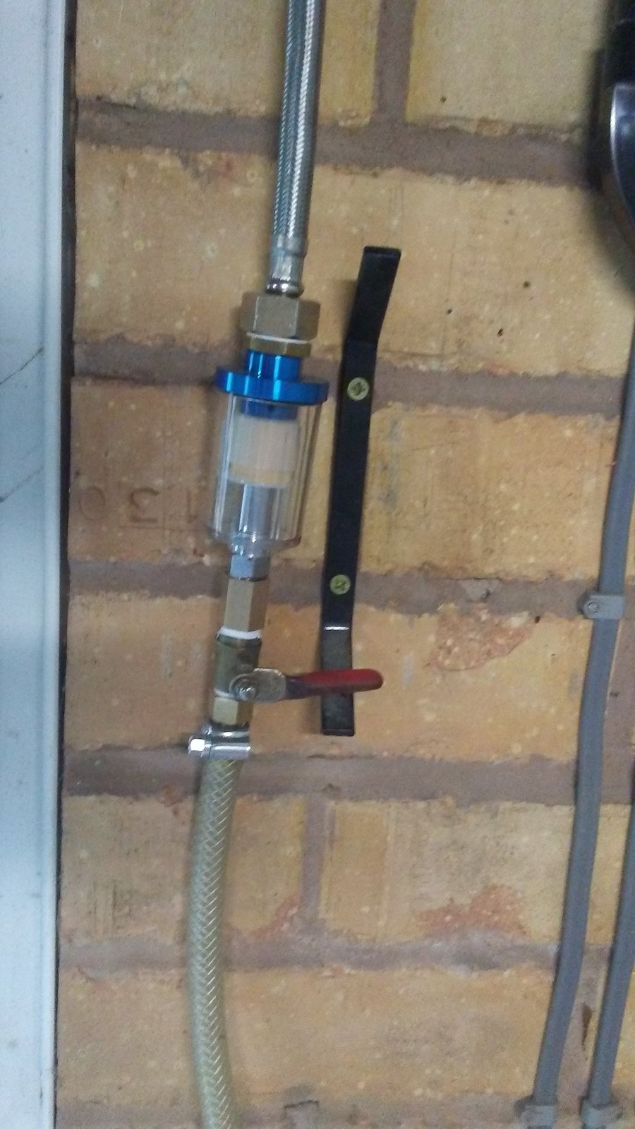

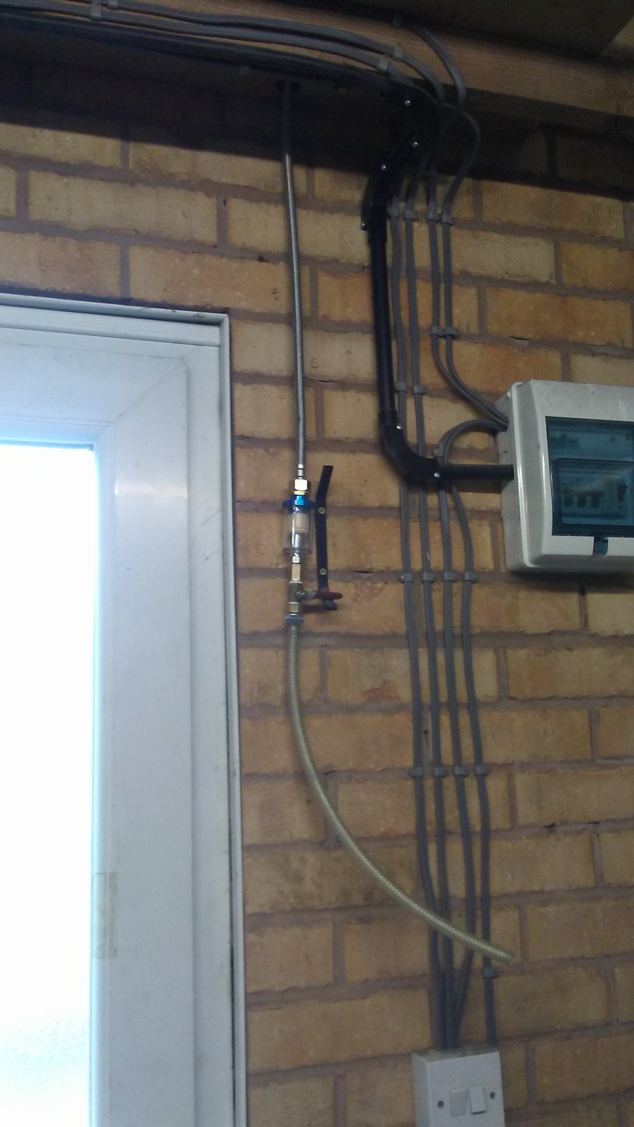

Is there an easier/more cost effective solution to extend the drain on my compressor?
The situation is I need :
90 degree 3/8 male threaded elbow to come out from the bottom of my compressor
6" extension to the wall
90 degree elbow downwards
18" extension down the wall
Then a ball valve with a short piece of hose for draining
Do any kits exist?
In regards to the extension I did think about using a flexible tap hose, They mainly seem to come in 1/2 connection, So would need to use a reducer
Many Thanks
