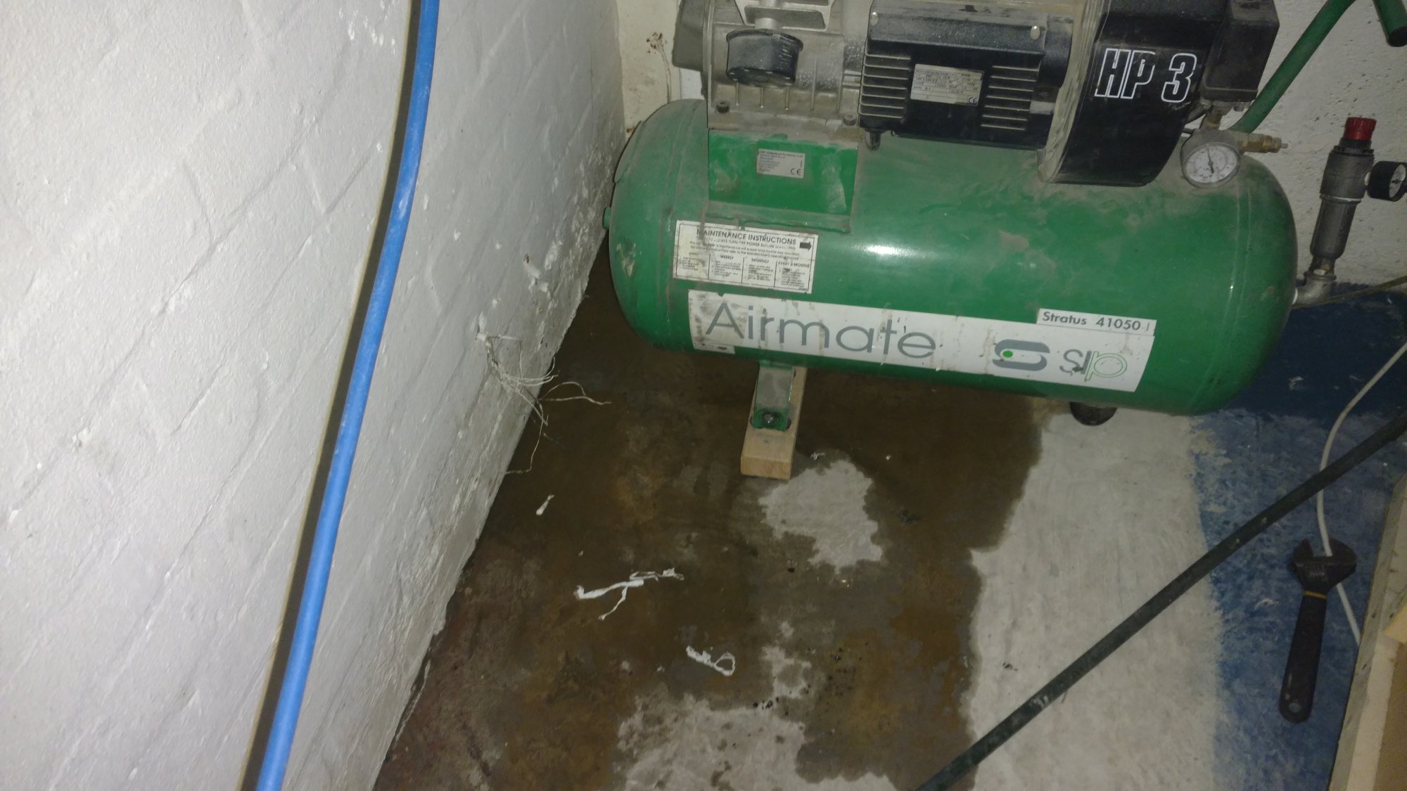

Was swapping over regulators on my compressor yesterday and also removed drain bolt to release air/water.
Forgot to put drain bolt back in and fired up compressor, after about a minute heard massive amount of air escaping and about a pint of water all over floor!
So all those times I've been unscrewing bolt was a pointless exercise, lots of water has just accumulated over time, over a year since I bought it 2nd hand and probably longer. Anyways it's running OK just a bit worried all the internals are rusted up, water did seem a bit brown (no oil loss though).
Guess thats one way of cleaning out your drain lol
Was blocked with some sort of black charcoal like substance.
