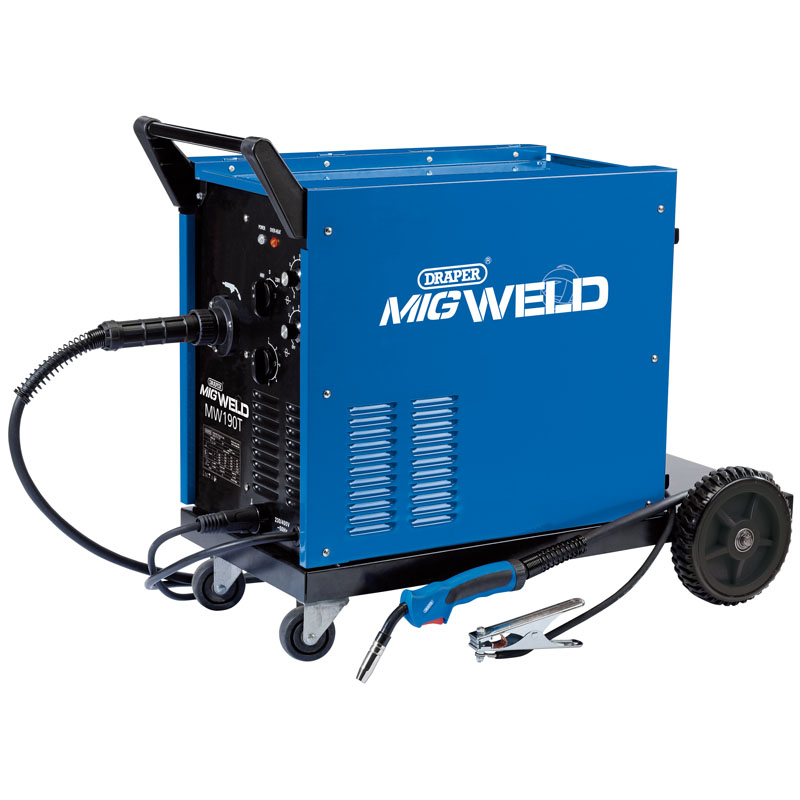

Just got one of these today...
https://www.lawson-his.co.uk/draper-71092-mw190t-230-400-v-gas-gasless-turbo-mig-welder-180-a
First impressions:
Seems to be reasonably well made (by Cebora, as fas as I know) and little things like the wheels, even though they're plastic, are quite solid-feeling and have decent bearings in them. The torch is a Binzel MB15 (or a very good copy) and has a swivel neck. A detachable earth lead is a plus, in my view, although it's only fitted with a 10/25 Dinse, and I was expecting/hoping for the next size up. No matter, that's easily fixed.
A moment of consternation when I found the mains lead was a four-core and I thought for a moment they'd sent me a 3-ph only machine, but a hurried consultation of the manual revealed the wiring is the normal Brown / Blue / Green/yellow for 230V and use the Black / Blue / Green/yellow for 415V. Both applications being single phase.
The wire drive is a metal two-roller affair, with a usual flip-off tensioner, and looks as if it will last ok - time will tell on that one, I suppose.
Of course, there's always an element of exaggeration from the makers, and the model number might lead you to expect max current somewhere up around 190A. I didn't expect that to be true, of course, but there's another wrinkle the cunning bar stewards have used in this - the max current is 180A, which doesn't seem too bad, but that's only on 440V feed. What a misleading turd that is. Max on 230V is 140A, which is ok for realistic use that I'll be putting it too, but it rankles just a little bit that those ten or more extra amps aren't available to me.
Anyway, the decision was made, the money was paid and if it works ok, I'll keep it.
Have to wire in a socket tomorrow and decide whether to bother putting a 32A plug on this or will a 16A do. I think the latter will suffice.
