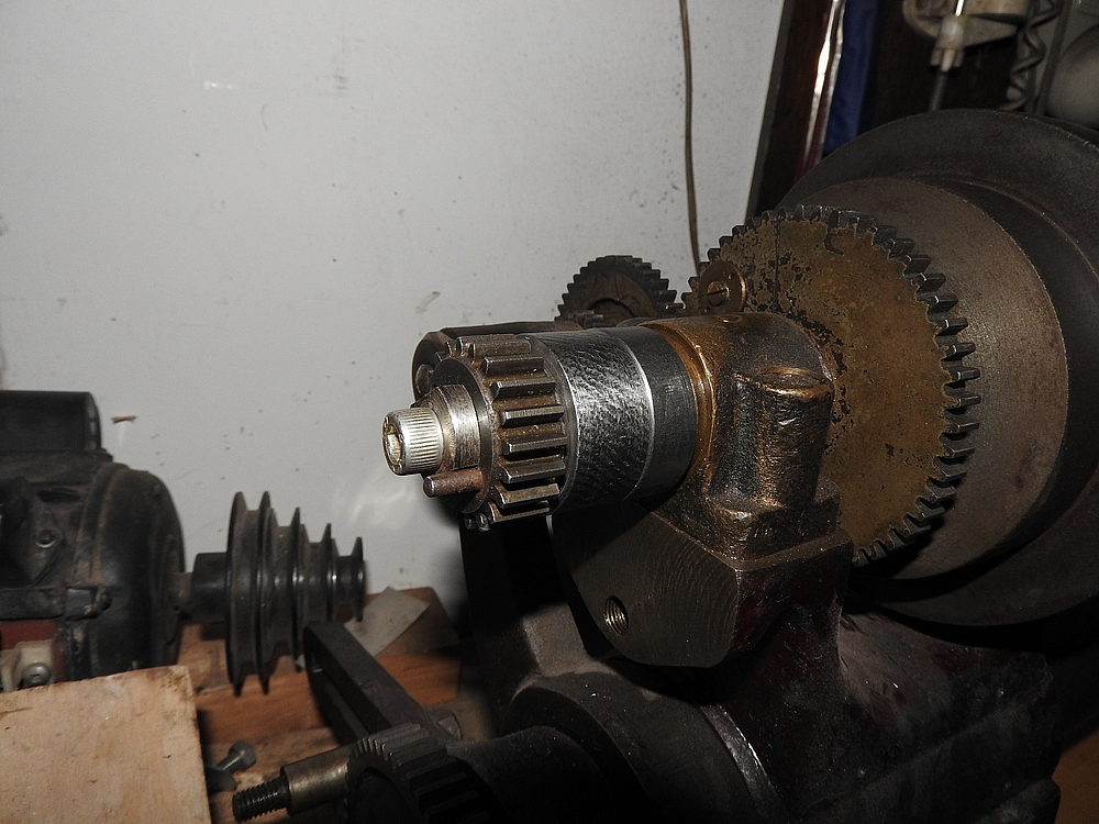

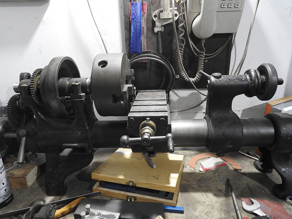

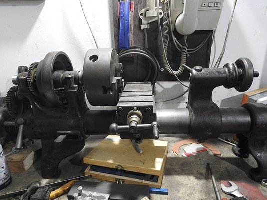

This is the second of the Drummond round bed lathes I recently acquired:
It has been quite heavily modified:-
1) Back gear fitted
2) MT2 spindle taper and hollow spindle
3) Spindle attachment for change wheels changed.
4) 6 inch chuck fitted
5) Non standard Cross-slide

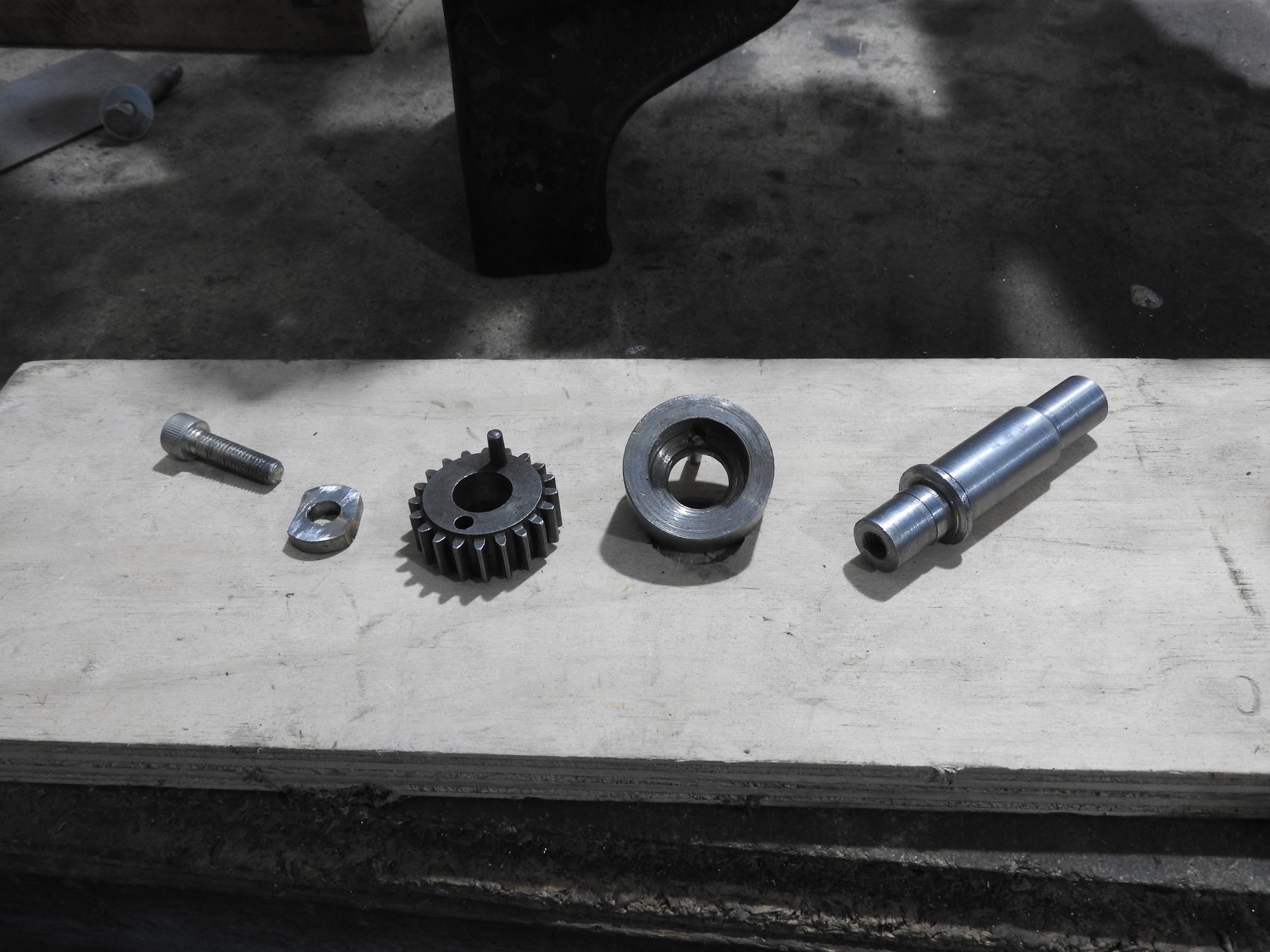

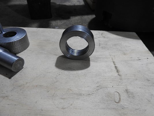

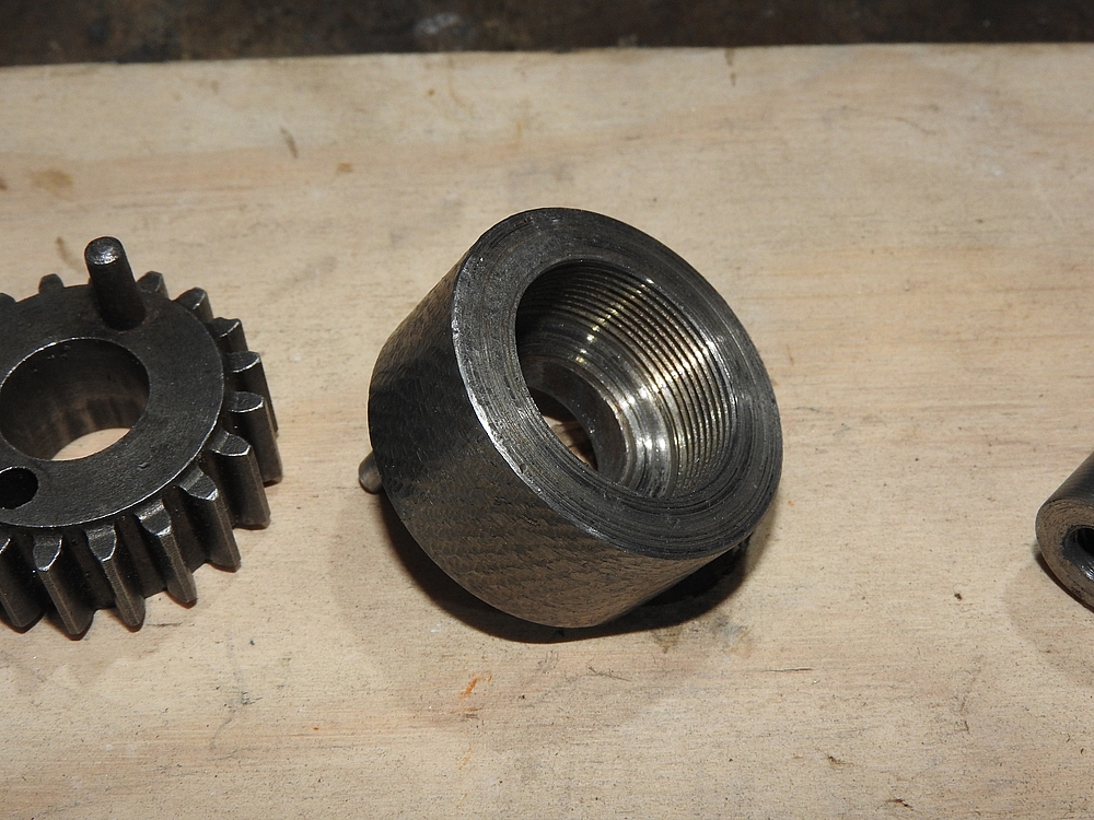

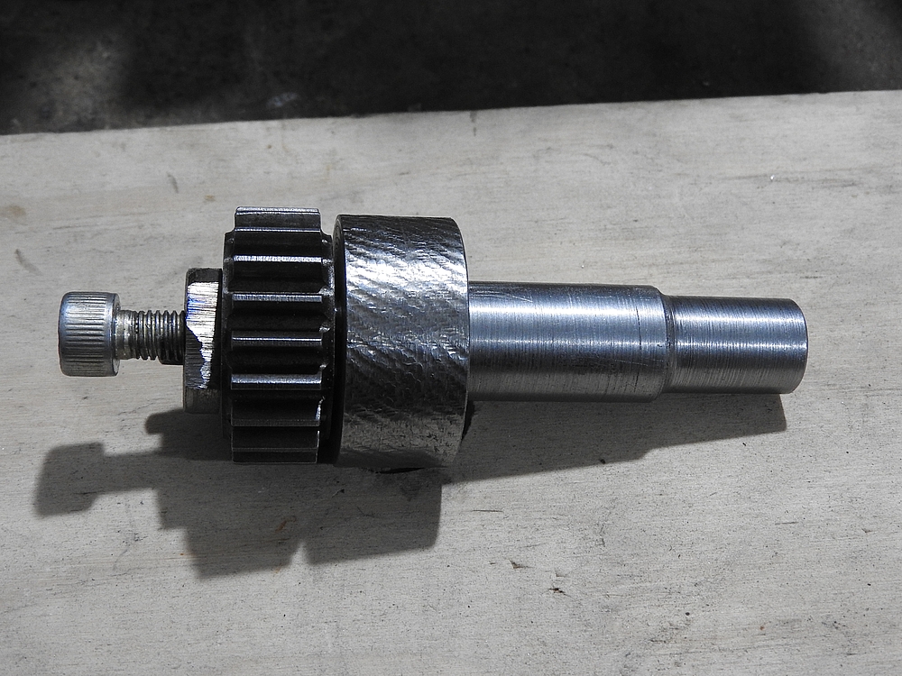

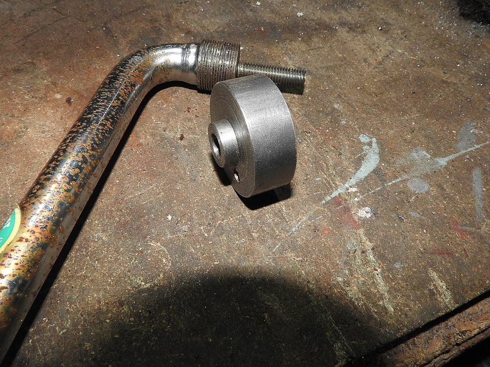

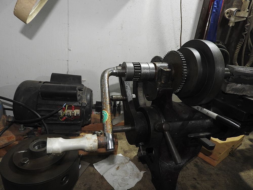

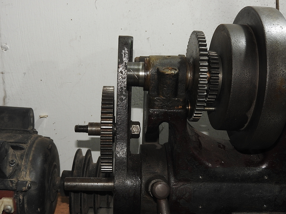

This is the modified change wheel fitting:
The damage was already done by someone trying to remove a screwed collar by cutting through it with a hacksaw. The first job will be to make a new change wheel adapter.
