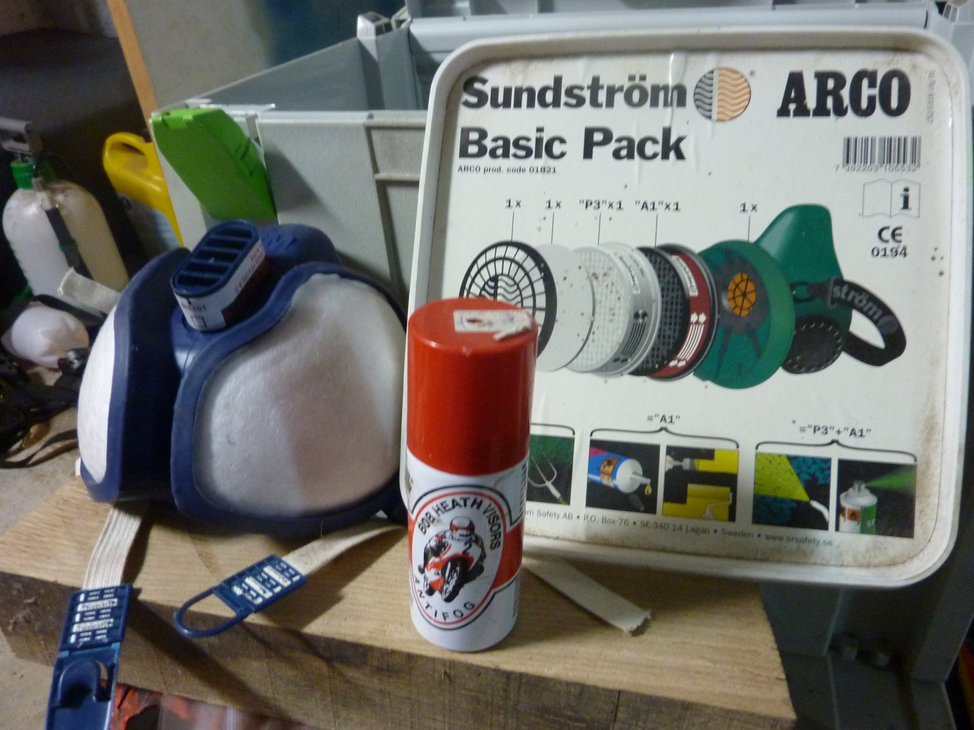

How much was it and do you have a link please..?I just picked up a new mask with replaceable filters. The price was a bit scary but I have been going through at least one disposable one a week at over a fiver each.
The filters in the new one are said to be good for a month in most conditions so if I get even half that my costs have halved.
It certainly seals better ( you check by blocking the out valve and exhaling) if you have leaks on the out breath then you need to work on fit
Best of all its made here in the UK in the same County of Lancashire
Got a pack of ten filters so will be using it about a year
About to go melt some zinc off some steady rods ( threaded stud keeping two parts locked from distortion during galvanising) . Will be handy but I will also be outside with a blower on
