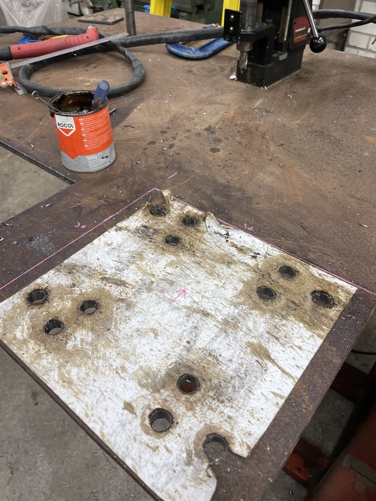

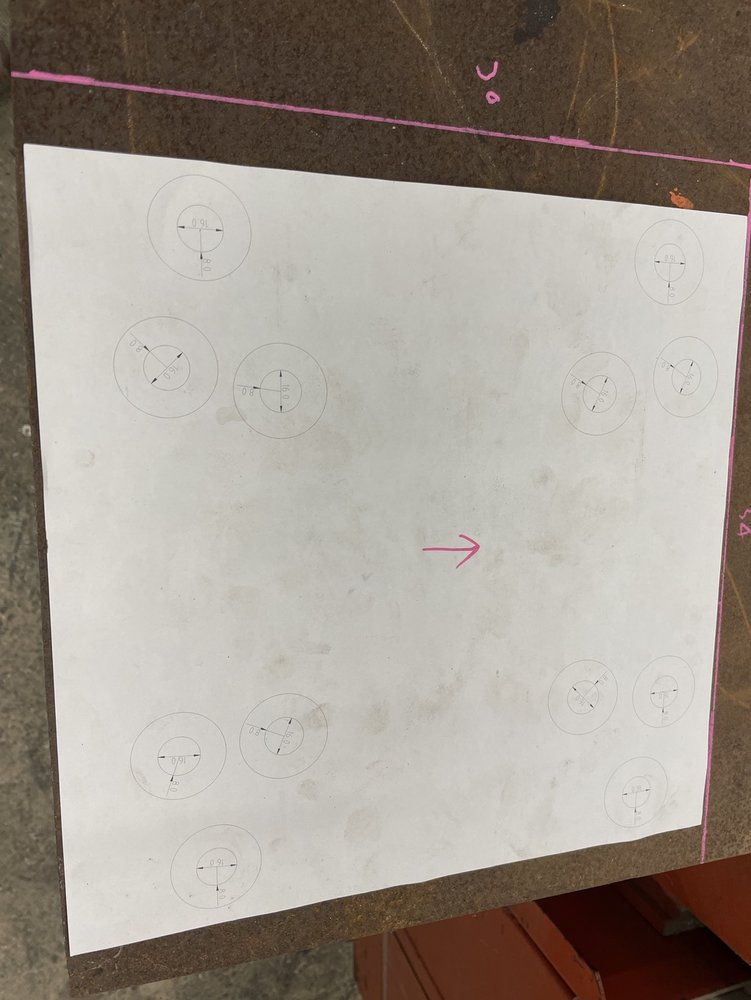

I like to use a CAD program to plot out more complicated bolt circles and patterns. Then print out at 1:1 (don't mess this bit up ) and use spray adhesive to attach to the workpiece. Then it's child's play to punch through the paper, making it easy to locate the mag drill.

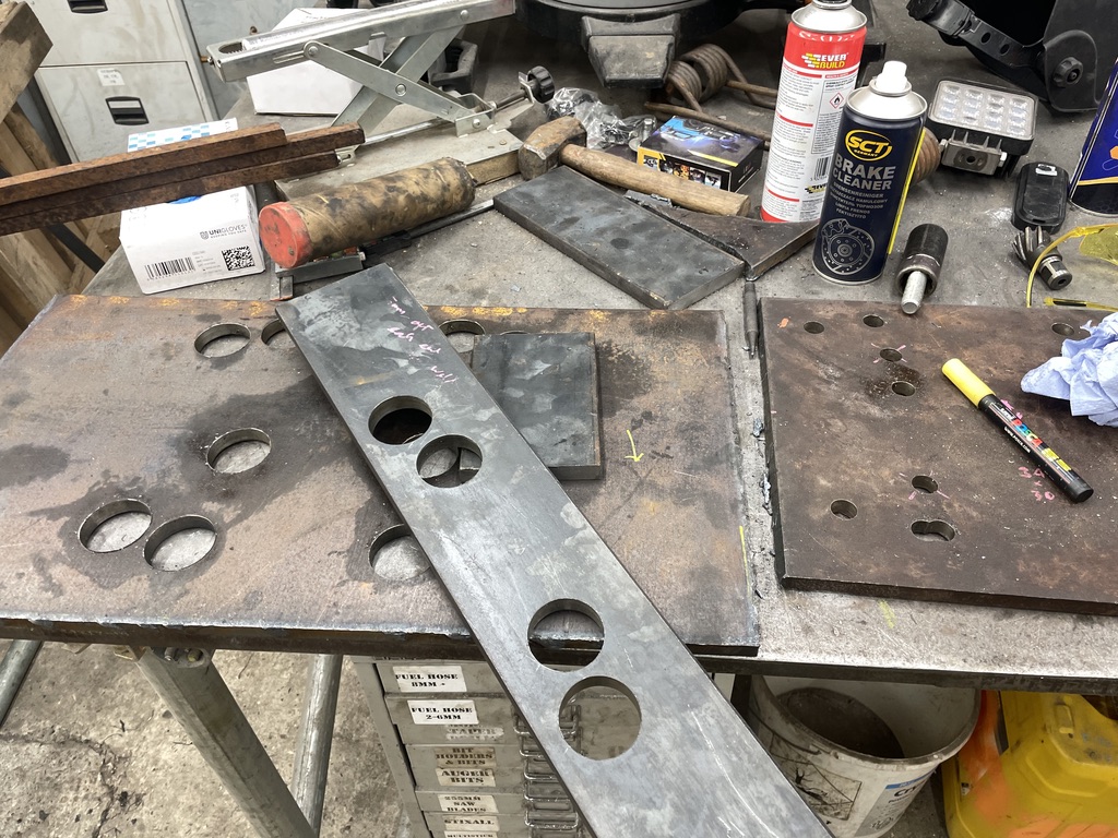

It also works great for making templates for plasma cutting, allowing you to easily nest designs.
