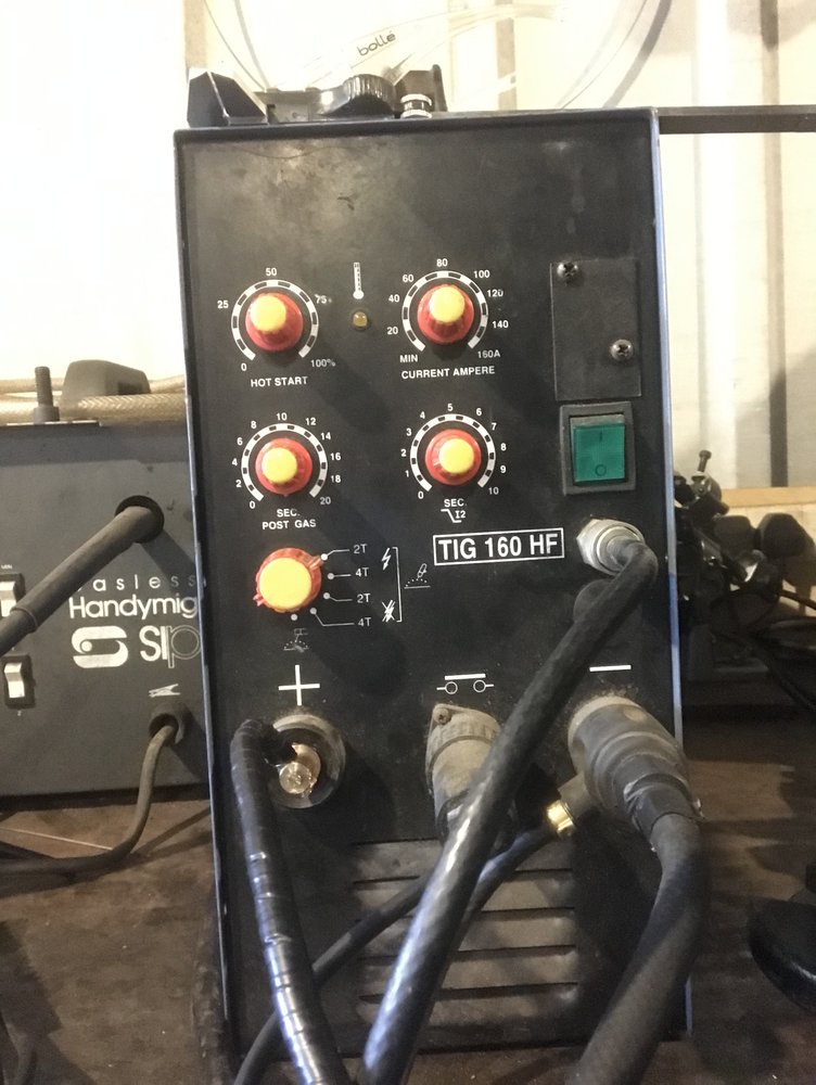

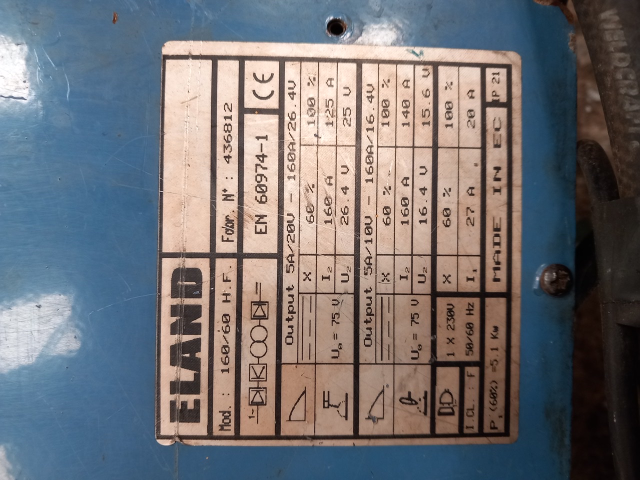

What amp circuit breaker should I wire it through? My garage is on 32amp breaker at the fuse box. I thought I’d need to drop this to the rating of the welder?
Wired a 13amp plug on for now.

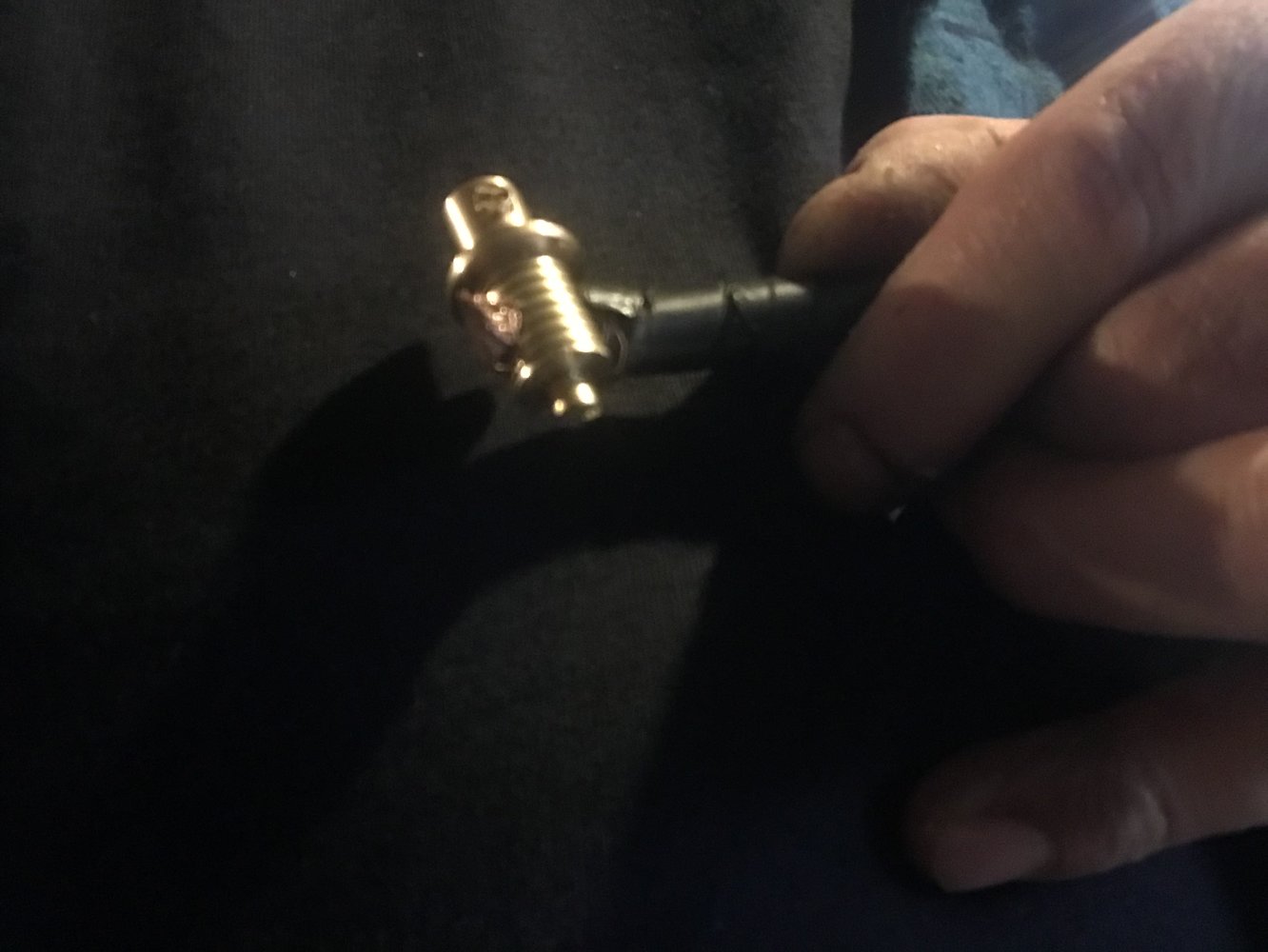

Knocked up a dinse 10-25 connector out of the little brass scrap I have.

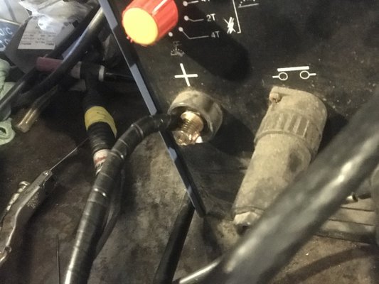

3 runs of old 10awg stereo amp power cable and a few rolls of insulation tape and I’ve managed to scorch a piece of steel plate about 3mm thick on low settings. Need to order right size tungsten/collets for a proper go.
