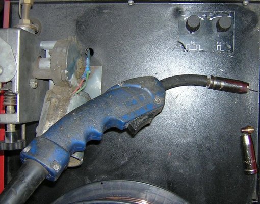

anyone know what the two knobs that sweep from + to - are for ? found them tucked away under the lid
that's what I was thinking too, both seem set to neg and it is a Mig/Mag, I'll see if i can take a picture tomorrow. there is also a symbol to each knob like a square wave, one is a single wave and the other is a double one, if that makes sense

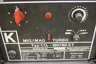

here's some photos of my welder including the 2 knobs in question, any ideas ? also some advice on the use of the 4 way switch on the front panel would be helpful
also, anyone identify the torch in the picture ?

looks like the t2 controls the off time and t1 controls the on time durin stitch welding, and t1 the on time during spot welding (but it could be the other way round
the other switch play with it looks like
spot
stitch(pull trigger n it welds pauses then welds again)
continuous (pull trigger n let go and it continuses till you press trigger aagain
seam (normal welding)
not sure what order on the switch as my welder has different graphics
