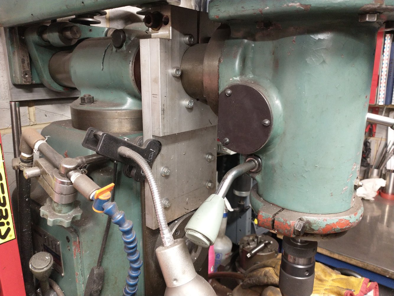

O OllyO Member Messages 273 Yesterday at 1:32 PM #1 Has anyone on here carried out a similar modification to the one in the pic? I’m about to do the same so interested in any feedback to see if I can learn from other experiences Current planning to make it 6” from flange to centre
lchris21 Member Messages 1,953 Location South Wales Yesterday at 3:45 PM #2 I went with the opposite plane. Allows rotation of the head if needed. Mine is about 9" off the z axis. Never have any surface finish issues. Used some chunky 20mm thick aluminium which was laying around.
O OllyO Member Messages 273 Yesterday at 4:43 PM #3 I wondered about that but figured it’s already pretty well supported there though obv the benefit of being able to tilt the head is appealing
