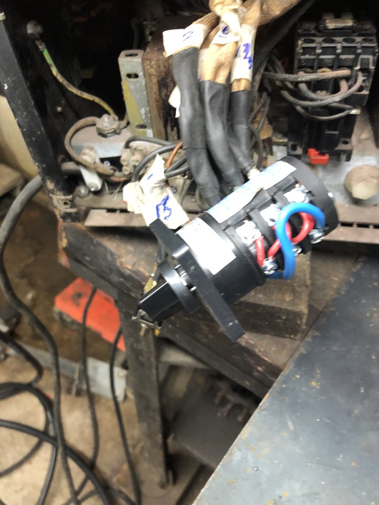

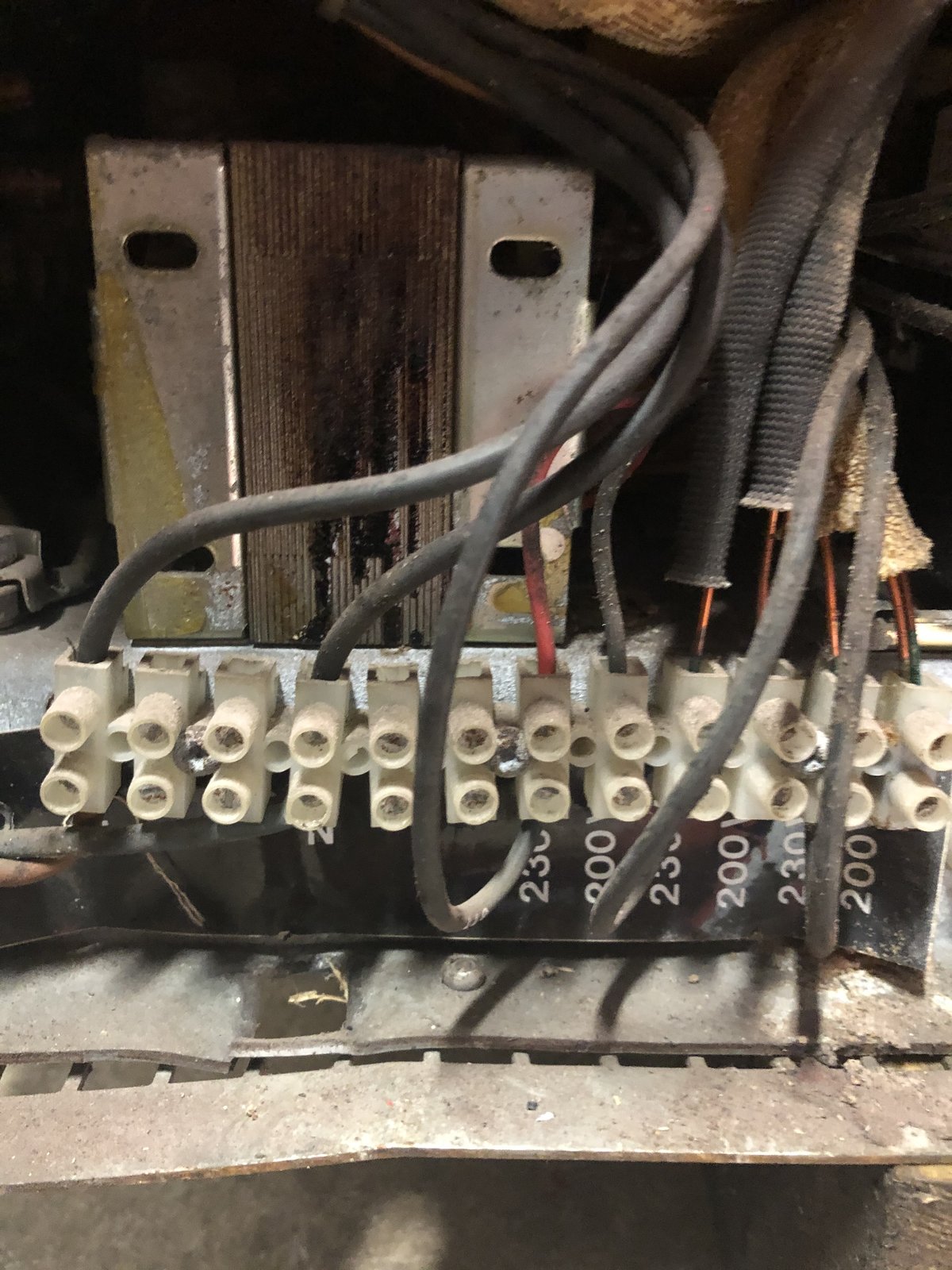

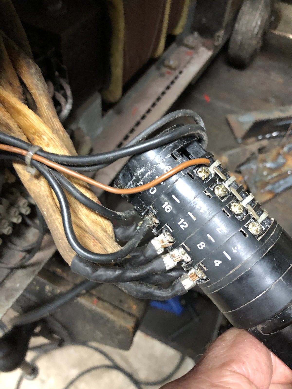

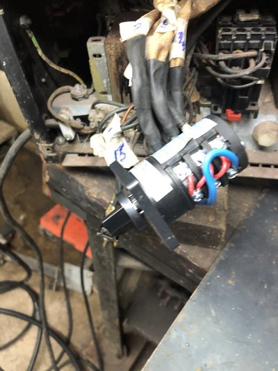

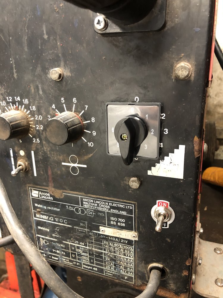

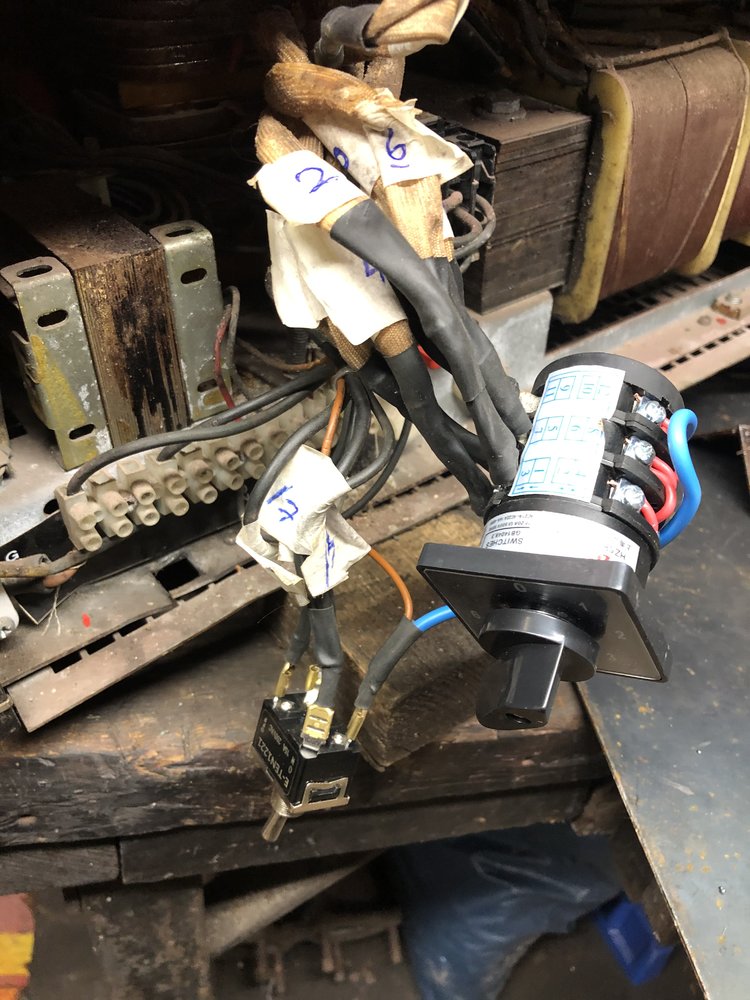

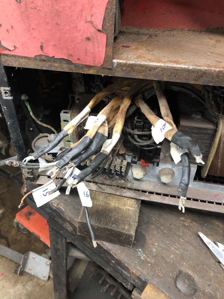

Hi All
I'm taking a look at a mate's welder that was returned to him after lending it out. It needed a new torch and wire and given it was in a bit of a sorry state, initially he though the wire feed motor had packed up, but we think that's because he'd forgotten to put the front toggle switch on the 'bead welding' setting
Putting it to the test, we then found it to be what I can best describe as 'stuttering' when running a bead weld across some 2mm steel. It was sounding like the arc transformer was tripping in and out. Given 50% of the strands on the earth clamp cable were missing, I then cut and re-clamped and soldered the cable, so that's now good. This seems to have improved things, but I'm not convinced its working as well as it should. It's certainly not as smooth as my Eland 160 @eddie49 .

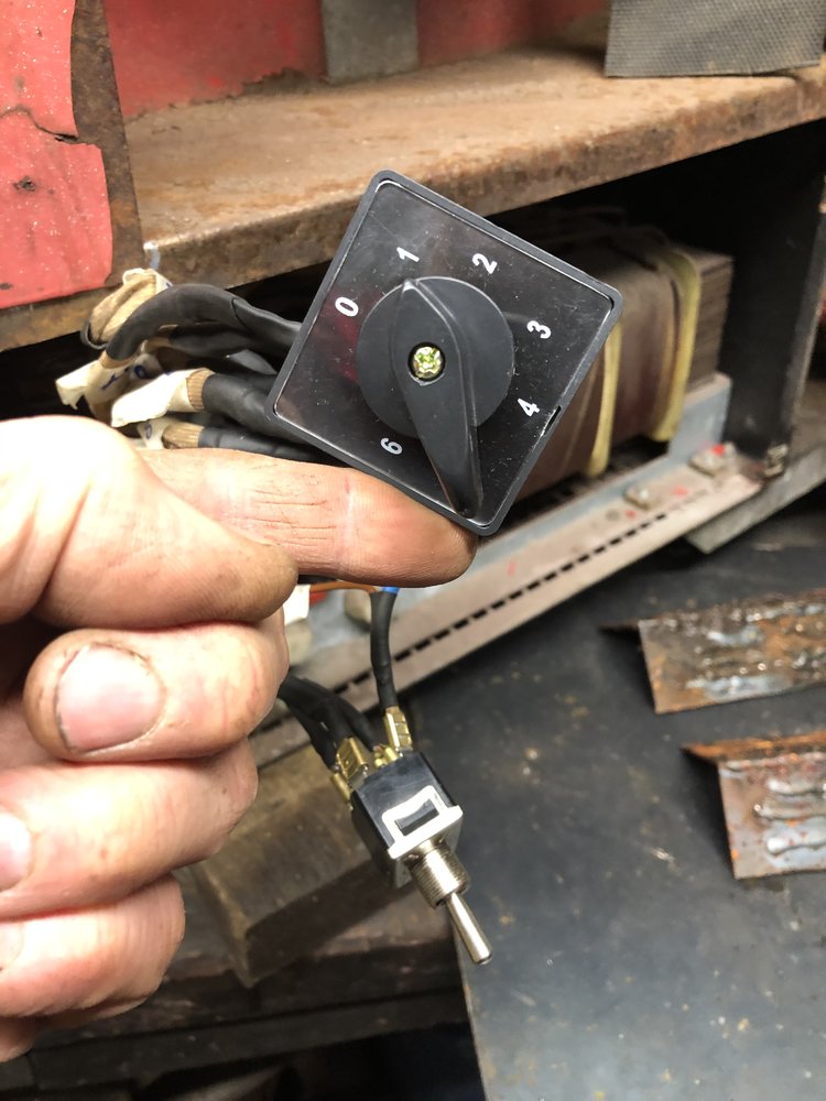

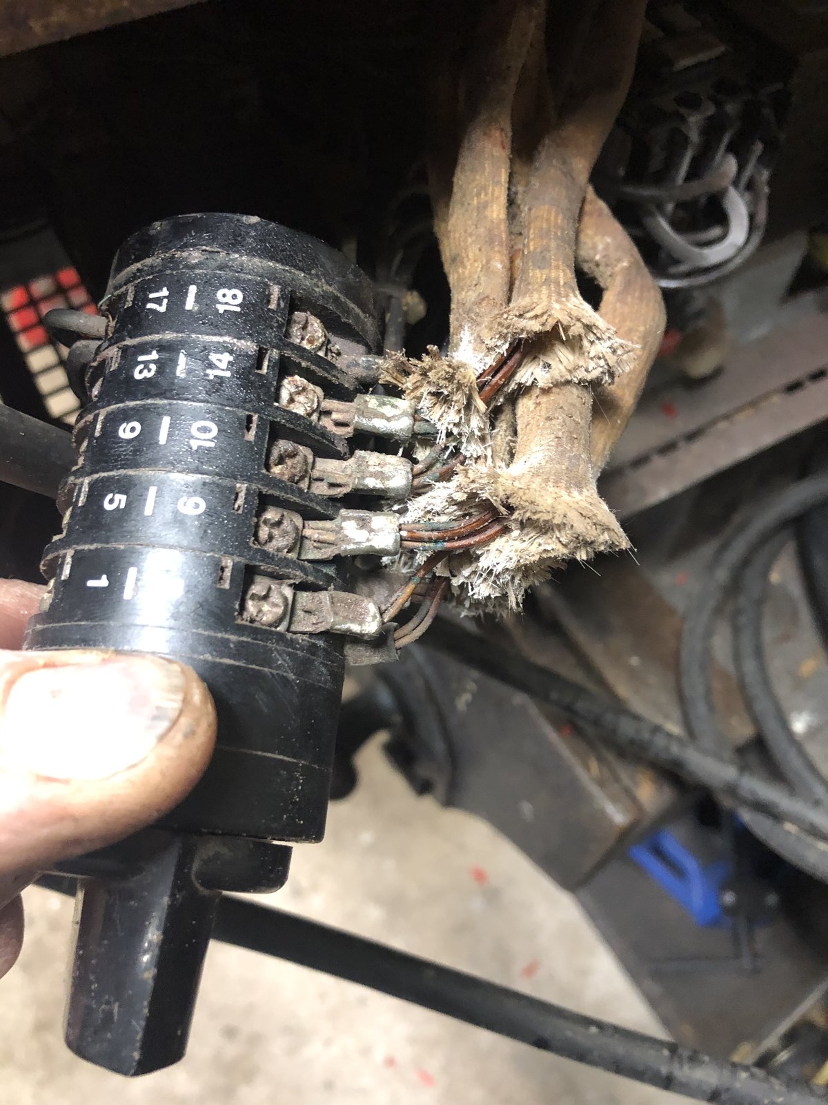

The other thing we've noticed is that the first three settings on the weld current (voltage?) switch don't provide any output (i.e. no wire feed). I think it's been like this for sometime and is not a huge issue given he's mostly been using it for chassis rather than bodywork repairs.
Before looking any deeper, I thought I'd get your thoughts here. I'm also wondering whether the 'stuttering' is possibly the the Contactor tripping in and out under load. Finally, does anyone have a circuit diagram for this machine? I've downloaded the manual for it from the ESAB website.
