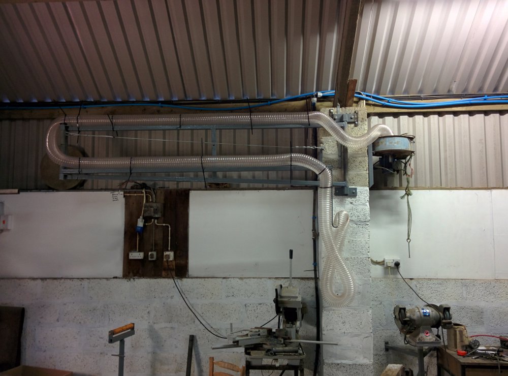

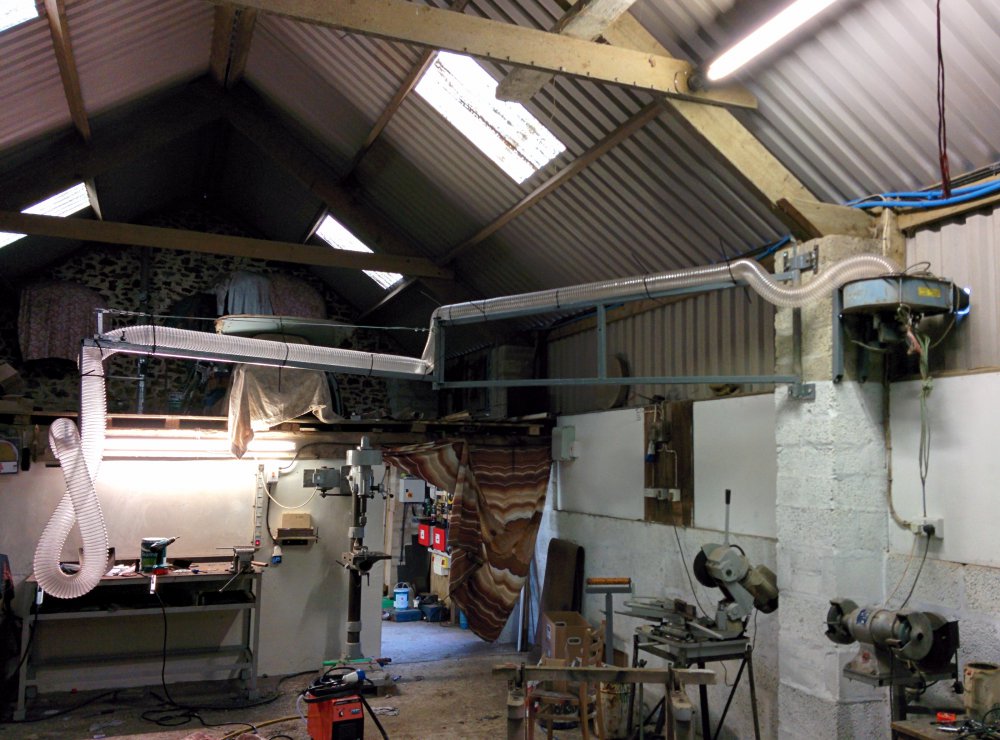

Looked into making some kind of anglepoise system with counterweights but decided this would be simpler and easier.
Fan+ motor from an old corn cleaner. I was looking at a 6 inch output bore squirrel cage one I have but decided the 1.5hp motor on it would be overkill. Rescued scrap 1.5inch box, 4" hose £55 from ebay. A couple 4" drain fittings at about a tenner each and a lick of paint to make it look slightly more legit. Could've managed with 6m of flex and either bolted some solid pipe to the larger frame or made a steel tube part of the design. It's a bit wobbly when the forearm is perpendicular as you might imagine but is strong enough. Might even put a power point or airline on there one day
