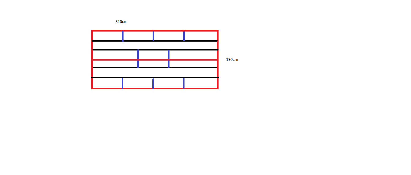

Hey everyone, first post here, looks like ye have a wealth of info in this forum!
I need to fabricate a stillage at work to be able to load a piece of machinery onto an artic trailer. Its a small self propelled machine on 4 wheels, weighing about 1.5tons. Im not a professional welder by any means, but having worked with agricultural machinery all my life im a pretty confident welder with arc and mig, and have recently dived into the world of tig.
Anyway, Its going to be a straight flat rectangular frame (no need for folding ramps). It will measure 190cm x 310cm. I was planning to use 80x40x5 hollow section steel.
View media item 9077
The plan attached shows how it will look as you are looking down on it. Red is the bare frame, black will be tracks for the wheels and blue is for support bars welded in for rigidity. All will be made from the 80x40. My questions are do ye think this frame will support 1.5t? It will be loaded with a forklift, wil be welding 2 more runs of rhs underneath for the forks and also 4 corner legs to keep it steady while loading.
What welding set up would ye recommend? I personally would prefer to arc weld it as im more comfortable arc welding. Would 3.2mm rods do this? Plan on welding the joints all the way around.
Like i said, im not a professional fabricator, so please feel free to throw any advice/comments my way!
Thanks, Brian.
