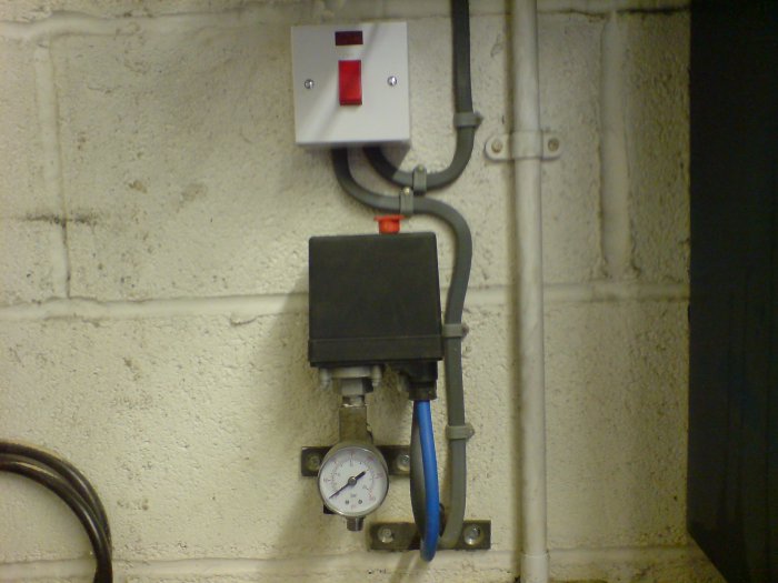

I have a brand new 14 60 3 hp clarke compressor donated by my company after 25 years of servitude. I want to operate it remotely, it's mounted on a mezzine surrounded by 100mm of insulation to cutdown it's 97 decibels of deafening.
I don't want to climb up and remove insulation every time for shutdown. I've considered the possibilty of removing the entire switch assembly and moving it down, which would involve new plumbing and electricary.
An alternative idea is to fit a solenoid to operate the switch, there can't an off the shelf unit. Ideas please

i sumetimes leave mine full after it has unloaded
i burnt a motor out on one of em last year the presure switch stuck and it ran for hours during the night blowing the safety valve
