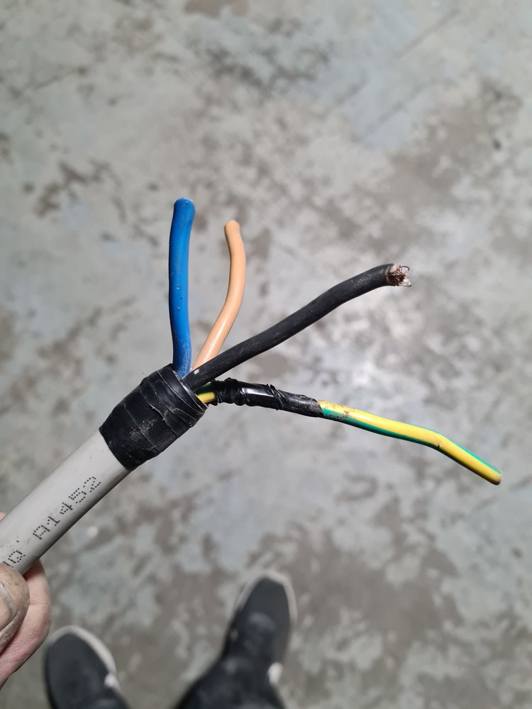

Wired itJust wire in on the 3phases, if it spins in the wrong rotation swap over 2 phases
Swap any 2 phases, it doesn’t matter which ones .Wired it
(BrownL1,BlackL2,BlueL3) and it ran in reverse, which 2 phases would I need to swap? Unsure weather it's star or delta either, or if that even makes a difference
Thanks, will give it a try in the amSwap any 2 phases, it doesn’t matter which ones .

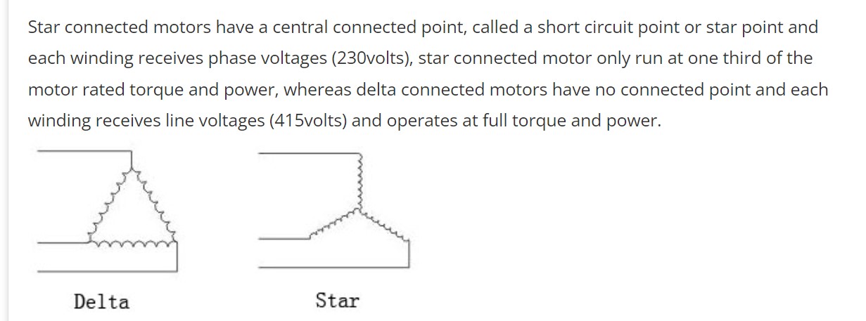

As it is 3wire without a neutral it is delta.
No 3 phase motors require a neutral - it’s 10hp so it may well be star/delta for startingIt ran without a neutral connection, makes it delta!No 3 phase motors require a neutral - it’s 10hp so it may well be star/delta for starting
I fear you are confusing a transformer connection and a motor connection. Just for clarity - a 3 phase motor whether star or delta does NOT need a neutral so the lack of neutral is no way to identify how the motor should be connected - you can only determine that from the data plate and supply voltage.From the system perspective if there is no neutral it is a delta connected load as there can be no neutral current.
3phase balanced loads have no neutral current whether they have a neutral connection or not is irrelevant. Just removing a neutral will not magically balance a load.3phase balanced loads do not have a neutral
Probably easier if you show us a picture of a 3 phase motor with a neutral connection…I’ve never seen one but am happy to be corrected.3phase balanced loads have no neutral current whether they have a neutral connection or not is irrelevant. Just removing a neutral will not magically balance a load.
