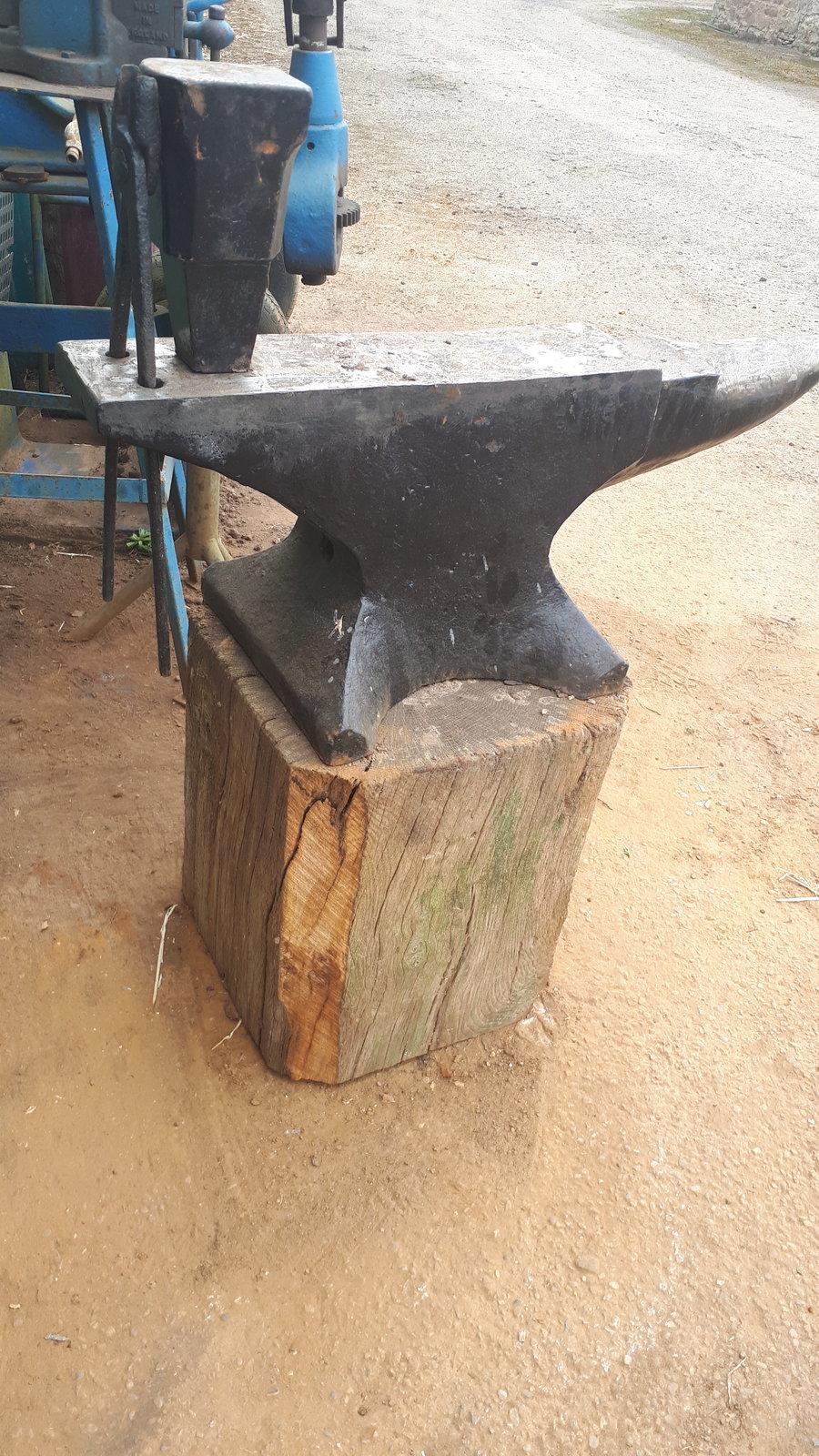

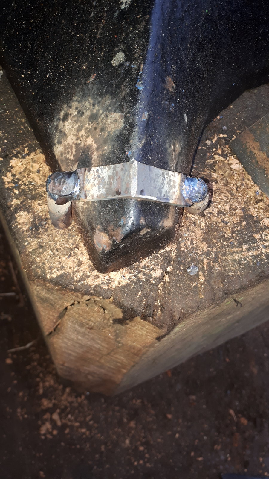

got round to cutting the oak block for my anvil today been sitting around for about 10 years brackets to make next
Nice anvil is the top face original
i repaired the edges but top is untouched
slightly hollowed , it came out a horse cart workshop about 240 pounds weight
have a lot of tinsmiths stakes that fit the hardy hole

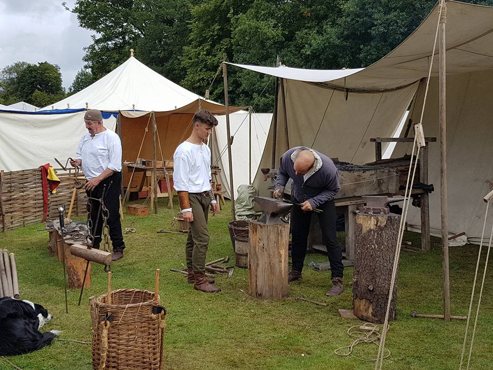

How the other half live eh, Andy?
Two pritchel holes - how extravagant!

Where do they grow square trees?....

do you think elm wood be more suitableNice block of wood, may pay to band it before one of those shakes makes it into two lumps of wood
