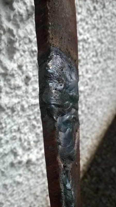

Hey all you MMA peeps I'm normally very at home in happy quiet TIG land but I needed to fill a join I'd done in some 6mm MS and the deposition rate of MMA allured me
So, machine is DC inverter running at 85A with 110V open circuit, 240V supply. Rods thus:

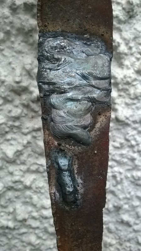

So I've done precisely 6" of MMA welding in my life, hence the ish. Here's my attempts on a bit of rusty 6mm as before. I'm trying to put a 1 - 2mm layer on top as the joint is already soundly fused from the TIG.

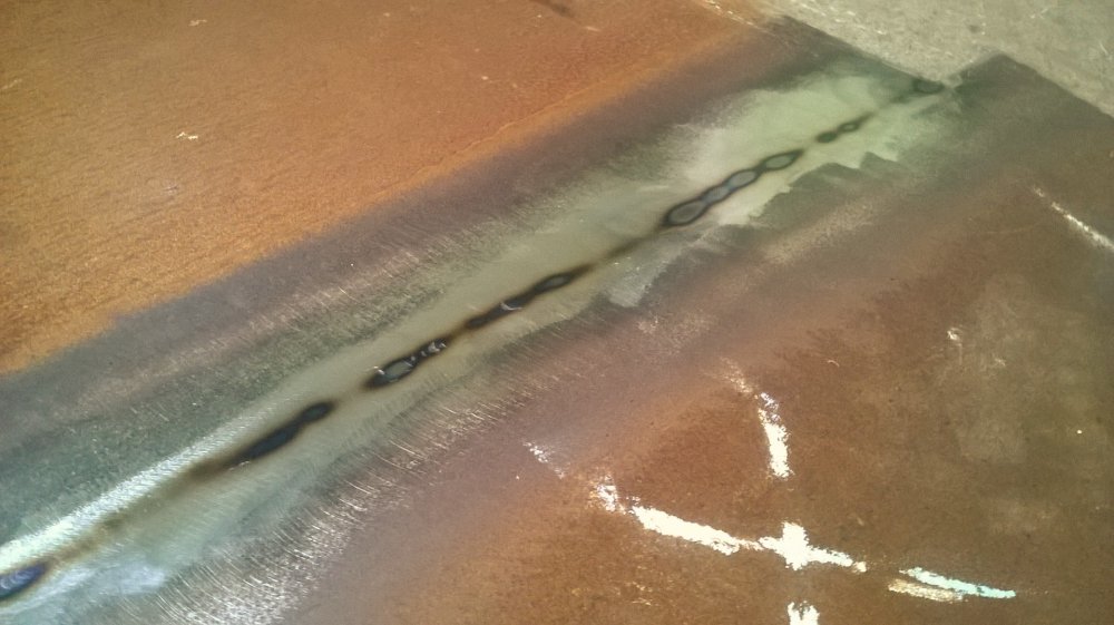

After I was happy (enough - hah!) with them I proceeded to do my job. Here's the start, a TIG joined bit of plate. Joint is ~450mm long. The right hand side needs about twice the fill of the left.

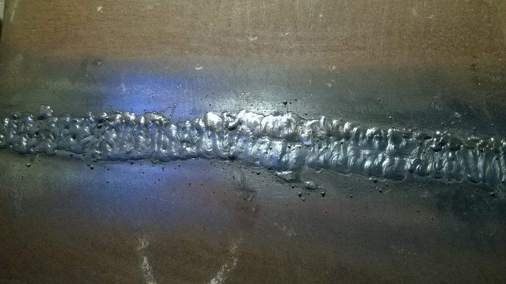

Here's the well fubared TIG join (it's had a meeting with Mr Concrete and Mr BFH to straighten it) on the other side. I'll be capping it.

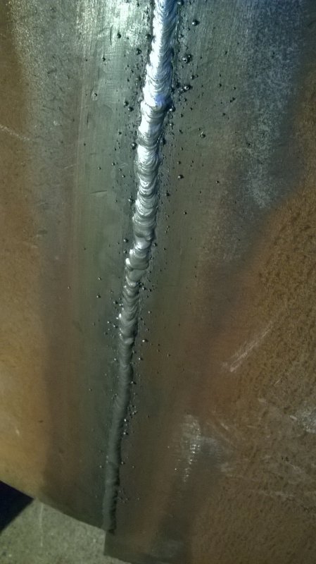

So here you go, for your delectation.

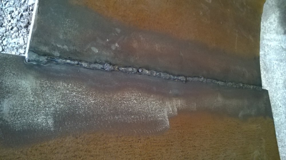

The capping on the rear.
Overall I'm happy enough with it, I know I could do better with practice and possibly larger rods would be easier, but for my first real "go" I'm happy with that.
I await your crushing blows to my inner soul. Sorry, constructive criticisms
