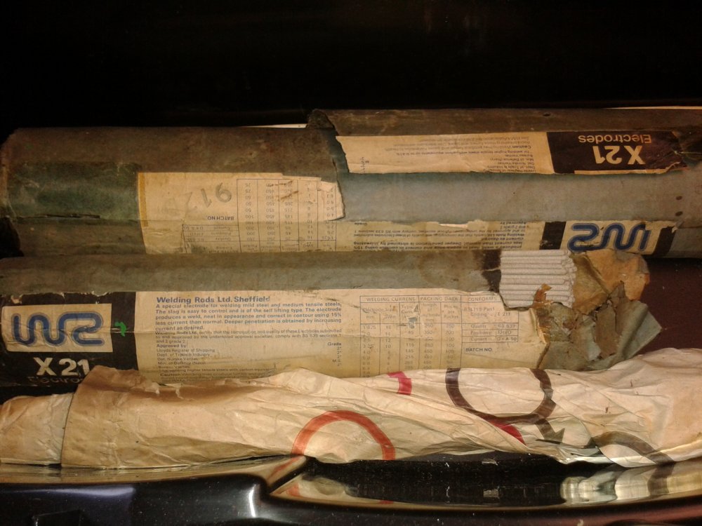

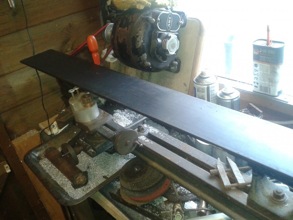

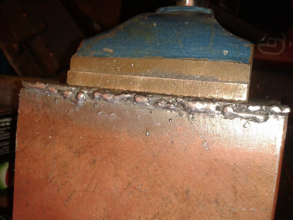

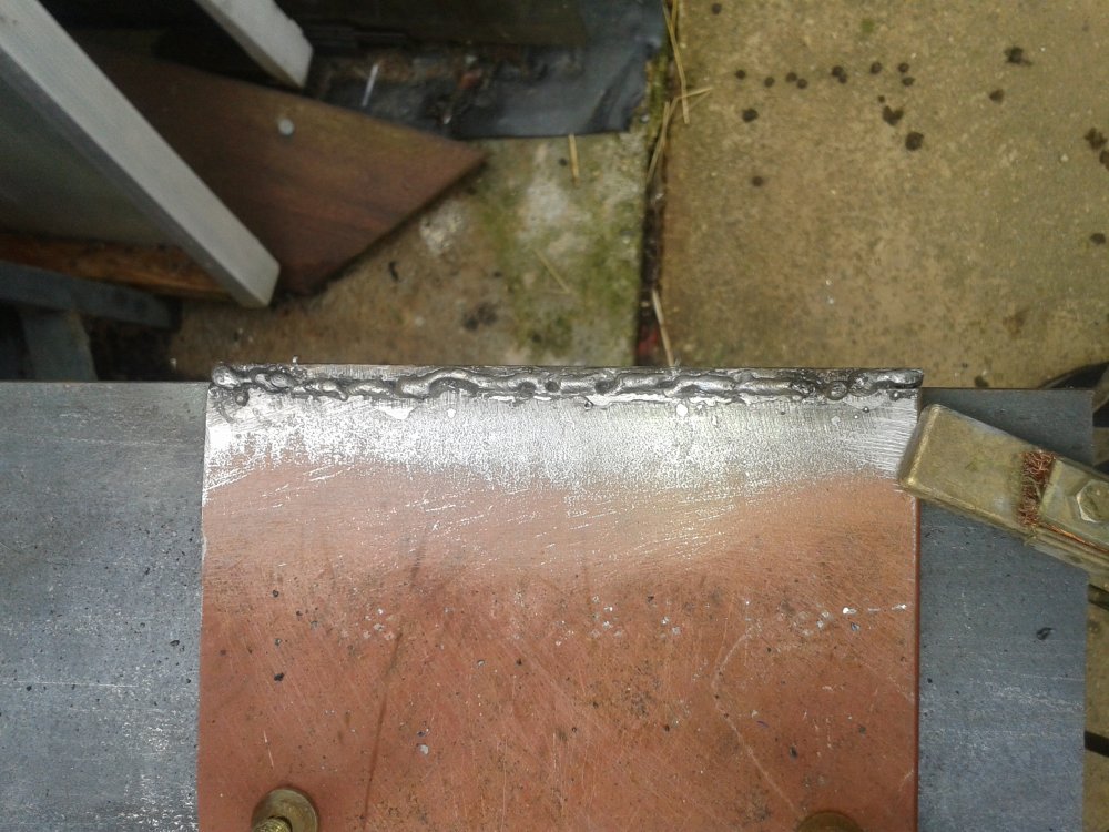

Having only had a go making a melted mess to prove my welder worked I haven't had any cause to give it a proper go untill today. I have a very old lathe with only a compound slide which you have to move up and down the bed on a T slot so I have been collecting parts since finding out about Gingery lathes to make a sliding bed on that principle. So out with the sticks and the results are...
This is the best bit done last

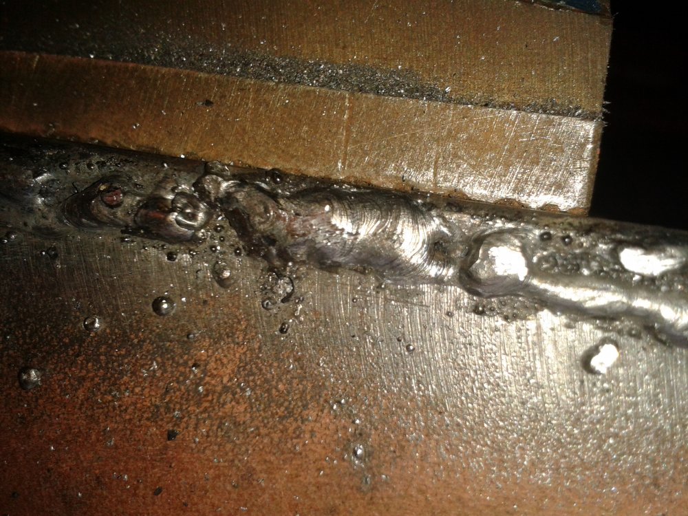

This what should be a bead and will get ground back for another pass.

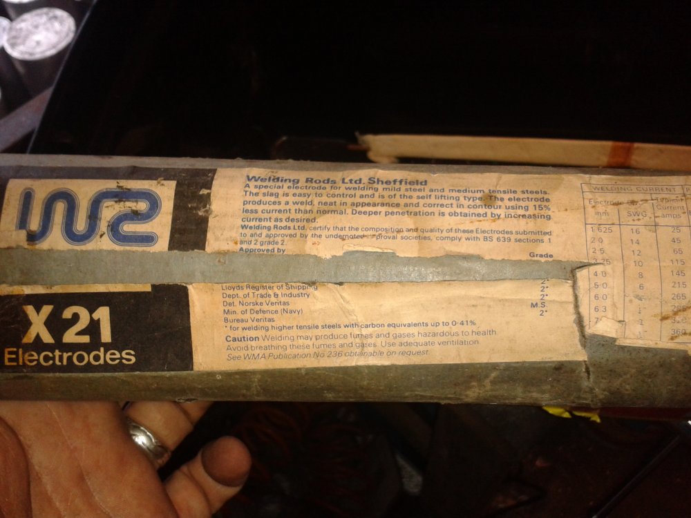

I think I should have read the packet on the rods better I had the amps way to high as I was struggling to get it started using the strike method (constant sticking) but did find I had better results with a tap start and probably should had cut a rod in half for my first go just to add a little control when not used to it and as it got shorter I found I got more used to the speed of burn and what my travel speed should be like.
These are the rods that came with the set.
Any thoughts or suggestions (I have read through the guide)
