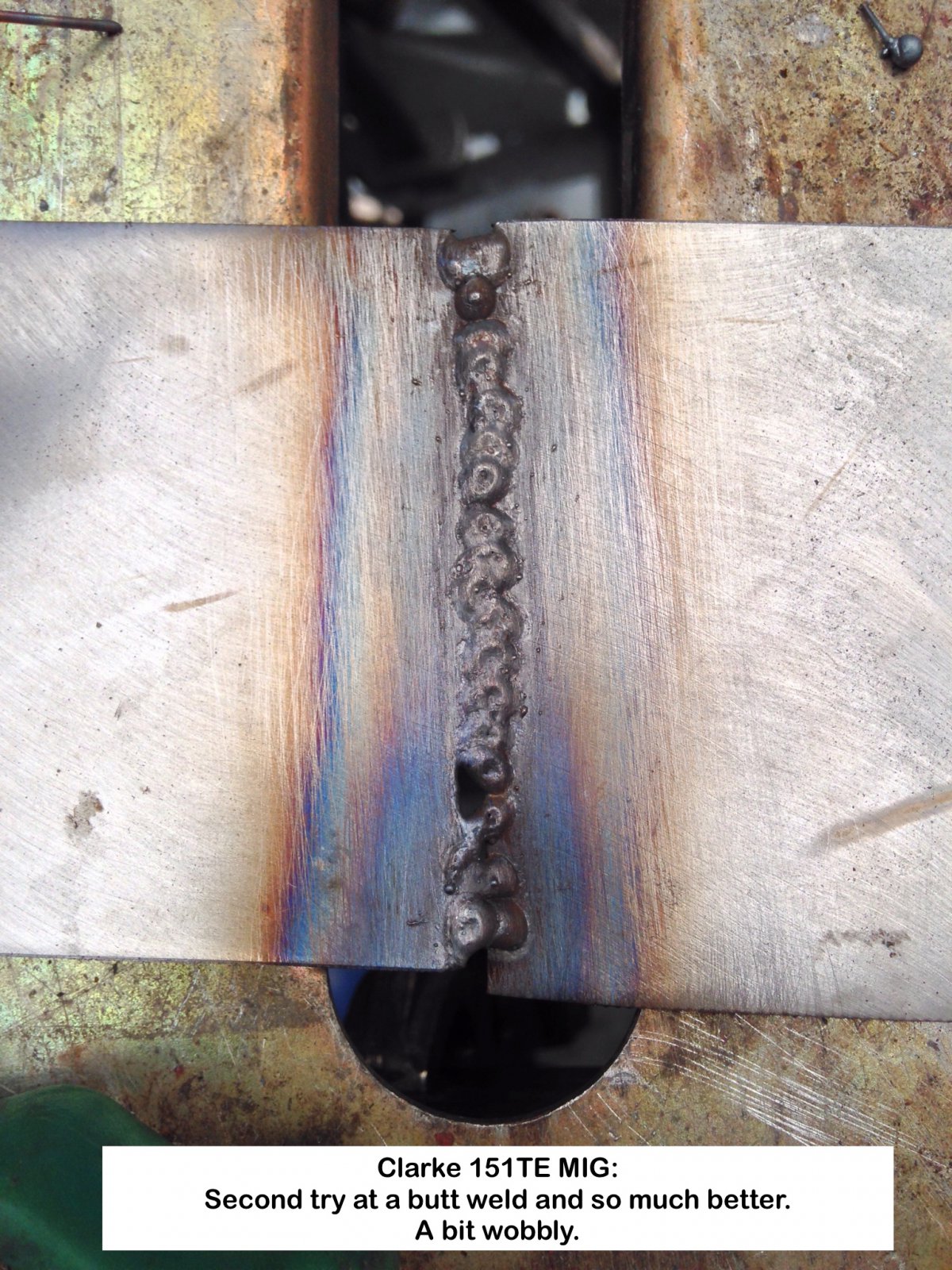

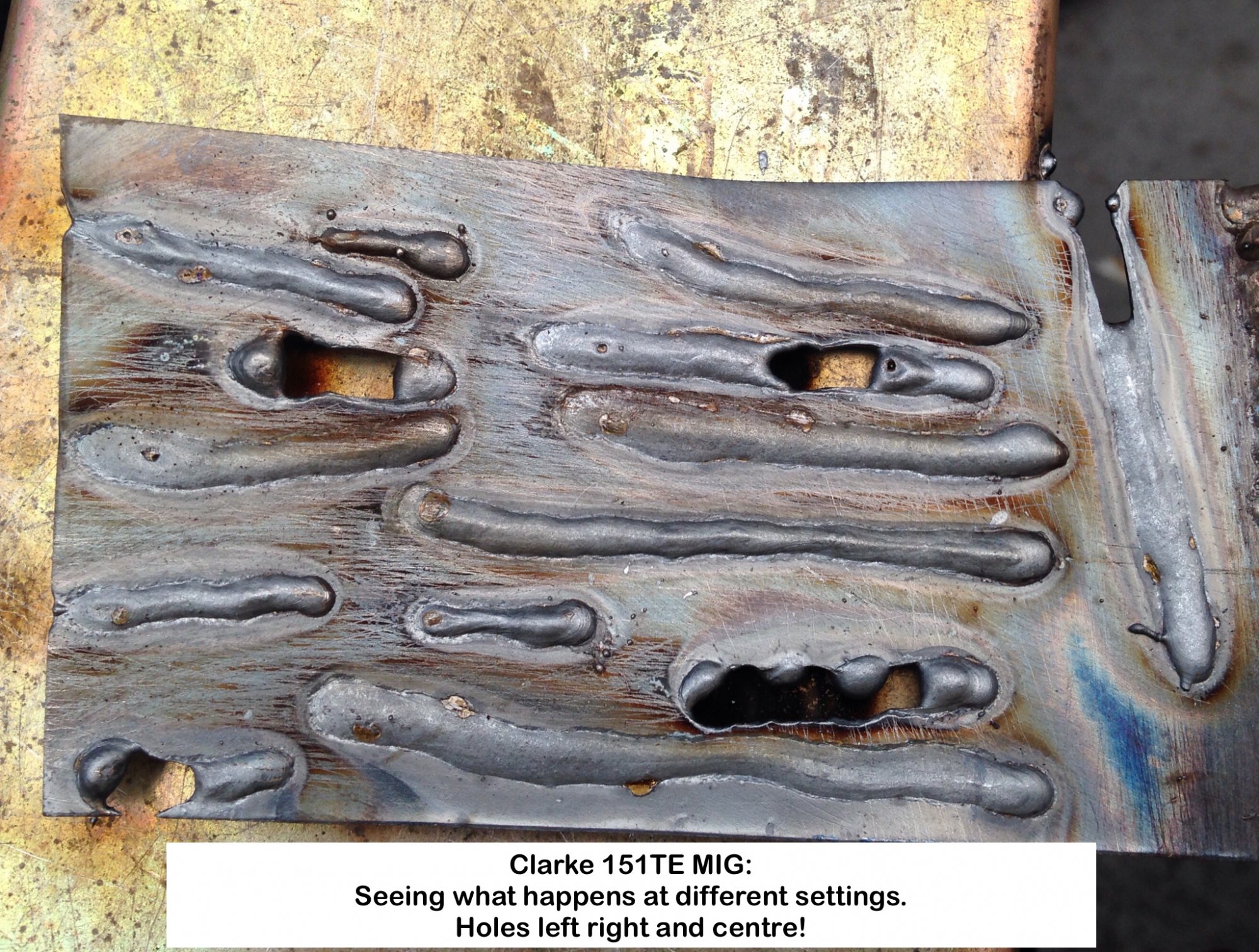

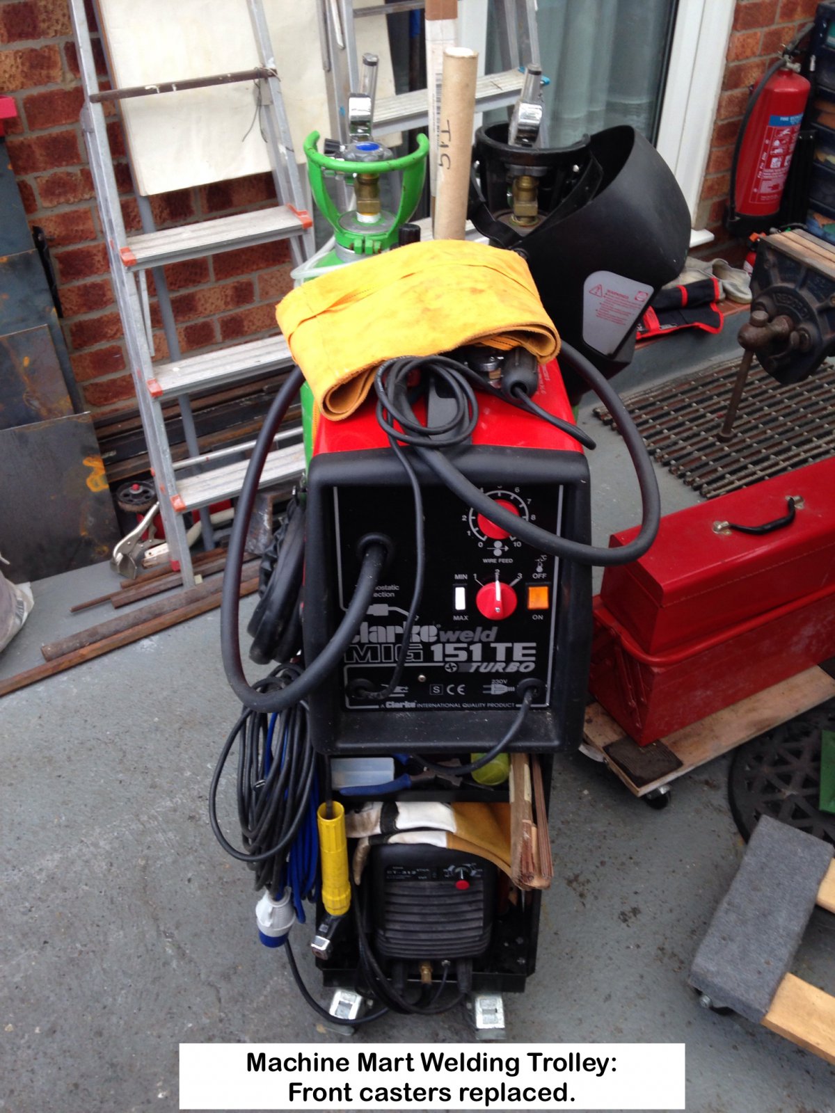

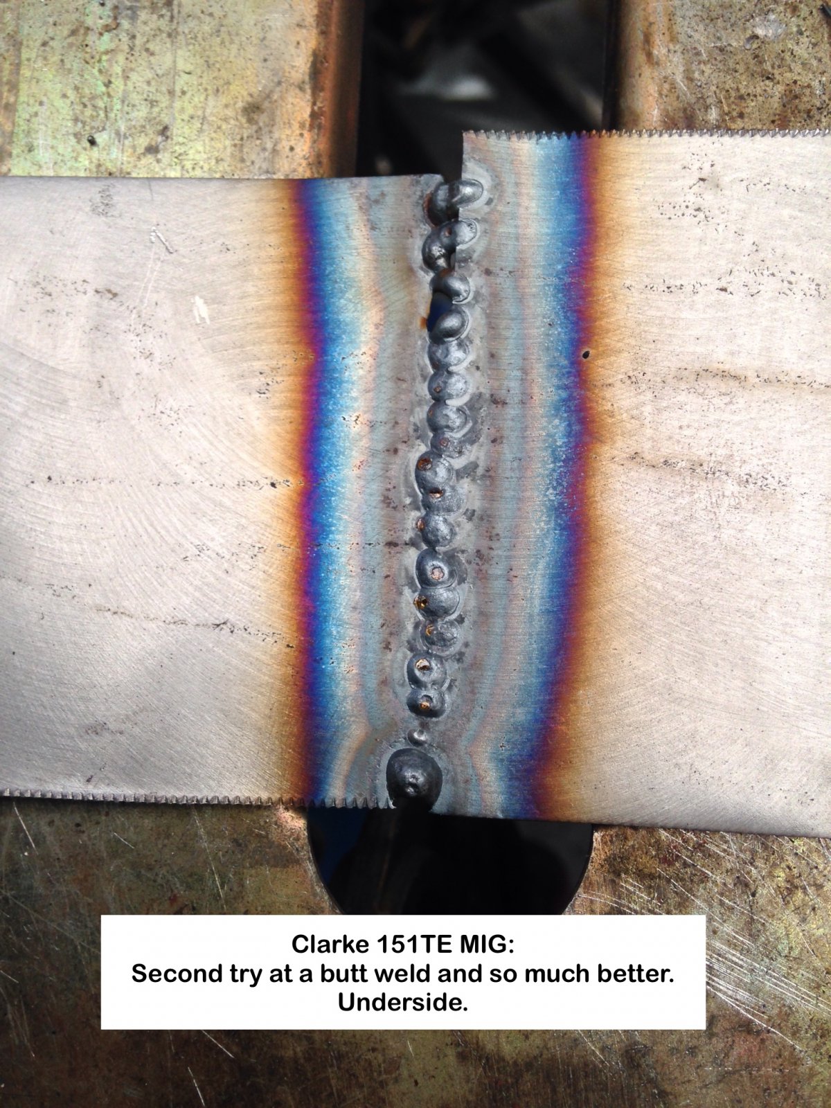

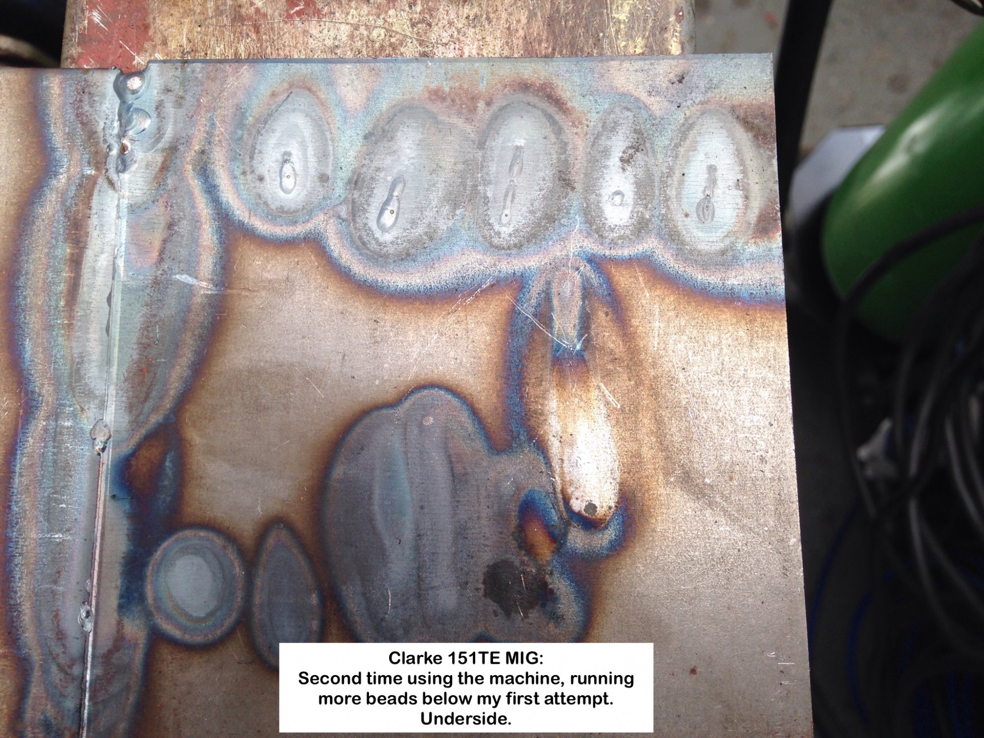

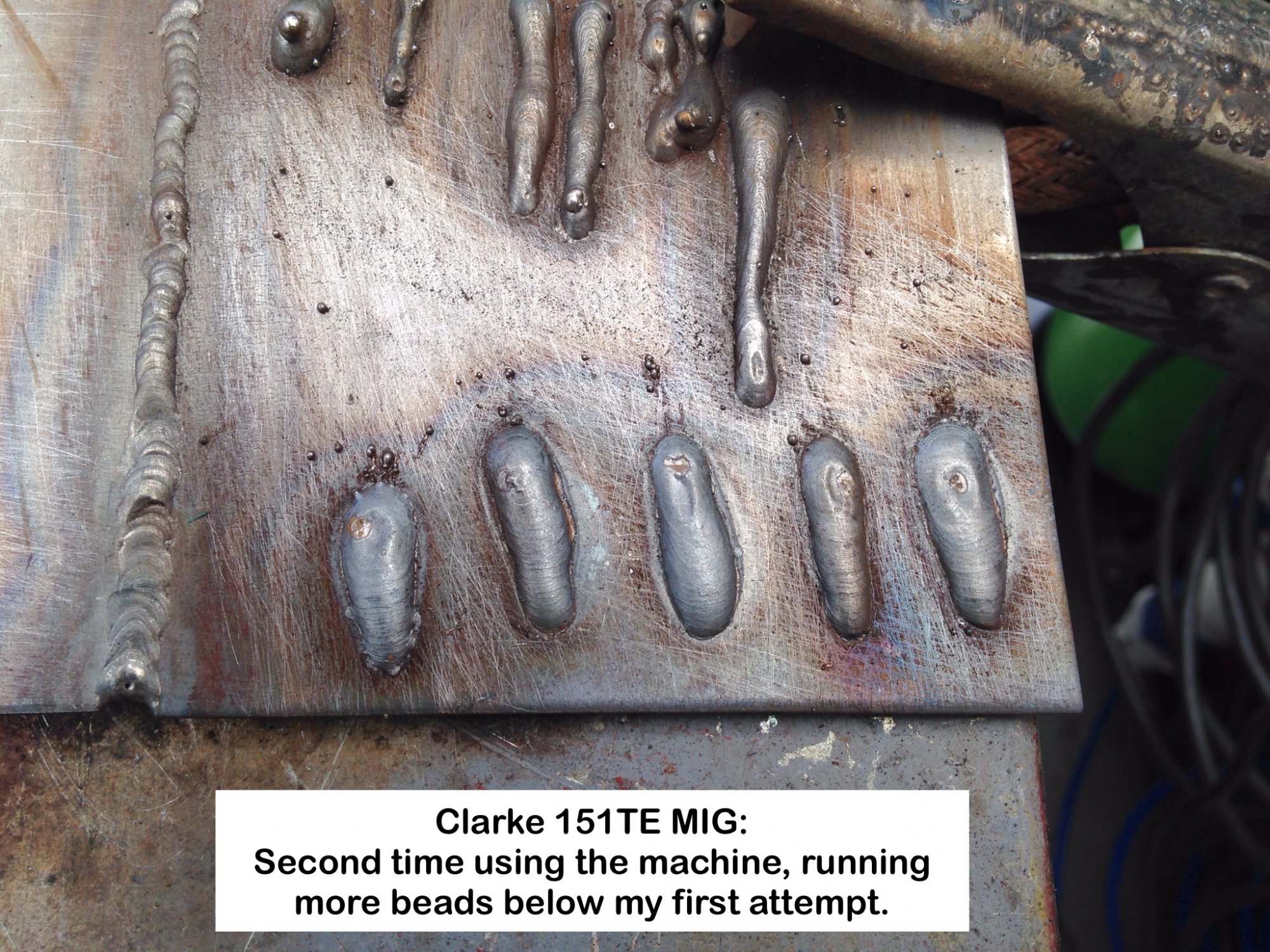

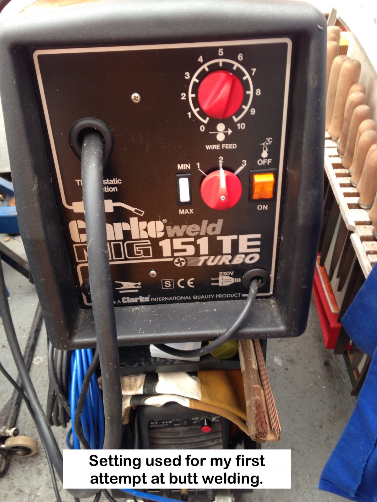

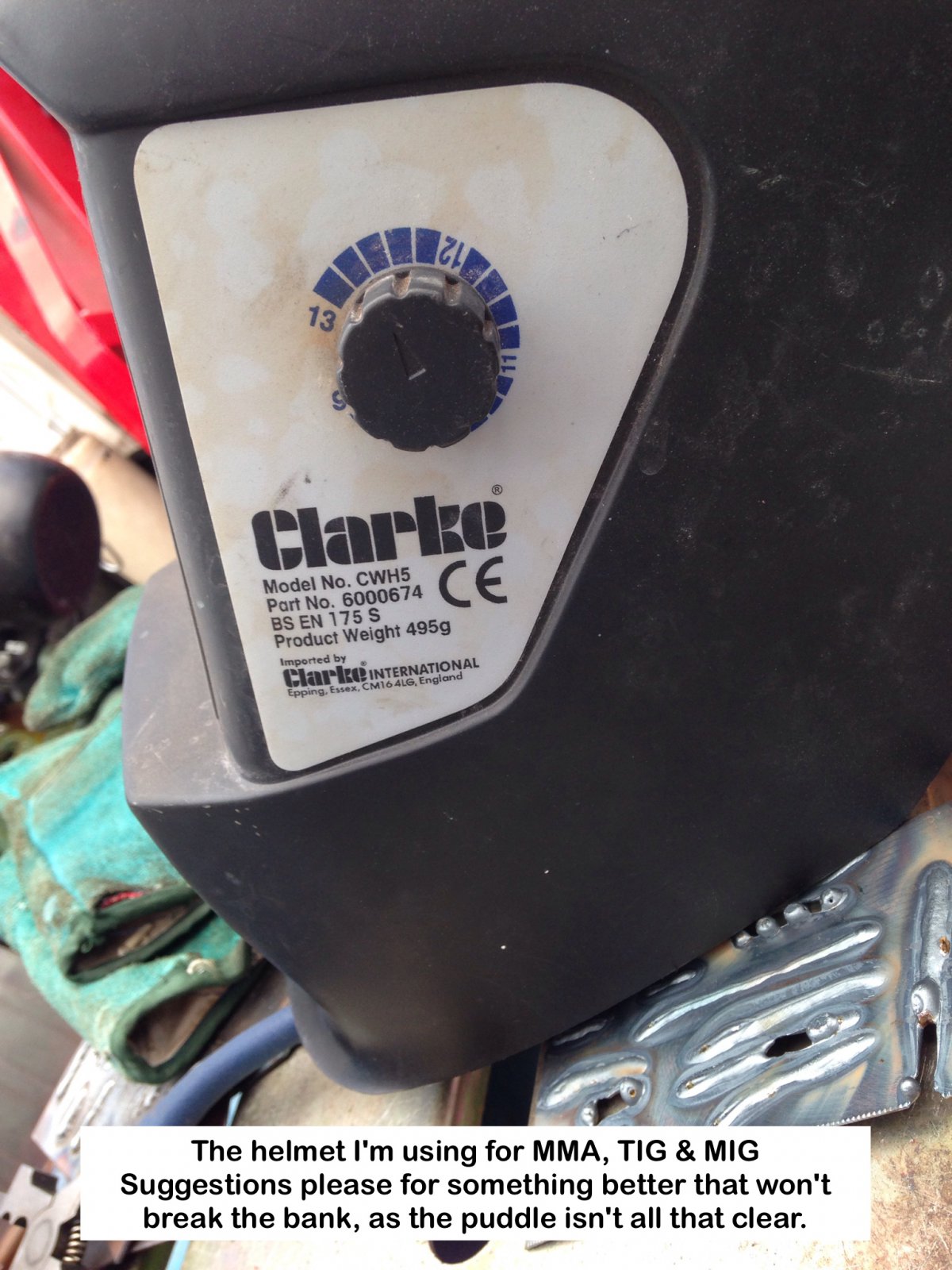

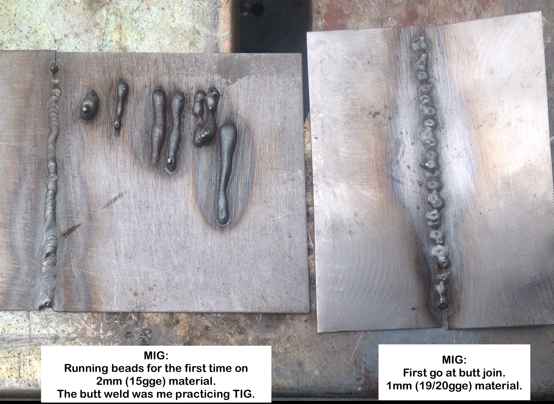

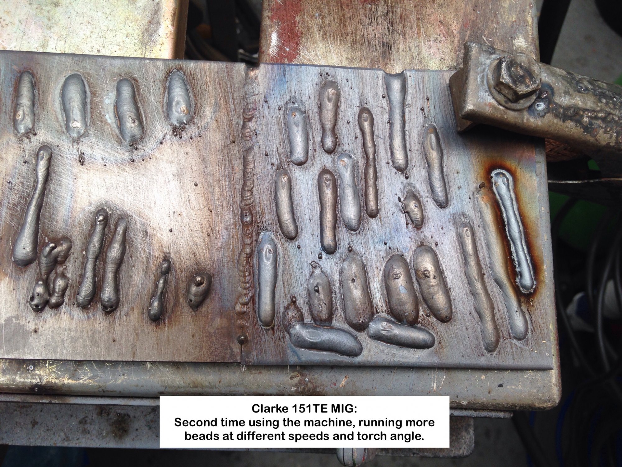

Thoughts on my first attempt please.
Welding aimed at renovating my 1935 Austin Seven Ruby ARQ.
I'm an O/A guy, but the usery prices mean it is a non-starter, otherwise I'd have finished the welding by now.
Did these beads yesterday after setting everything up, and now see why MIG is so popular.
My other machine is a ubiquitous CT-312, with my gas welding experience helping me with the TIG BUT I haven't yet mastered the 'Do not dip'. O/A is a doddle in comparison.
This machine has transformed my stick welding out of all proportions compared to the old xformer ones.
I'm pretty pleased for a first try, but would appreciate any comments/suggestions/brickbats et al.
Wire is 0.6mm (22g) as supplied with the machine.
The machine was purchased years ago, but fate/nature stepped in in the form of Big C, so that threw a spanner into the works, meaning that I have only now got round to using it.
Had to remove the cover to re-seat all the spade connectors as the feed motor was dead.
My profession was in the electrical industry - 500v to 11Kv, now retired.
![image.jpeg image.jpeg](https://www.mig-welding.co.uk/forum/data/attachments/85/85385-cda8f9faed4347210b6444fc0c93e754.jpg)

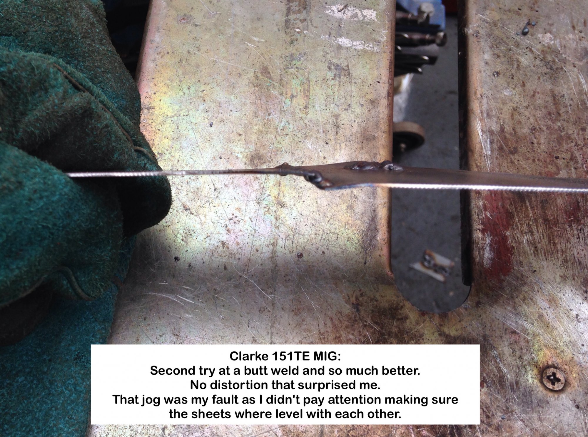

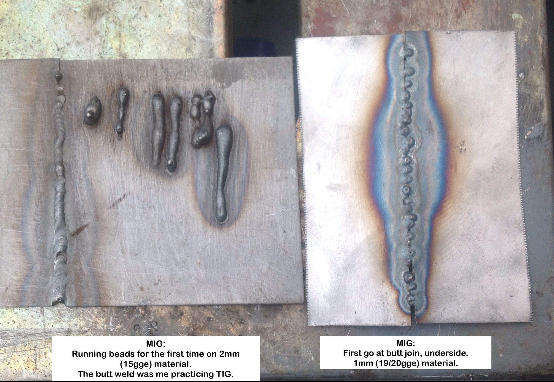

The butt weld was a series of spot welds, just to try.
Will try welding splits in body parts tomorrow.
