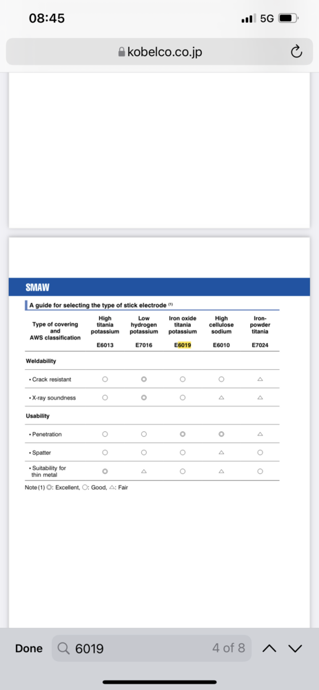

The iron oxide part, in the sheet below, is only noted as a coating rather than a main constiuent. Maybe it is used like a varnish, a thin skin to protect the iron powder from itself oxidizing (rusting). One of the sheets below says the electrode is OK for rusty or primer-coated materilals, and that the slag is self-releasing, so maybe the iron oxide helps with these two properties.

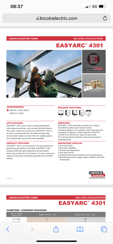

It's a type of coating, not too unlike a rutile coating to run. Ilmenite coating they call it, ilmenite is a mineral (compound?) found in the earth which is commonly used to make titanium dioxide (white pigment in paints etc etc).
Russians came up with it I believe. Don't think I've ever seen an 6019 here.
I don't know the mechanism of action, it's certainly not described in any esab or Lincoln literature I have. It also doesn't appear in Science and practice of welding.
Googling it; it seems to be a low cost electrode.
However it also says that additions of lanthanum and cerium are needed to improve mechanical properties. They're rare earth metals so not cheap.
It's likely that the disadvantages outweigh the advantages and it never made it commercially. The Russians like doing things different just because they've got the raw materials at hand. Didn't work out so well for their titanium subs either.
Thanks for the responses. I have done a bit more research and I think I have some satisfactory answers. Brad93 has mentioned some in his responses, The question was asked regarding MMA but the same applies to flux core wire - both gas shielded and self-shielded.

The extruded electrodes with rutile, iron oxide and silicate coatings do not pick up so much moisture from the atmosphere and function quite well with a small absorbed content.
Improved penetration (depth of fusion) with the addition of reactive oxygen.
