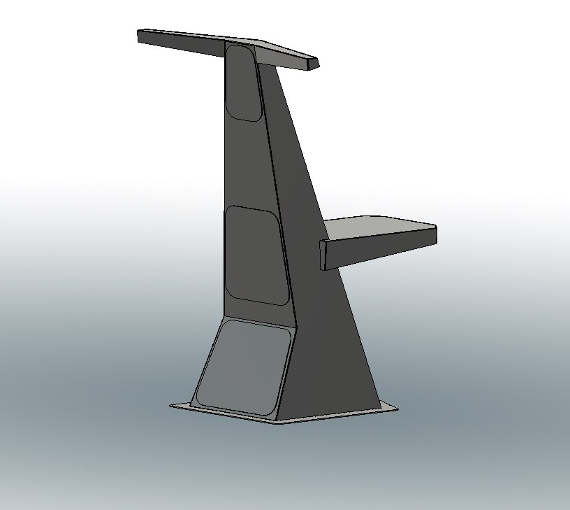

You can make a sketch and use that as the material which is very handy for odd shaped pieces of material left over from other jobs but you can only use one sketch so with something like the mast I am about to make it was a pain as it will need 3 sheets of 2500 x 1250mm aluminium.

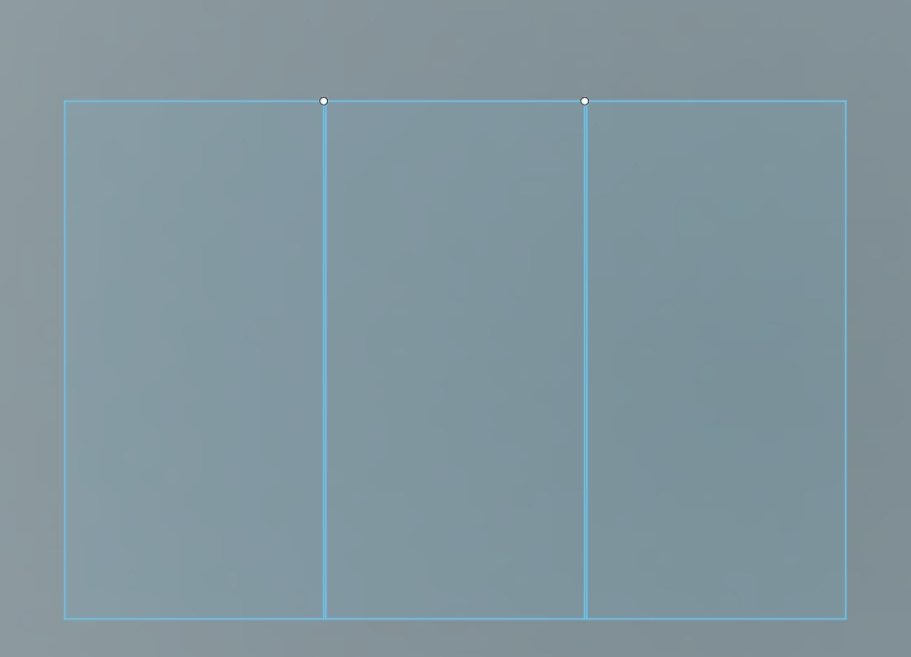

So I had a wee think, what if I sketched this.

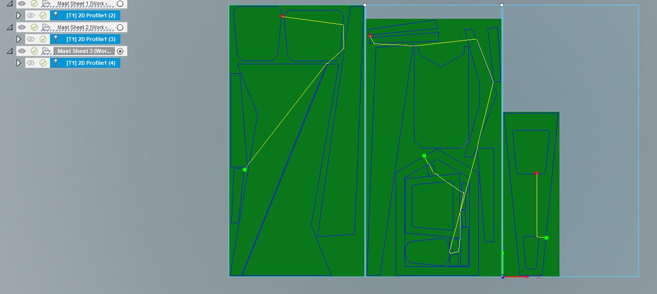

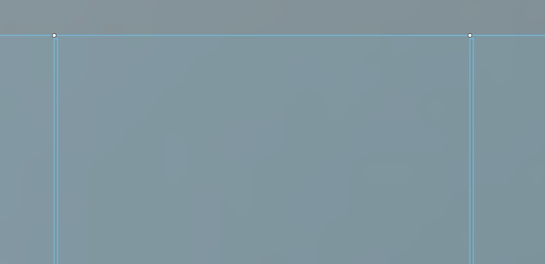

3 sheets side by side but with a difference, they are all joined by a small tab at the top basically making it one sheet but the tab bit is smaller than the spacing I have set in the arrange feature so nothing can be placed near it.

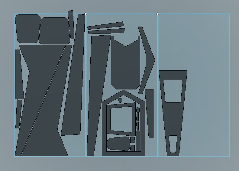

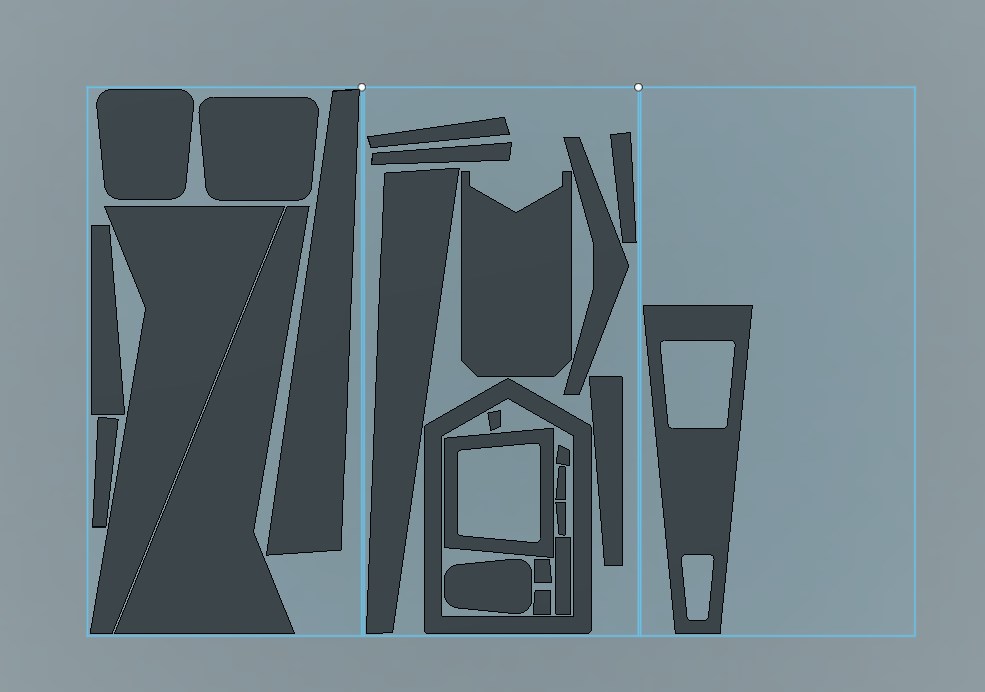

Result. Arrange now sets the parts out over the 3 sheets and I am happy as it will save a lot of time for me especially if I am trying to do it while people are in the workshop yapping away to me
I can now do a setup for each sheet and produce code for each sheet. It will be a massive time saver and hopefully may help someone else if they have the same issue.
