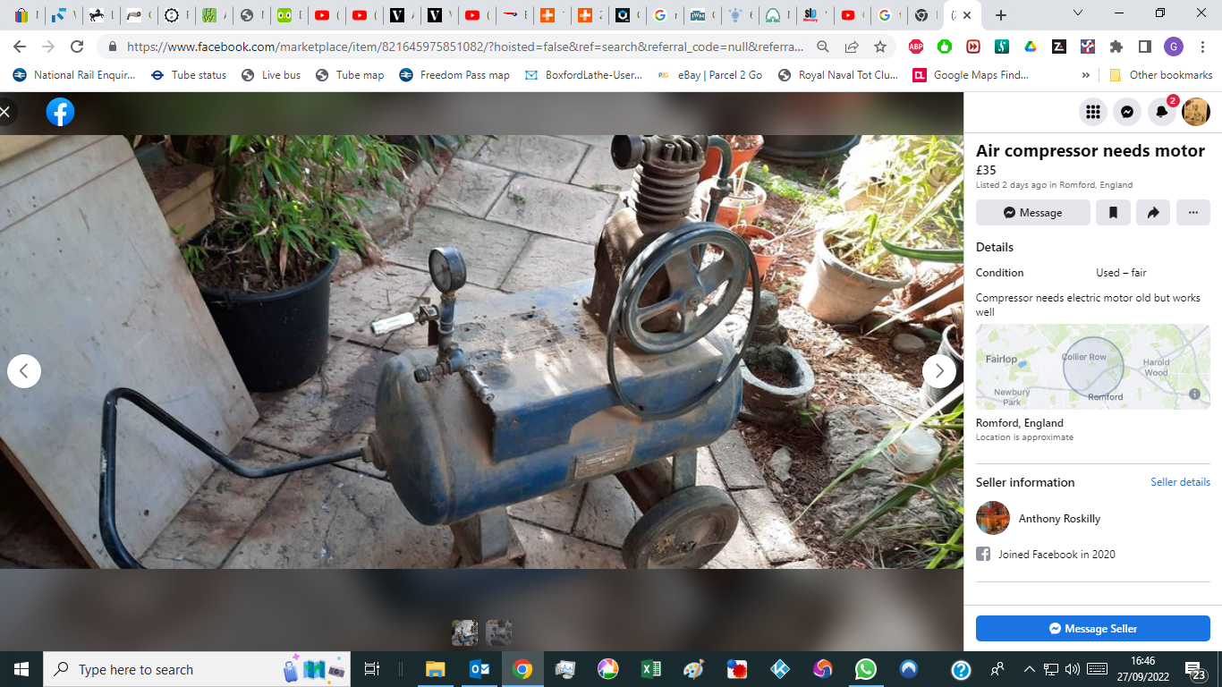

will cost me 80 quid in fuel to drop it off
