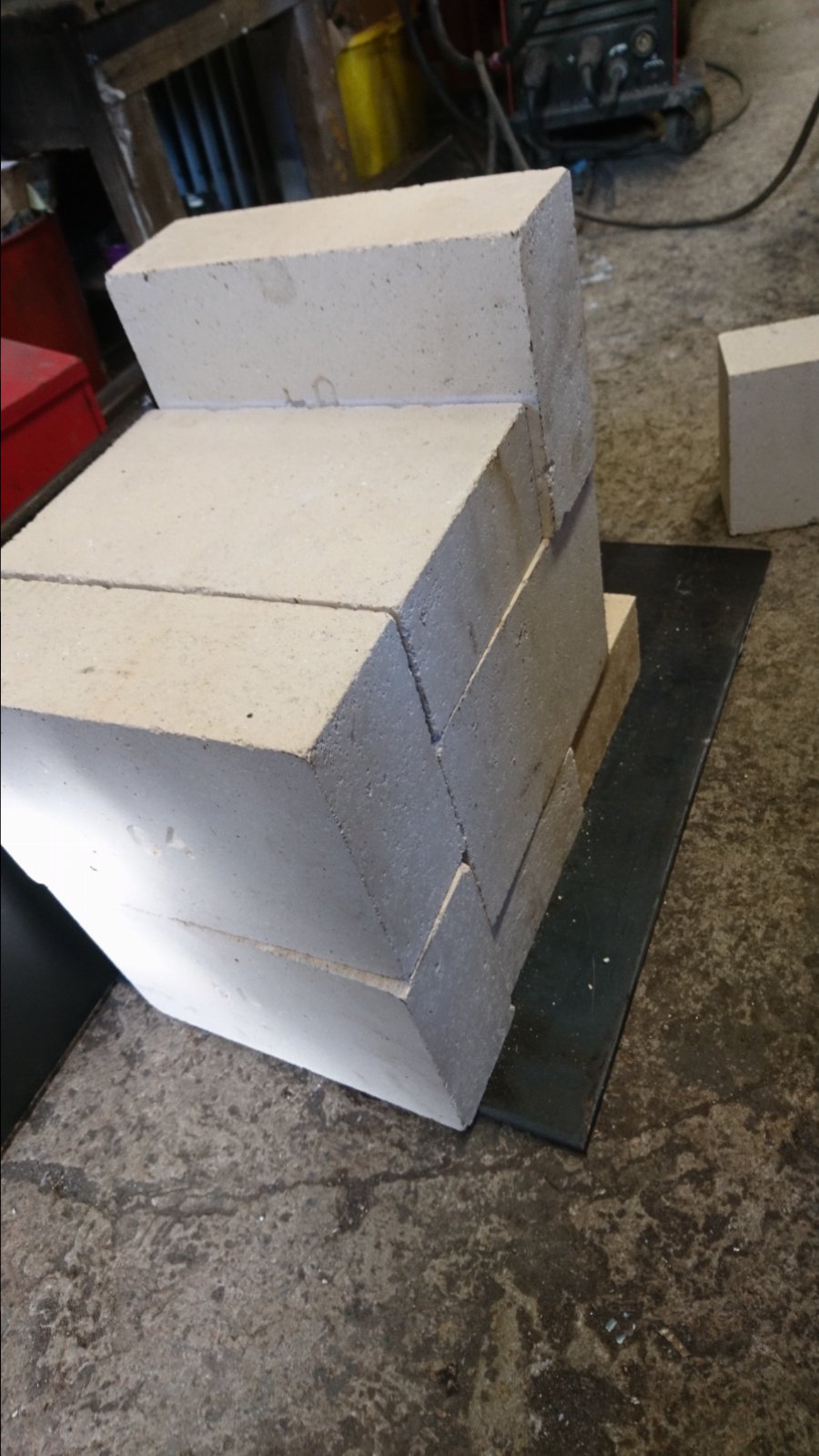

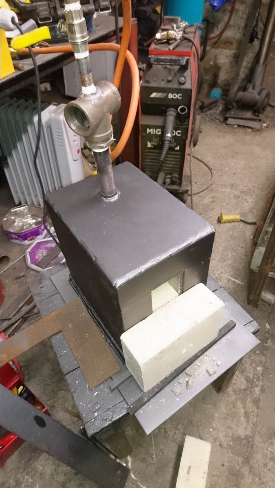

Built this forge today 42 grade alumina brick lined with 6 mm plate casing. Had the burner bits for many months awaiting a start and just rediscovered them last week.

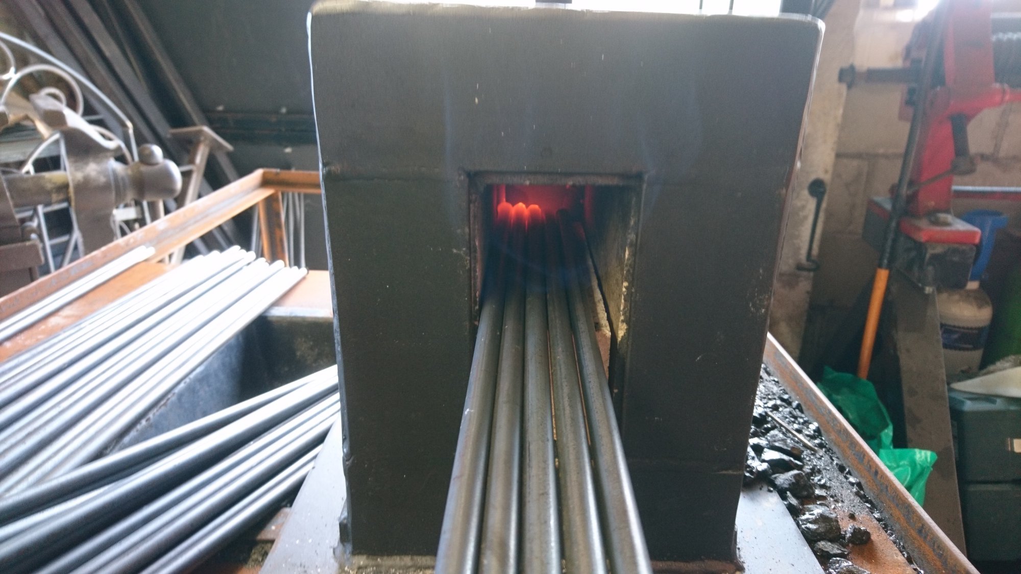

With 160 spindles to fish tail and scroll I thought it was time for action.

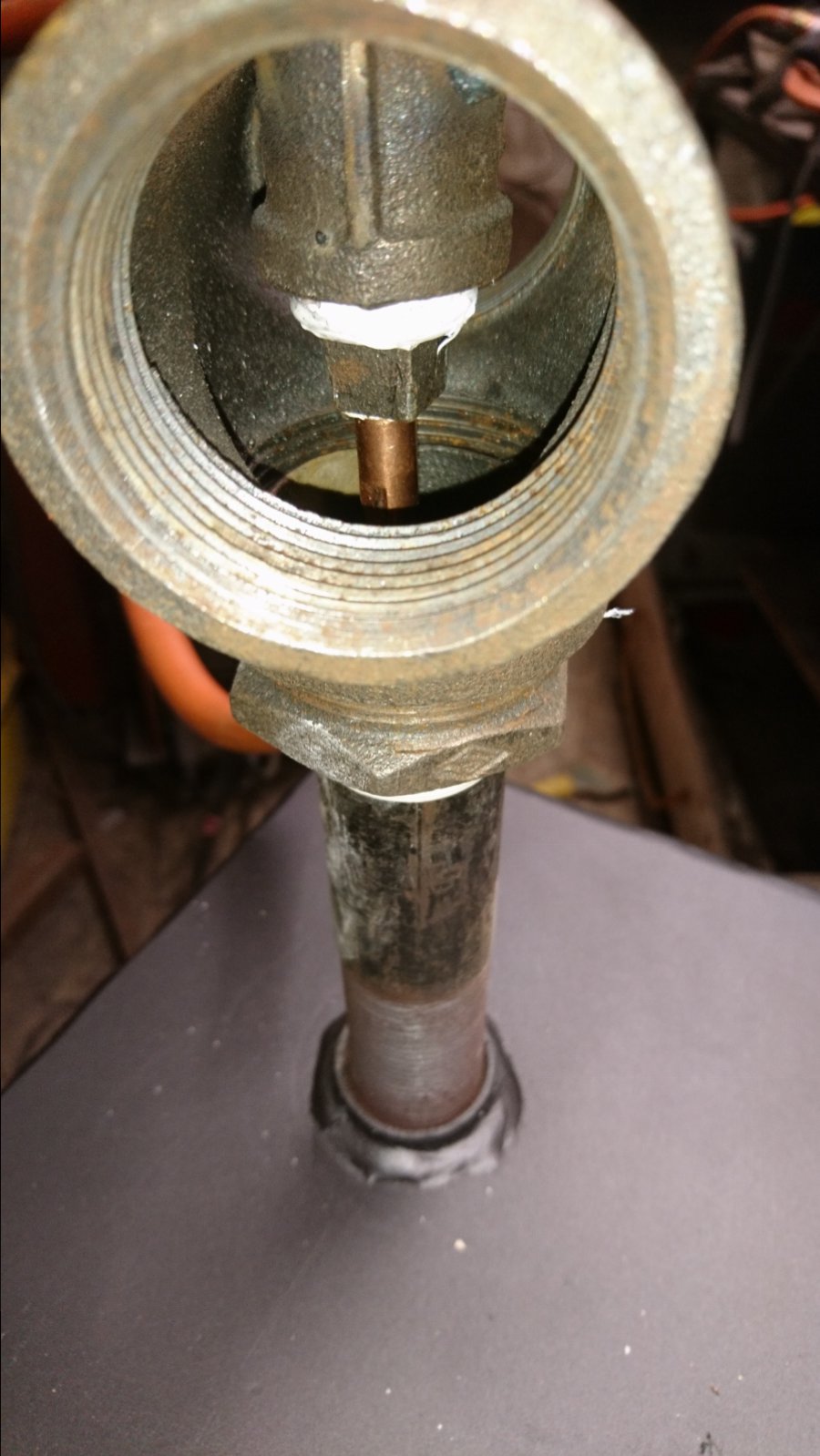

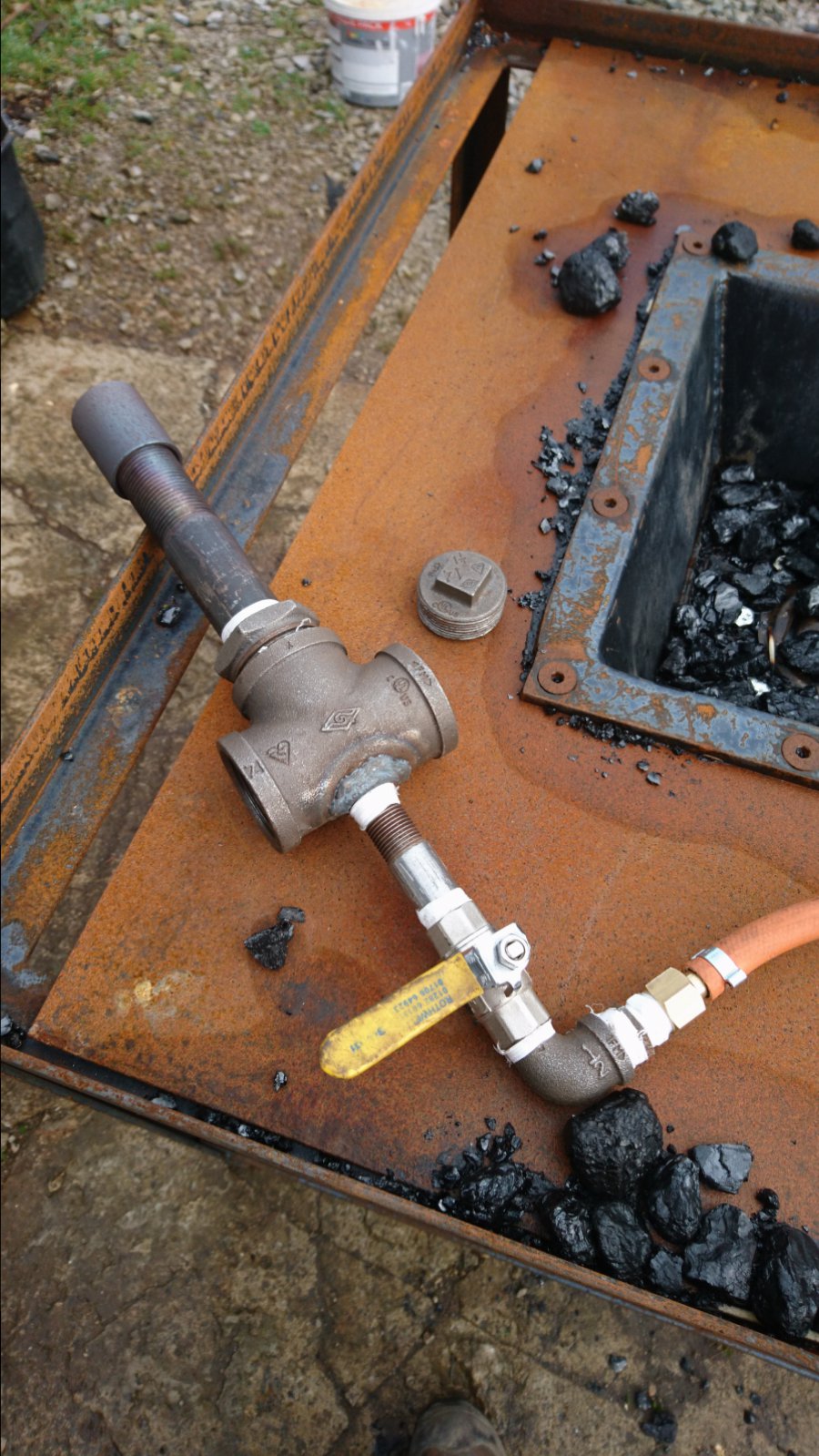

Runs real nice on propane run through a 1mm mig tip, takes a few minutes but can be putting ten in each heat. Much less faff than I thought it was going to be, biggest hassle was driving to skelmersdale for the brick and fire cement.
Recon it cost me less than £200 in all the stuff and maybe 10-12 hours.
