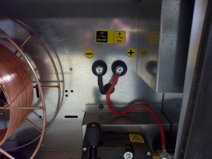

I borrowd a friends welder over the weekend for one of my sculpture workshops, so we could have two welders on the go, cant remember the make, but it is a 240 volt 180 amp welder that takes 15kg reels of wire. It has 'Gas/Gasless' on the side. it had a cyclinder of Argoshield on it.
Copmpared to my 180amp Butters welder it seemed very 'fierce in use, lots of spatter and was very noisy, not nice for novices.
I changed the torch to a new one and it made hardly any difference, so not the liner.
I wondered if it might be a polarity issue, dim memories from probably this forum about changed polarity for the two options. The gal who own it has of course lost the manual and never read it. Says 'Oh it always does that' and commented on how quiet my welder was in comparison.
Here is a photo of the inside.
The labels are to say the least a bit vague.
Is it wired up the right way round? presuming these are the leads that get changed.
