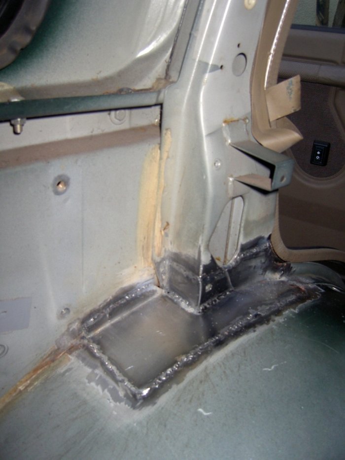

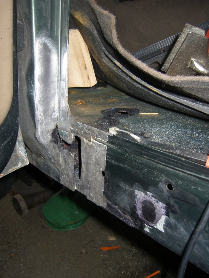

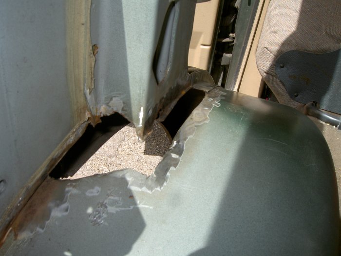

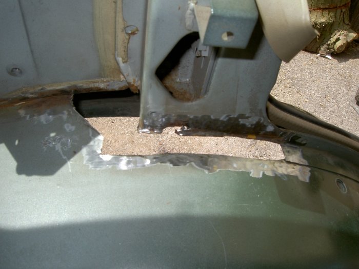

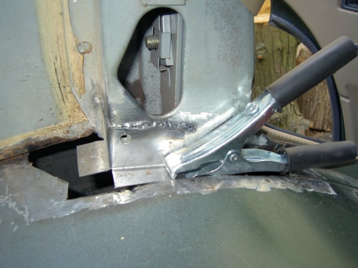

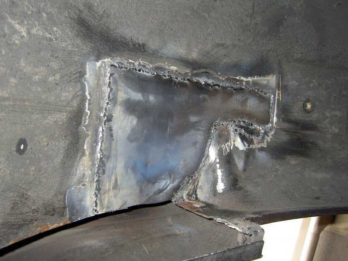

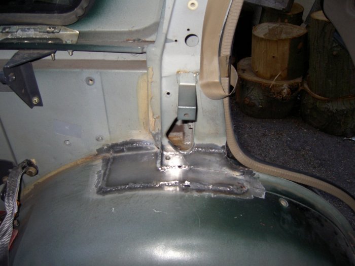

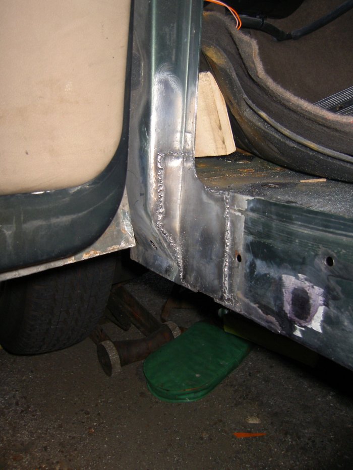

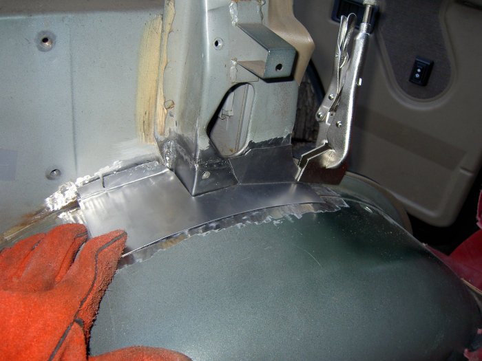

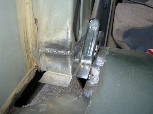

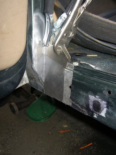

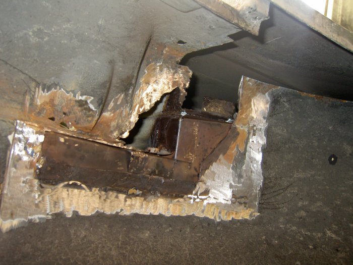

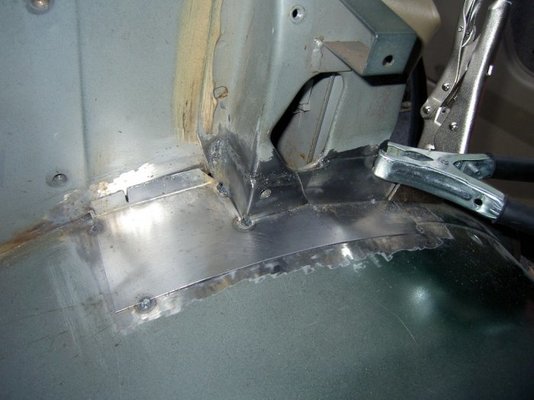

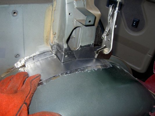

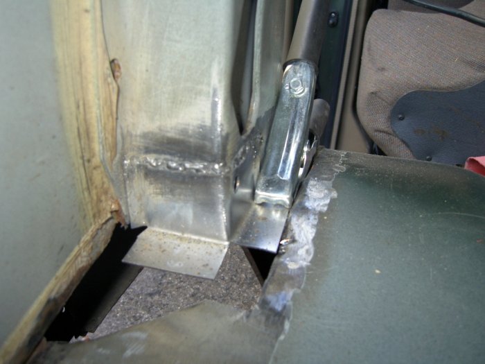

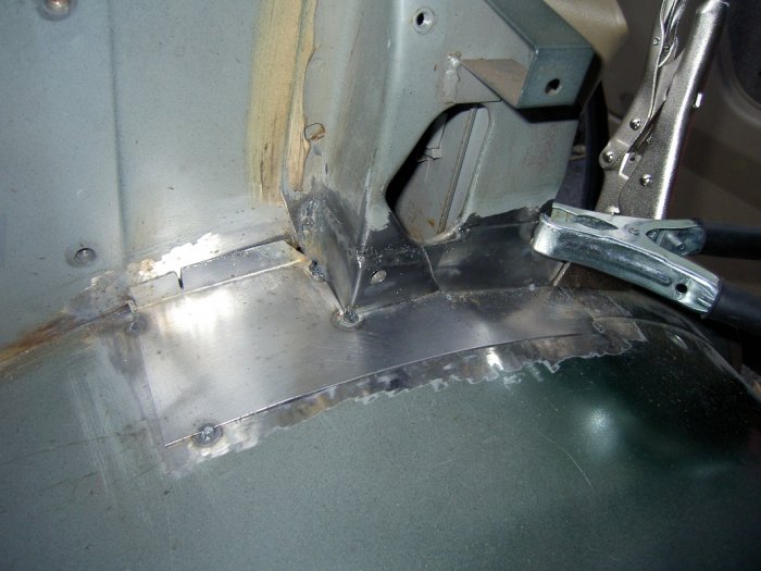

I've just bought a Clarke 105EN to weld up some key MOT failure points on my family LR Discovery. MOT's on Tuesday and I'm starting to get worried as we're going on a camping holiday on the 1st August all the way to Cornwall! So never having MIG welded before, just played with an arc welder laying beads, I've now jumped into the deep end and am trying to patch up the wheel arch near a seat belt mounting point, see pictures:
Happy to take criticism on how I patched it up as well, I'm assuming it could have been a many tabbed and folded single piece. What I struggled with most was just doing a simple lap weld. I practiced on scrap first, set lowest amps on the welder at about no. 3 speed but although I could manage a relatively uniform bead with penetration it wasn't thick enough to hold a lapped joint. Then I cranked up the power to no. 2 and the other switch stayed on min. and turned the speed up to 4. Bead wise it was much thicker and of course I had to move quickly to avoid blowing the metal but when I turned to trying lapped joints at this power/speed it was still a struggle.
I'm aiming for the base plate, just above the root of the join with the patch metal and find that I have to move pretty quick but even then the edge of the repair plate is frazzling and moving away from the bead. But if I turn it down I get back to skinny beads again. I got sick of messing about so just went for it but ended up with bird poo beads and a couple of big blown holes. It's structurally sound and I can fill the gaps with teeny tiny bits of metal (omg wot a ******'s muddle ) but I wanted any advice/tips if possible:
1. Am I aiming the arc at the right place, also I'm using a pushing forearm stroke?
2. Should I be jacking the speed up to 6 or something and really zip along to avoid blowing holes or will that compromise penetration?
3. I've got to patch underneath that repair as well God help me; any tips for overhead gassless MIG? I'm thinking, although it will take forever, I'll just weld 1cm at a time alternating different ends to reduce the chance of overheating the metal and blowing holes. That's assuming I can even do 1cm
I know the first bit of advice will be to get it converted to gas but I don't have time to mess about with bottles and in the long term I want to really get the hang of the gasless, so all you gasless experts;a cry for help.....tell me any good tips you have
