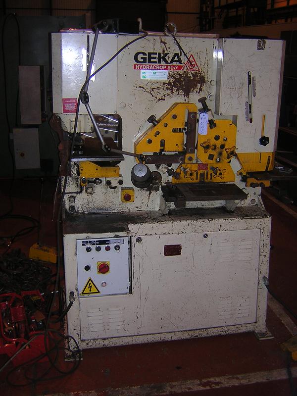

when Hitch punched some plates for me on his Geka
Getting the stripper only slightly larger than the punch, and keeping it nice and low helps minimises the bending, so does nice sharp punches/dies.
Our geka has a hydraulic stripper that comes down whilst punching. Doesnt help to keep stuff flat much though.
Did you try the 28 through 15mm Paul? pushing it a bit for a 50tonner id have thought!
Your probably aware Paul, tube notcher, press tooling, amongst the other allsorts that go in them.
Dont forget to take the keyways out
