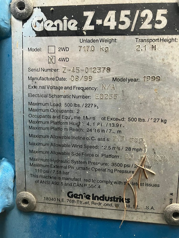

Thanks for the offer... I think it just needs a bit of TLC . Everything works at the bottom switches, just a couple of abnormalities when at the top... either a bust wire, a dodgy switch or someone has altered something
Went and had a look at this today. From the basket slewing the boom does not work unless you lean on the other joystick.. I had a furtle with a multimeter, and think I will be ordering some new microswitches for a start, they seem to be high resistance... forgot my switch cleaner today
The gaiters on the joysticks have split and the weather has been in there.. definitely needs another visit but more prepared
It is also very sluggish driving it till it has warmed up the oil.. not quite sure why, its got enough oil, it looks clean, and the filter has been changed
