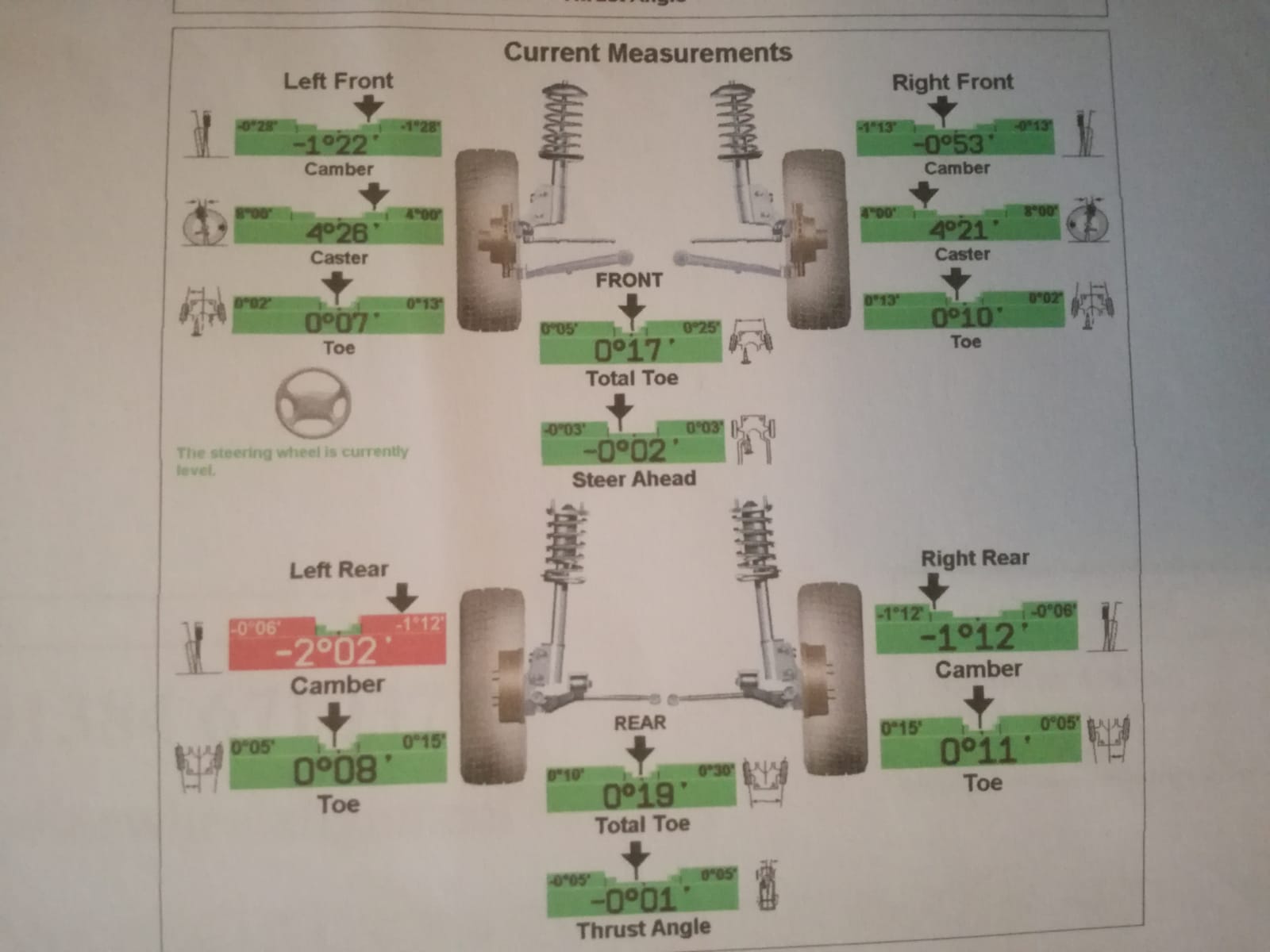

Working through some bits on my x308 jag, one being the alignment.
In order to get the left rear camber correct, shimms have to be placed between the halfshaft. (I need to see if someone has forgot to put back the factory shim first)
It is around 0.5mm for every 0.2 degrees, what size shim would i need to get it back in spec?
