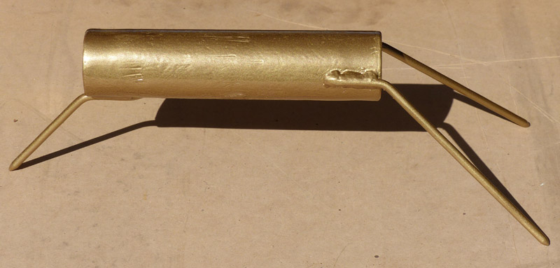

Quite a few times I wish I had a spare hand or finger to hold a small part down while I tacked it. I finally did something about it and made myself a Gold Finger.
I found a piece of 40 - 45mm water pipe about 250mm long, filled it full of old lead rolled up to give it some weight, blanked the ends off and welded a few bits of 6mm rod to it.
Trying to use up some old paint and found the gold.
On the paint can label it says ...... "Super Gold is not meant to be represented as having the same properties as real gold plate"
Well hello ............are they for real !
I was going to make a few of them and sell them for lots and lots of money until I read that !
